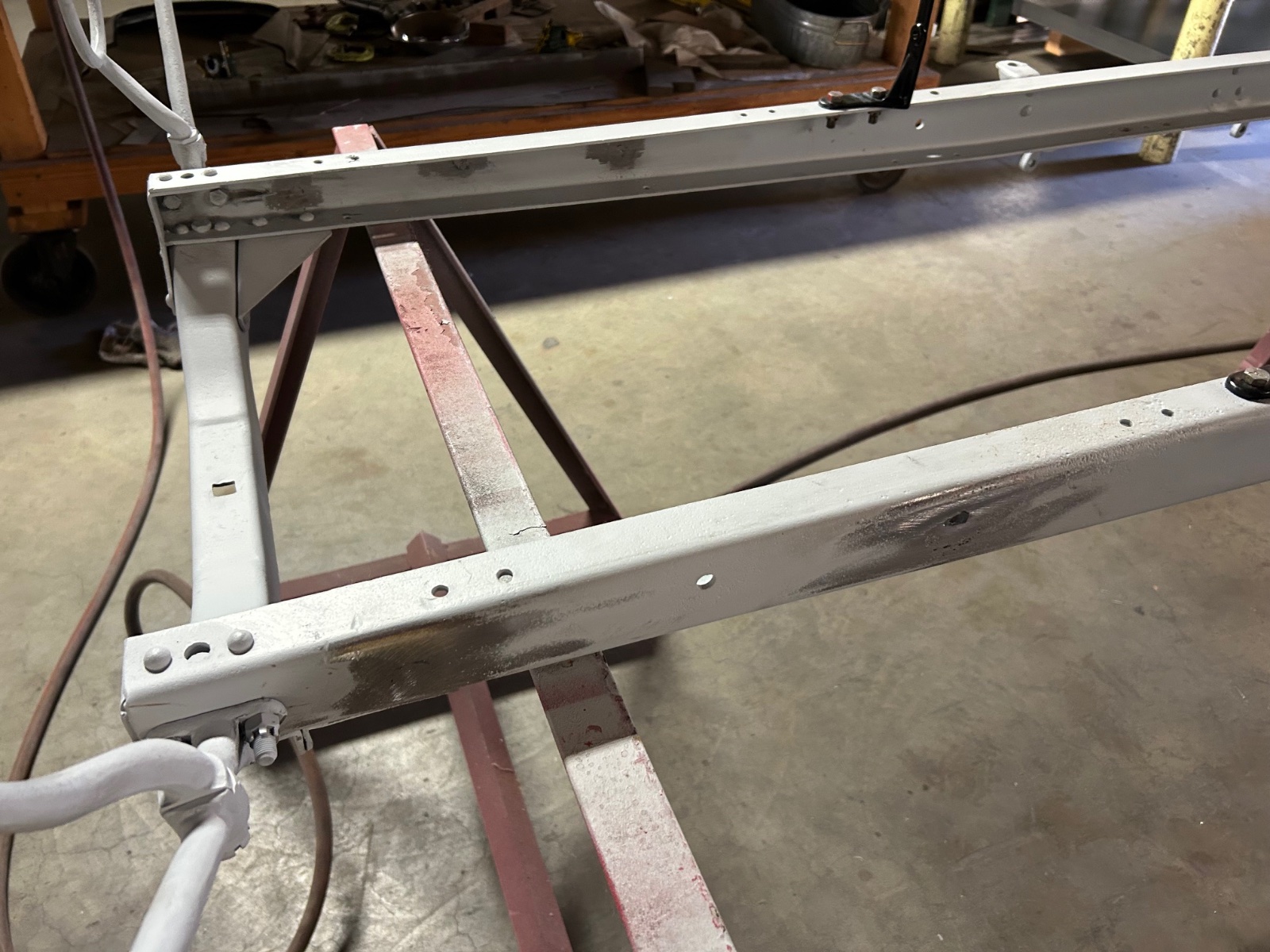

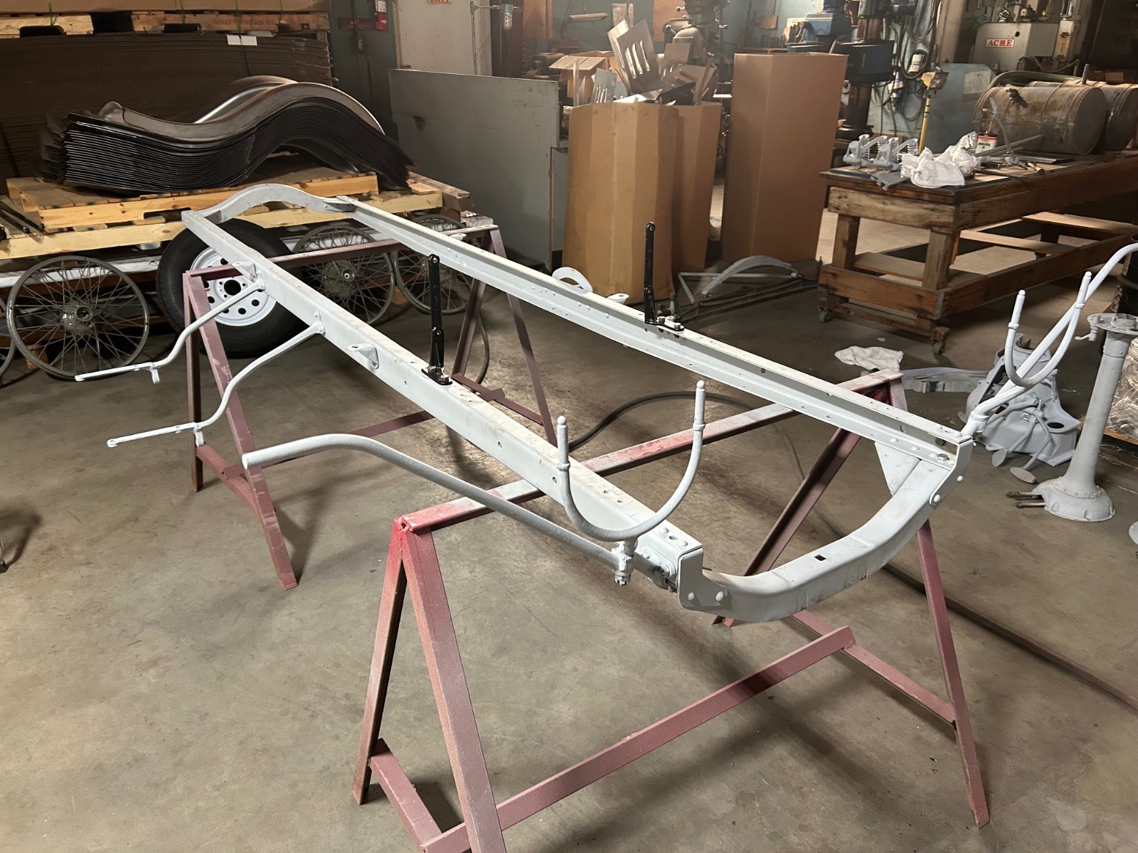

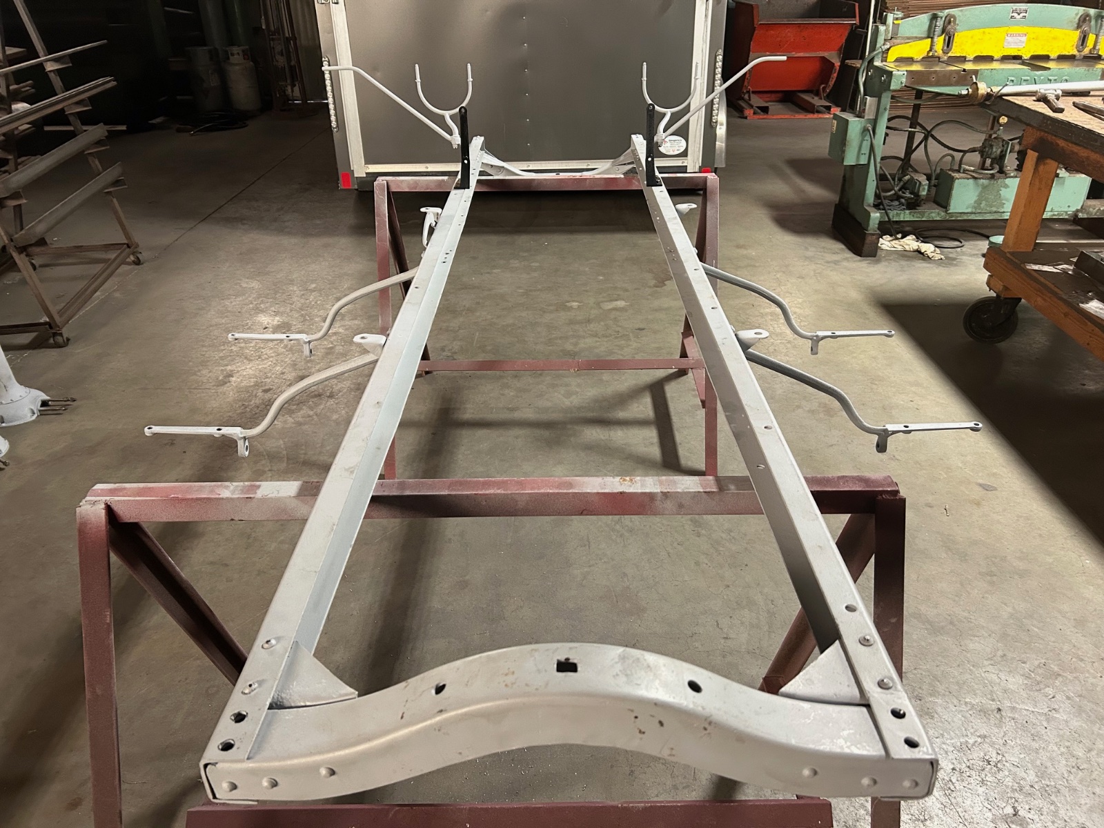

For the last 7-8 years I gathered parts in hope of building a Torpedo. So I thought it’s time to put the chassis together and we’ll think about a body later. So for now I brought what I have to the shop and started with riveting brackets to the frame, straightening and aligning said brackets and priming as I go.

Torpedo column with a loose gear case on top, so I reset the rivets and silver soldered the joint. Now to clean the mess off.

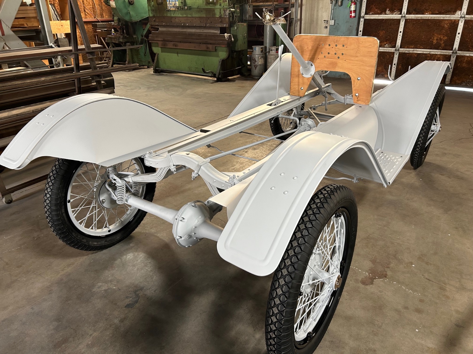

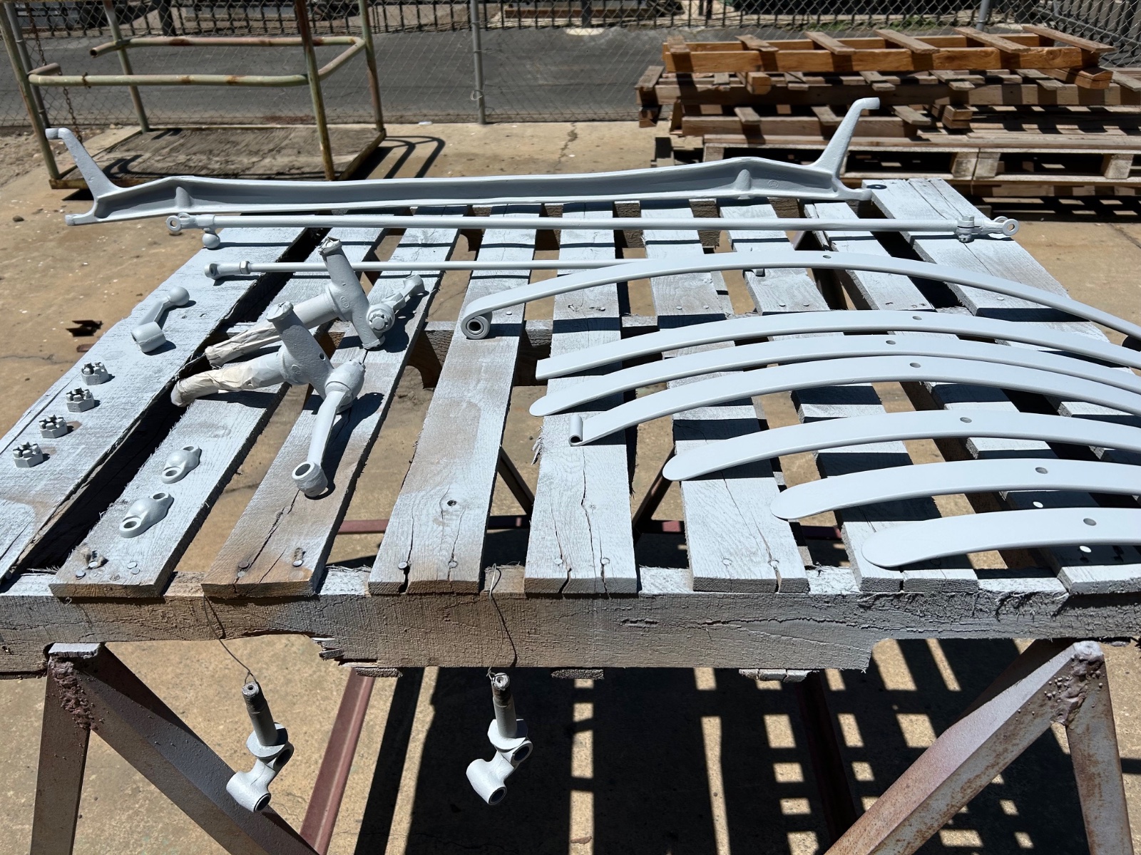

When I begin to gather parts I like to put together subassemblies to see if the parts fit, if there worn out and beyond repair and need replacing. If they are good I will sometimes rebuild pieces. Such is the case with the front end. I had it pretty much rebuilt but still rusty, so today I disassembled it.
Re: New project.
Posted: Sat Jul 26, 2025 9:03 pm
by Dollisdad

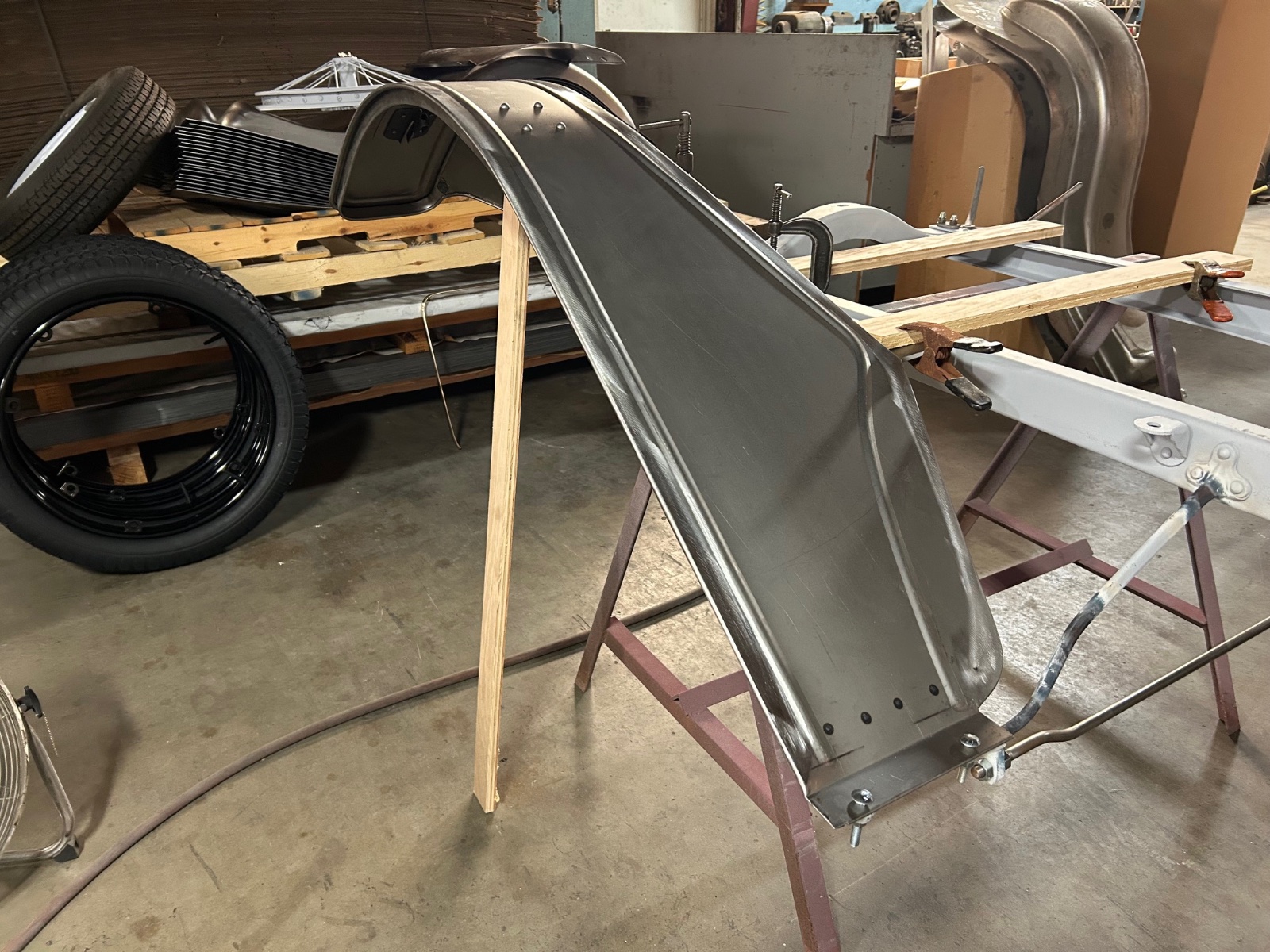

I used a new front spring and I didn’t care for the taper on the end of the leaves, so I reshaped and cleaned up the edges. Then took all the pieces to the sandblaster and then shot the parts with a sealer to keep them from rusting.
Re: New project.
Posted: Sat Jul 26, 2025 9:08 pm
by Dollisdad

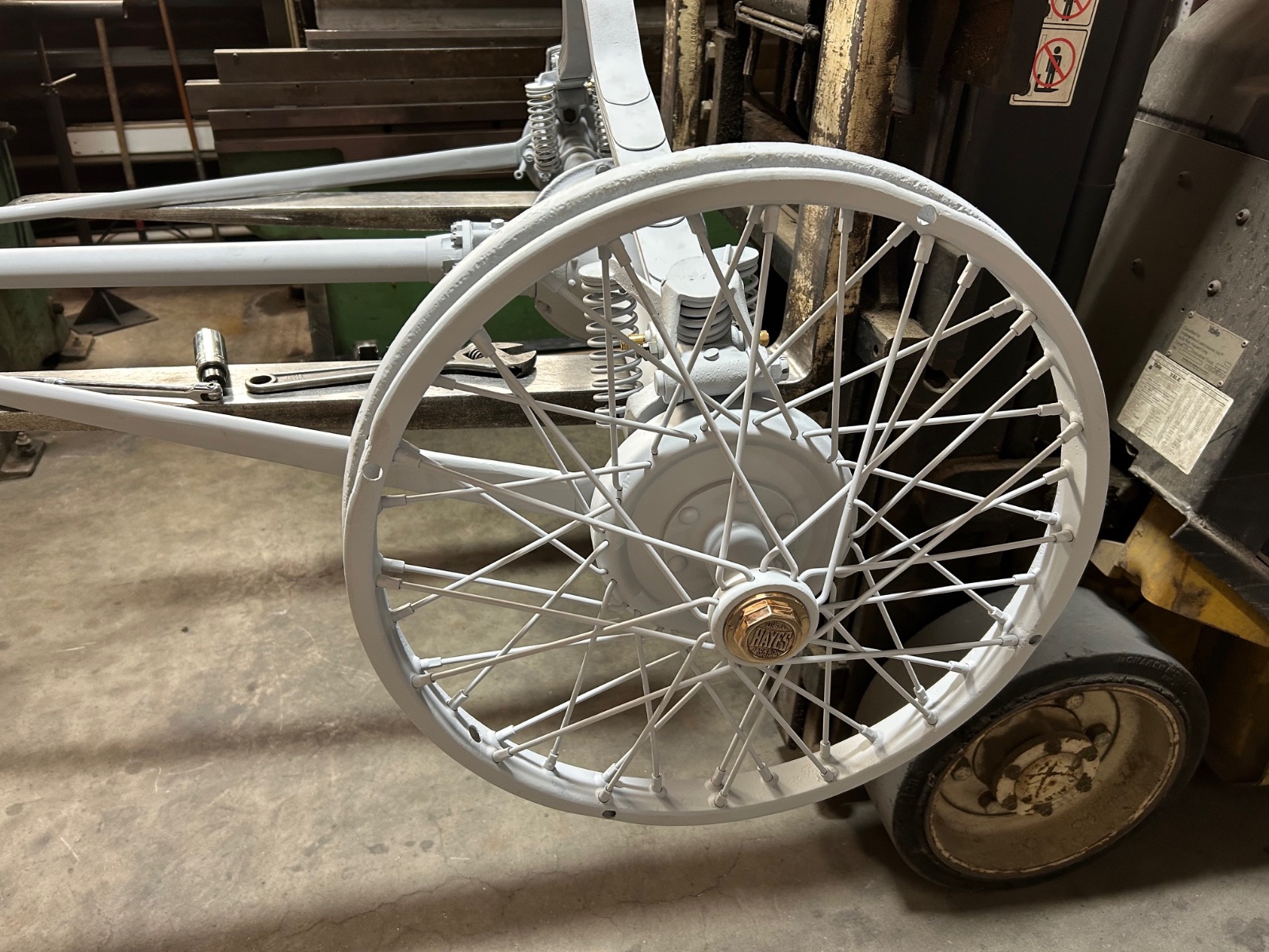

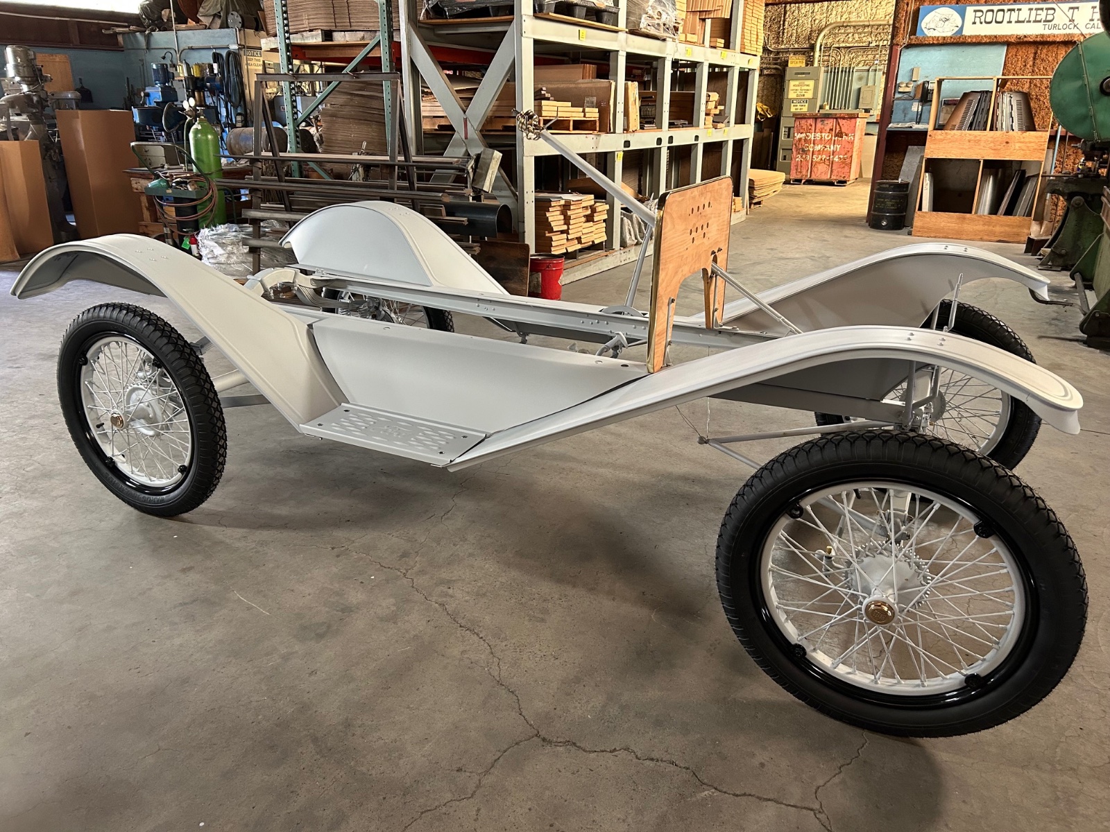

Then reassemble the front end. Dry, no grease. It will come all apart for paint later and that’s when I will nit pick the finish on all the parts.

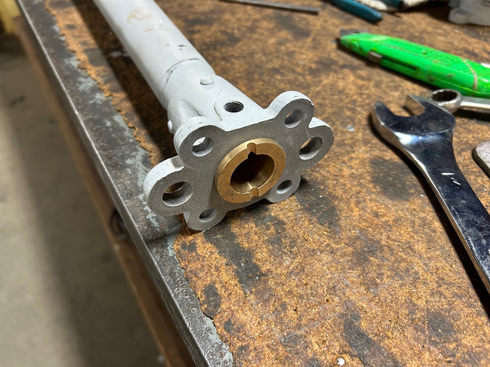

Posted: Wed Jul 30, 2025 5:51 pm
by Dollisdad

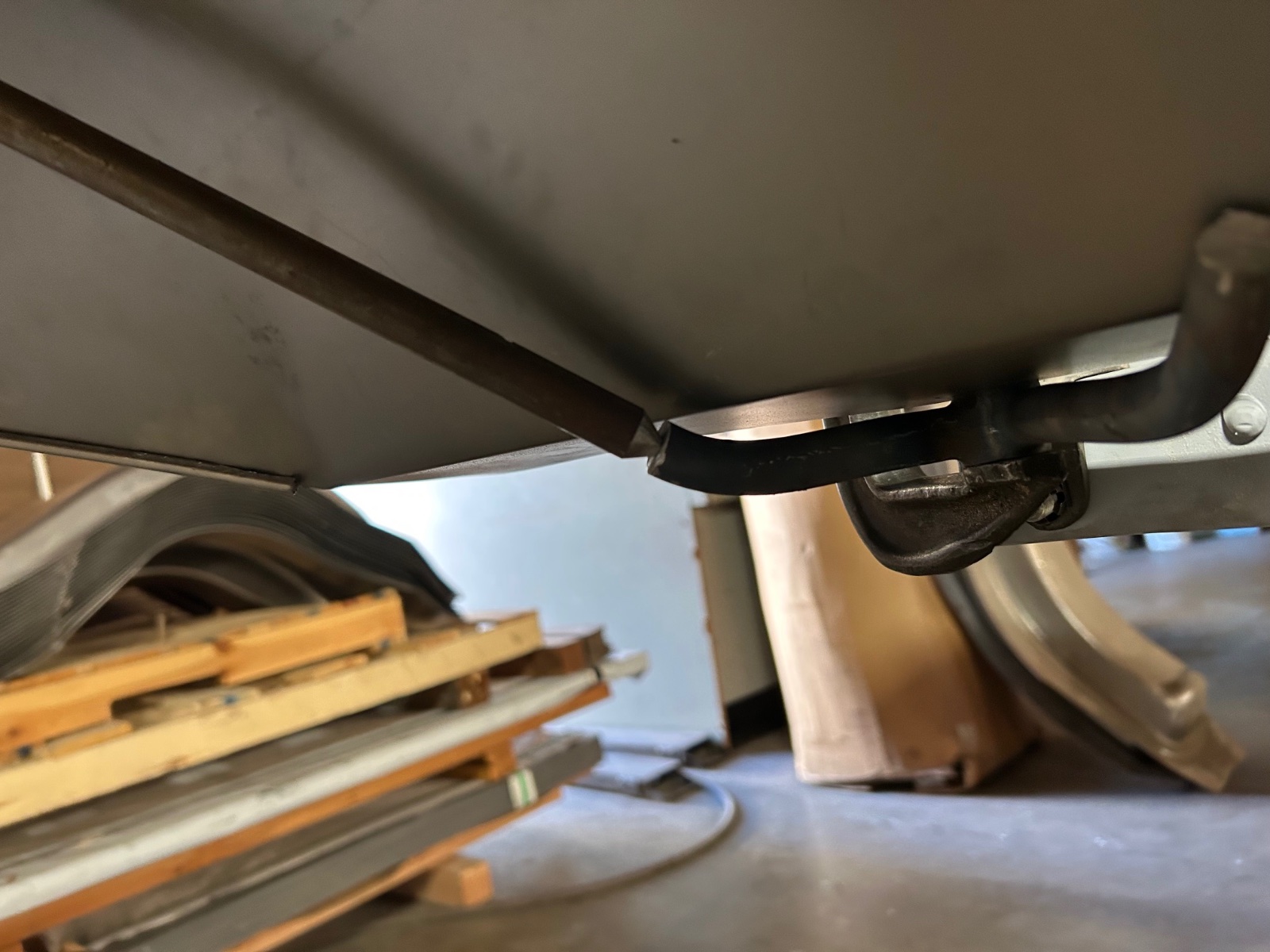

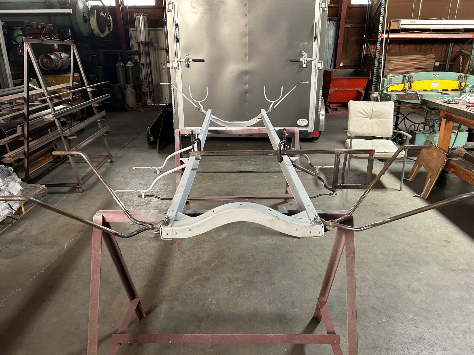

Put in new D/S collar bushing, while waiting for other parts.
Made new brake release rod after straightening hand brake lever.

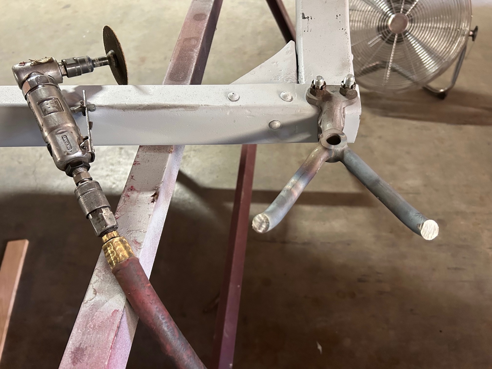

I think the frame was a farm trailer at some point. I welded up holes that shouldn’t be there.
