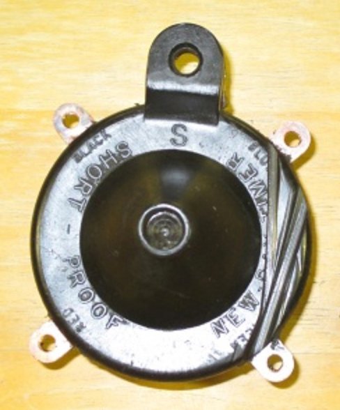

I'm curious about the history of infamous 's' branded New Days. When were those around? Were they made by the same outfit as today, just using a better recipe for the plastic?
Re: New Day timer brush question
Posted: Sat Aug 09, 2025 12:36 pm
by Oldav8tor
"S" caps were sold by Snyders, before my time. That said, they still turn up on cars and at swap meets. They are made of a softer plastic and stand a little taller than they should. I've seen a couple with grooves cut into them by a fan belt as a result. The interior surfaces of the cap wear quickly leaving "bumps" where the contacts are that accelerate wear on the brushes as well. They can be identified by the "S" visible below the hole. They were not made by the folks from Tip Top timers. The "good" caps are made of a bakelite-like material. Hard and rigid. While we're at it, if you're at a swap meet and want to know if you're looking at an original cap, the little holes in the contacts of an original cap are square (second photo.) I've run an original cap on my car for a few thousand miles and compared it to a Tip-Top. The Tip-Top holds up as well as an original....maybe slightly better.
For what it's worth, one of the worst reproductions of a New Day is the "Best" - it really wears quickly. See how the plastic has been scraped out between the contacts. The debris piled up on the bottom edge is plastic. (Photo three)
From my comments you may think I'm a New Day nerd. Truth is, one came with my car and I've seen no reason to change. I collected the information I'm sharing from a "Shop Talk" I gave at the Piquette Ford Factory Museum in Detroit last year.

by Eric Sole
Tim, you posted “For what it's worth, one of the worst reproductions of a New Day is the "Best" - it really wears quickly. See how the plastic has been scraped out between the contacts. The debris piled up on the bottom edge is plastic.”
I assume you are referring to the marking on the original Snyder’s packaging:
I bought this New Day timer from Snyder’s in 2005 and drove 500 miles with no troubles until the transmission broke and the car was laid up for years during the repairs/restoration.
These are pics of that timer and brush as removed from the car:
My timer shows no appreciable wear after just 500 miles, but after reading about how the “S” marked units were prone to failure, I bought a TW timer, which is working fine.

Posted: Sat Aug 09, 2025 3:43 pm
by Oldav8tor
Eric,
Snyders may have sold the "Best" but I don't think they made it. I will admit some ignorance of it's history.
If you look at the picture of your "S" cap you can see the beginnings of plastic being pushed up over the contacts and on the face of the brush. Look back at my picture of a Tip-Top with 5400 miles on it. The contact margins are clean.
Below is a picture of a "S" cap showing more plastic migration.
I've also included a photo of an original and "S" cap viewed from the side. See what I mean about the "S" being taller?
Posted: Sat Aug 09, 2025 4:15 pm
by Eric Sole
Tim, you are the New Day timer expert in my book.
I now see the beginnings of the plastic being displaced on my timer, and that on a unit with so few miles on it! Makes me glad I popped for the TW timer.
I appreciate your observations and sharing your experience.

According to Tony (RIP) I was the "second buyer" from him when I realized what this timer would be like. I'll attach a pic of the TW on my '13 that has OVER 17K miles on it, and 3 brushes...the left one had 4K miles, middle 2K, and right one is new for comparison. I could run the left one even further.
WELL TUNED coils and proper timing are KEY also! But this timer design is just close to flawless. I tried a ND (not the "S" version) on my Fordor and it lasted barely 500 miles with requiring two "tear aparts" to keep it running. All I have to do with the TW is clean it every oil change, sometimes every other change. I will always run it! Nuff babbling. You get my point! :lol:

Sadly no. I have done what I can having a run of the 2 brush styles to help keep those of us with this
great timer going. I pass on the cost with no profit, usually lose a wee bit in the shipping from shop to me but no big deal. I had a dozen custom made brush holders (rotors) made for the round style, I have 2 left. I have tinkered
with using the "ordinary" roller timer with good success as far as the wear on the internal ring. I believe it's a wee bit softer
than what Tony used, I think he used Micarta. I even have a sheet of Micarta in which to make up to 9 rings, just haven't found
a good fast source to get em cut out via CNC. Then I can re-vamp the roller timer with these. Just takes lots of time.
Again, and with all timers, keeping the coils in top condition is paramount.

My engine is still in break-in stage, so running is constantly improving. I just cleaned the dust out of my TW timer, and I could swear the idle is smoother now.
Here is the timer cleaned up:
As you can see, the brush has been running right at the forward edge of the timer. I removed 1mm from the back of the brush holder so it is closer to the engine now and while it is not completely centered on the segments, it is now more centered.
Don't know how important it is to have the brush completely centered on the segments?

I have no idea either re having the brush centered completely on the segments but lets face it, it can't hurt. Was a good idea to shave the brush holder down a bit. Some seem to need it, others don't. Critical to long brush wear is definitely a well tuned set of coils.
And yes, it no doubt runs a bit smoother after cleaning, I've seldom noticed it "telling me" it's time to clean it, I just clean it at every oil change, in fact I'm going to do that to mine this morning as I changed the oil the other day and didn't have time. It's still been running smooth as silk....as always.

A coil or coils that are out of adjustment and drawing excess current will dramatically shorten the life of any timer. Bad coils can wreck a timer in a very short time.

FWIW...as mentioned above..I cleaned the TW timer on my '13..usual carbon dust...no wear on the 4 metal contacts nor the micarta ring. Over 18K miles on this timer and for comparison here's a new brush next to current brush installed new this spring with already 1932 miles on it. I always get over 4K miles on a brush with plenty room to spare. I can even mount the timer on the block without the little wire that Tony (RIP) designed after a few originals were out there. Its easy with a little practice.
