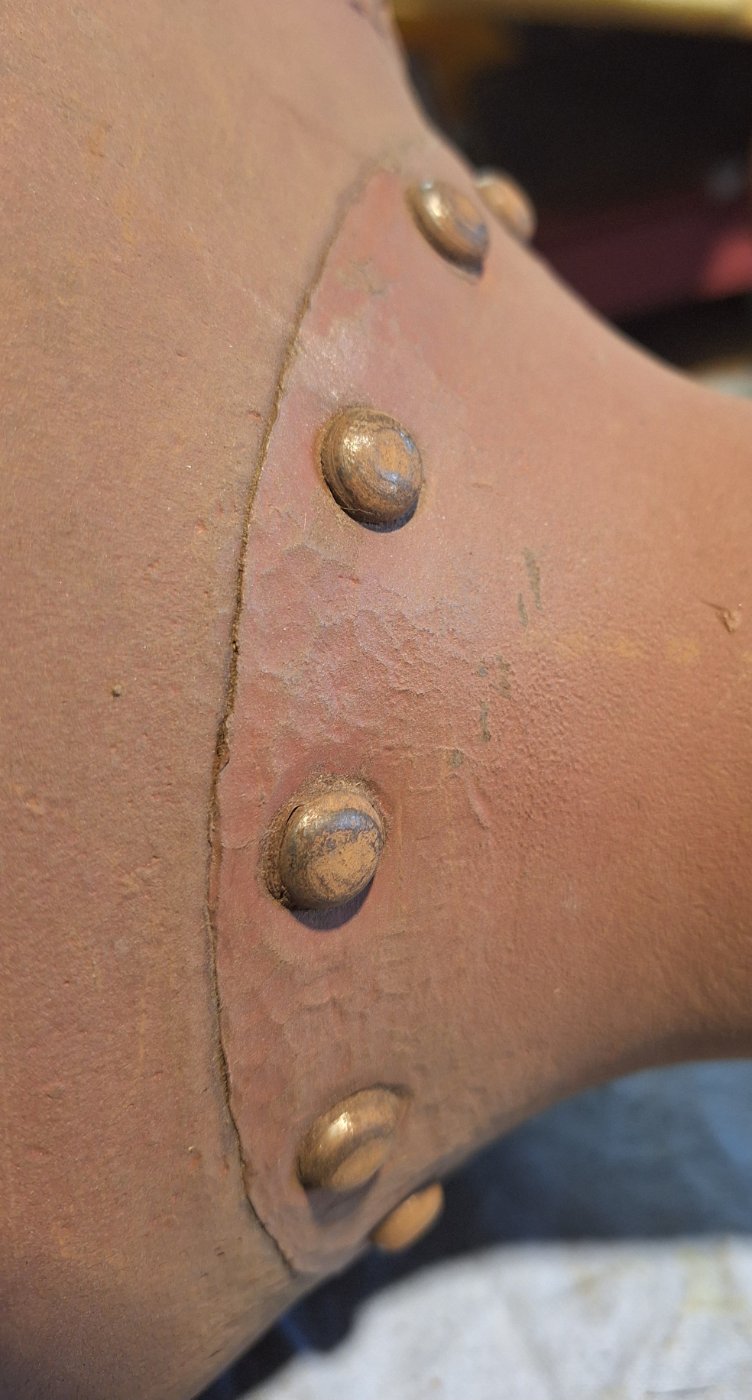

After driving my ‘14 Touring 100+ miles this summer, she appears to have developed a new leak. When I added the small drum ruxtell a few years back, I swapped out the right hand axle housing with the original 12 rivet one, just to keep the “correct” look. But over the last few weeks in my shop…
The leak
The leak
The source?
The source?
So, how does one seal this up more effectively?
If I have to disassemble the rear end to get to a bare axle housing to effect the repair, am I better off putting the 6 rivet right housing back on the ruxtell for durability and re-building the 12 rivet axle as original to sell with the car? The ‘14 has been surprisingly original and my plans are to return it as closely as possible.

It's probably loose rivets or a crack around the rivet area. I'd clean the axle housing up and drive the car a couple of miles and then look for evidence of exactly where the leak is. I'd check for any indication of the axle being overfilled with lube.

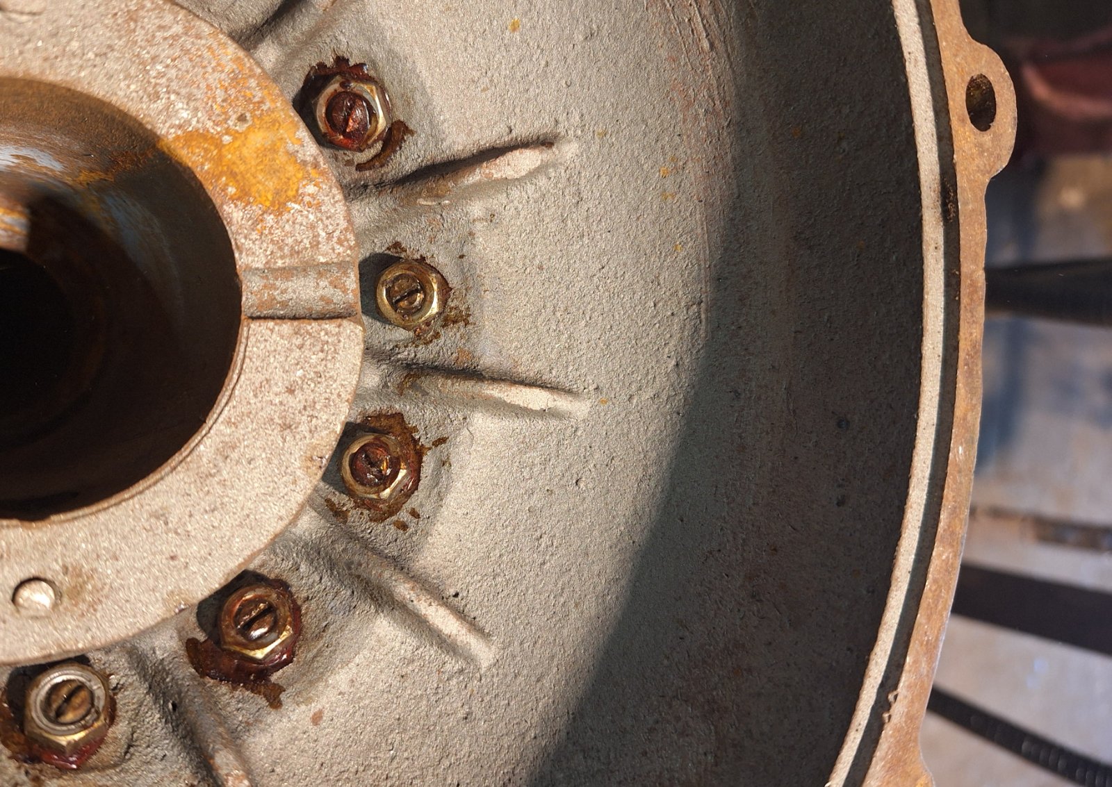

by RajoRacer
I went through this scenario in my '14 Touring years ago - complete disassembly, drilled out all the rivets to separate the pieces, hot tanked (was still available years ago), can't recall what I used for a sealer but sealed it with some goop, used button head bolts for reassembly, Loktite the threads then filled the Allen wrench hole with black silicone, dressed down while semi-set & been dry for many years !

If the rivets are loose, it would be necessary to take the housing off the axle and clean everything up and re-set the rivets. It would probably be best to use slightly oversize rivets. If the joint is at all loose, it will get looser as the car is driven. Putting goop on the outside of the axle is unlikely to do much good.

by Allan
The rusty stain is an indicator that the axle tube is loose and "working" on the centre casting. It needs re-riveting.
I have done a few, with complete success.
The two components need to be separated first. A hot tank clean out is the next essential step. Bot parts need to be completely clean, grease free, and dry for reassembly. I use grade 5 3/4" long x 1/4" diameter fine thread hex bolts to make rivet look-likes. The heads are machined to copy the rivet heads. The end of the thread has a hacksaw cut made across it to take a flat blade screwdriver.
When assembling the two components I use Loktite 515 flange sealant liberally on the two mating surfaces. This product stays flexible, so there are no cracks or leaks. The modified bolts are fitted and the nuts run up finger tight. Then you can use a wrench to draw them up tight. Thar's where the screwdriver comes in, holding the bolts as they are tightening. As a safety measure the screwdriver slots can be spread to stop the nuts ever coming off
The rear axle in my chocolate van was done this way some 30 years ago. It has been out once to replace a split pinion gear. I had no reason to do anything about the housings at the time. It is still leak free some 26000 km later.

Great work with the bolt based “rivets”. I do believe that the axle tube will need to be separated from the pumpkin casting to get a decent seal. I guess that before rebuilding the original axle, I’ll disassemble, clean, and bolt-rivet the both axle housings to reduce the chance of future leaks.
So the first step will be to pull the Ruckstell and swap in a 6 rivet right axle housing to get the car drivable again. Then take my time on the original ‘14 axle rebuild, keeping the small drums on both axle assemblies so that the AC brakes can stay with the car.
