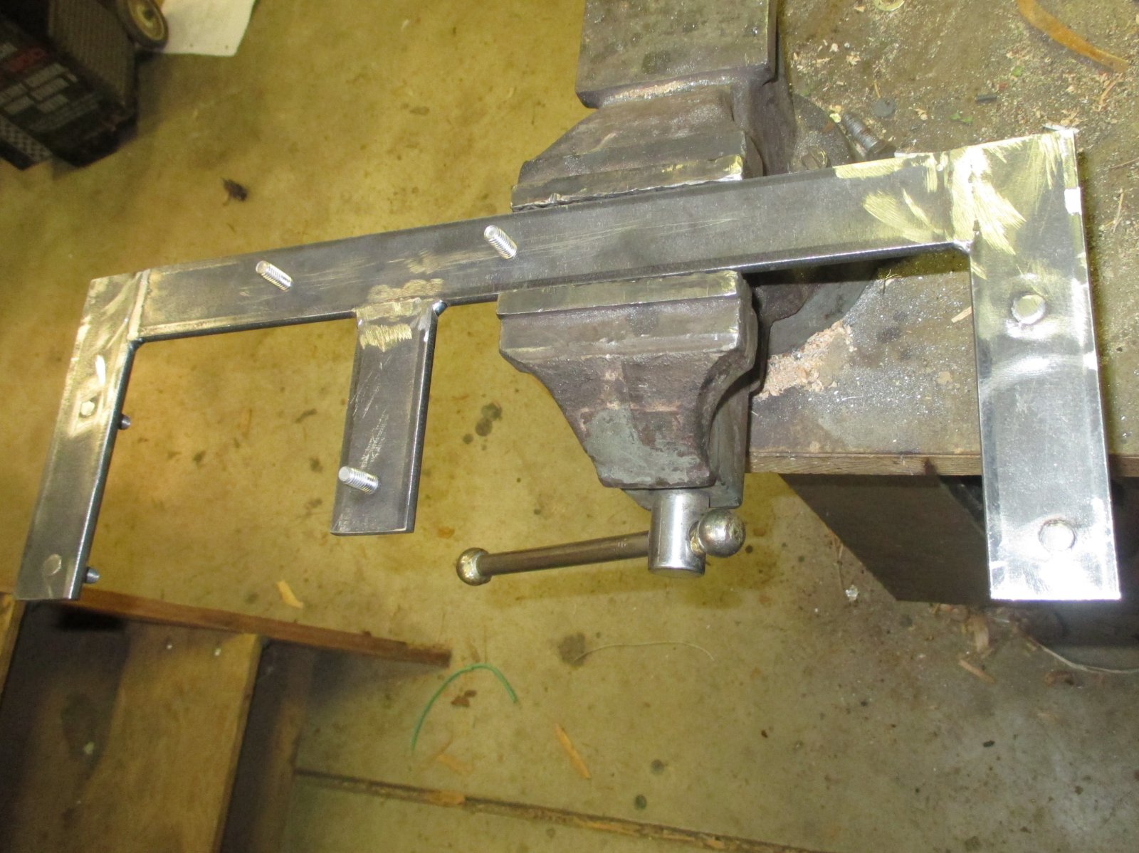

Before I understood the safety aspects of acetylene lighting, I used an MC tank mounted at an angle under the rear floorboards based upon information that Val provided. I even wrote an article on how I mounted everything that was published in the HCCA Gazette. One night I was on a fairly long drive and when I got home I could smell an odd odor. I presume it was the acetone.
After more research...
I created a Prest-O-Lite mounting bracket adapter plate that uses the existing acetylene generator bracket mounting holes in the running board.
DRILL NO HOLES!
I call the adapter an E-dapter, because is is shaped like the letter E.
Four studs are welded on the bracket pointing up for mounting the prest-O-Lite tank brackets.
Three studs are welded on the bracket pointing down to mount through the existing acetylene generator mounting holes on the running board.
I put rubber grommets on the mounting studs and little rubber bumpers at the ends between the bracket and the running board so everything is secure.
The Prest-O-Lite decal is the finishing touch.
Keith

Thank you for posting that E bracket.
Original running boards in US are punched from June '12 through
about March 1915. Not sure about Walkerville, Ont. No need to
drill holes for the E bracket.
I have this bracket set; the other common type POL tank mount.
Ken

by Russ T Fender
On my ‘12 T I did what you did Keith but mounted it under the running board so I could keep the generator in place. Made up a bracket that used existing holes in the running board. I was a bit concerned about ground clearance but it’s been that way for a long time with no issues.
