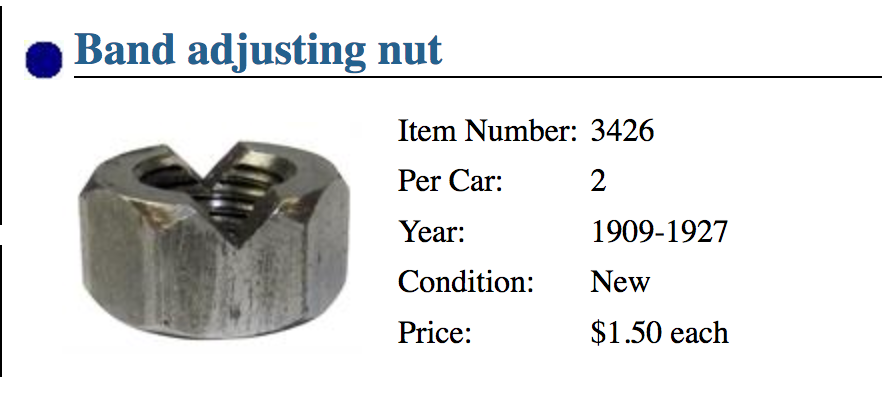

The band nut has 2 V detents. The Special washer has a raised bump to hold itself in the nut to maintain the adjustment. That washer has a raised tab that fits into a slot cut into the shaft. (probably on the underside you cant see)
The correct washer can be on backwards & not lock. The detent in the washer can be worn flat enough to no longer lock. It can be re-formed with a dull chisel.

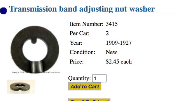

The brake pedal shaft should have a special washer that keys to the slot in the shaft and has a dimple for the detent in the special nut. Together they hold the adjustment.
Parts at Lang's are
Washer https://www.modeltford.com/item/3415.aspx
Nut https://www.modeltford.com/item/3426.aspx
Parts at Lang's are

The proper adjusting nut #3426 (09-27) has a groove across its face. The proper washer #3415 has a raised spot that keeps the nut from turning. Wrench #1917 is the official tool for this, but there's a ratchet version that's less tiresome.

The correct nut and washer as shown in the parts supplier pictures is a must for the correct brake adjustment, action and service for a Model T band adjustment!
Someone just put a nut on yours and dismissed it as OK. Might be a good idea to replace the three springs that are also used on the pedal shafts also. The notches and indents on the washers are put there for a reason.
