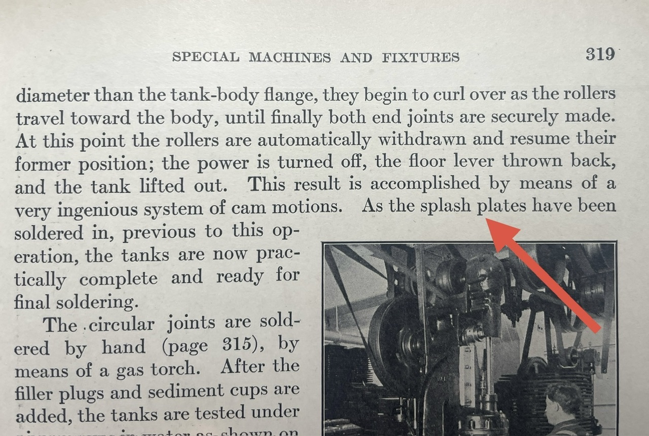

Suspect that nail head blob is from the soldering done on the tank seams. The tanks were formed with galvanized sheet metal, rolled and seams rolled on the end caps.
That blob might be result of this operator, looks crosseyed to me. ;)
And, yes, splash baffles are soldered in the tanks prior to end caps.
Pics from Ford Methods and the Ford Shops1913-14

by big2bird
Soldered in these two beads.
