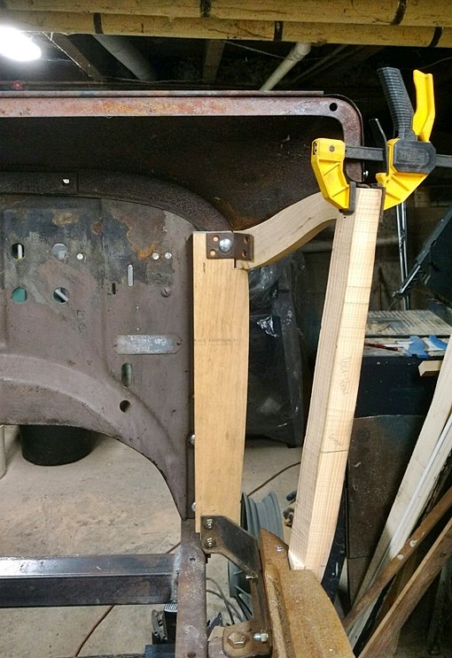

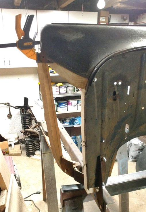

I'm rewooding my '24 cut off touring currently. Anyone who "thinks" it will be easy is fooling themselves. And while I am not a cabinet maker by any means, I am a pretty good, above average fabricator, and it is a daunting task. I own band saw, table saw, routers, so its not like I don't have the tools to do the job. A good Model T buddy summed it up good the other day "There is not a straight piece of wood on a Model T". Alot of truth to that.
I have cutup more scrap Ash than I care to talk about. I have "most" of the original wood...which is what I am trying to use as patterns. I also have a set of Leon's - Mel Miller plans he was offering copies of. Sad to hear he is not any longer. But my original pieces do not fully agree with the plans either, so I am walking the grey area in between to come up with a shape of the missing sections of my wood.
In 4 days of work, this is all I managed to get done...the new sills were gifted to me by a generous member who used his originals and the rest of the wood kit he bought. And he said even with a kit he walked away from the project several times..
