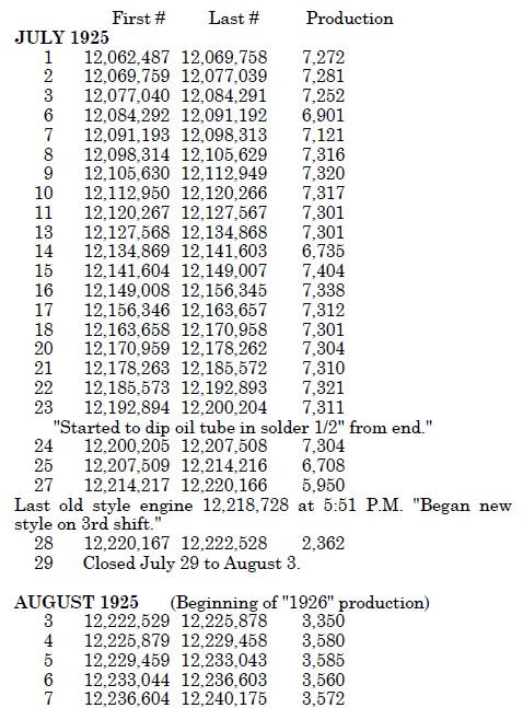

The 25 fordor i'm looking at has a 25 style rear axle with a Ruckstell and the engine number is that of a 25, but it has wide 26-27 pedals. when exactly in production did they phase in the wide pedals? they aren't slip on pedal accessories, they definitely are part of the pedal stalk. and the engine displays all the characteristics of a 25. if you can't make out the number on the block it's 12372515

With the bolted trans. cover to the block indicates a late '25 & would have the wide brake drum & associated wide pedals.
