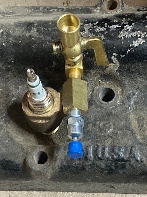

by Craig Leach
Free starts require T coils & fuel in the cylinder that sparks. Sometimes cranking to achieve the correct piston to spark timing. I have dabbled
with the idea of setting up a system for making it easier to accomplish this ( purchased the parts) but time has not been allocated to complete
& test. Using explosion whistle adaptors, very long reach spark plugs, primer cups & resetting compression releases so the cylinders can be
primed & the engine can be turned with much less effort. This may be a waste of time & effort but would like some feedback from those with
more experience as to the viability of this venture. I have worked on autos that use a similar system such as Packard. This could be a solution to starting non starter cars for those of us that have been fortunate to be here longer than our ability spin a crank handle.
