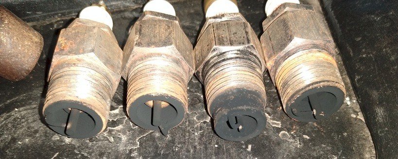

I planned on doing a compression test and pulled the plugs:
I found carbon fouled plugs, gapped to .025"
The Manual says 30/1000" or 1/32" (.03125")
Champion X says .025"
Somehow the lean-rich mixture was set to 6 turns open.

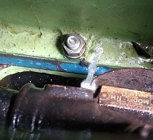

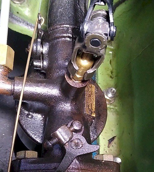

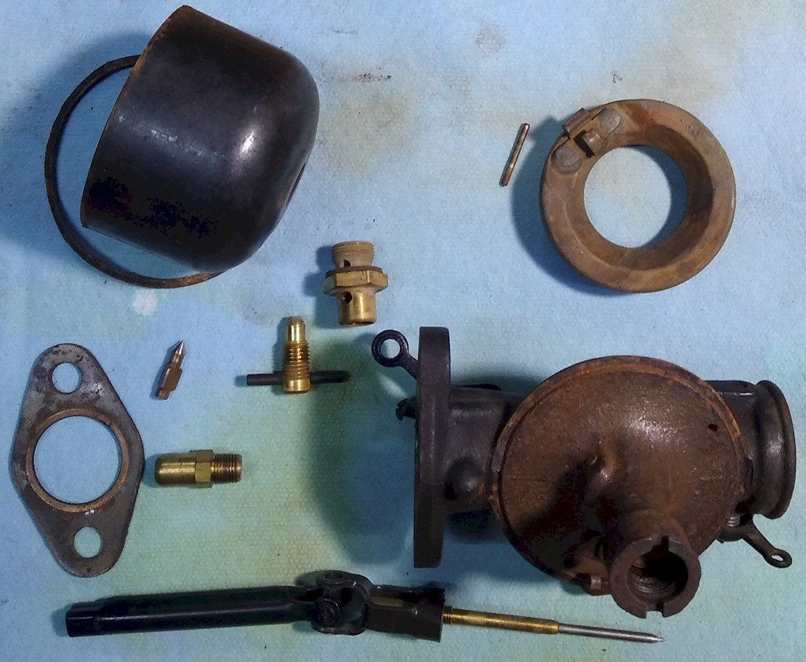

Never saw evidence of a vaporizer. It came with this Kingston L4. I thought the tag on the back side said "NH" so I purchased a replacement Holly NH and replaced the parts in it some years ago. Yes, the air/fuel needle on top. OK will open to 1-1/8 to 1-1/2 turns instead.
Also, it idles great, runs on battery, runs better on Magneto. Starts by starter or hand crank.

A plug gap of .026 to .032 is fine. A smaller gap may give easier starting with a weak magneto. Your plugs show that the engine is running WAY TOO RICH and the plugs are heavily soot-fouled. Clean the plugs thoroughly and set the gaps to .028. Make sure the float level in the carburetor is correct, then seat the adjustment needle gently, and then open it one full turn. Start the engine, set the throttle for about 600 RPM and advance the timing about halfway. Drive away. After a two to 3 minutes, adjust the carburetor about 1/8 to 1/4 turn leaner. Advance the timing as the situation demands. Under most conditions, you should be able to shift to high at 6 to 8 MPH, and stay in high from then on unless you have to stop. The car will not lurch or buck when shifted to high if it is running as it should and the shift is handled as it should be.

Compression is OK. Fouled plugs will mis-fire under load. Cleaning them and gapping them should cure that. If the engine still runs irregularly under load, I'd check the timer and related wiring. It's not uncommon for the wiring at the timer to wear against the timer rod or the fan belt. Also be sure the choke is opening as it should.

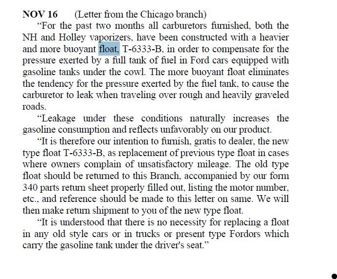

Your float is not applying sufficient pressure to close the float valve. There may be dirt in the float valve keeping it open, the float may be binding on the side of the bowl or the tab on the float may not be shaped well enough to lift the float valve's needle high enough to shut off the fuel flow.
You don't have "extra pressure" in the cowl tank, but you do have "sufficient pressure", and it isn't enough to overwhelm a carb if the carb is clean and working properly

Improved T NH carbs had a larger than normal float to work with the extra head pressure.
Maybe a contributing factor, although a lot of improved T's out there are running satisfactorily with the earlier float.
Posts: 6789
Re: Factory *spark gap* Low vs. High head
Post by Scott_Conger » Sun Sep 28, 2025 11:11 am
the larger float came about to solve rich running on rough roads. I think our driving environments are such that the smaller float suffices fine in most circumstances. Most people don't know/care/need the thicker float, but when it is needed, it is needed. I suspect that the Oregon folks who do a lot of off-roading in "T"s either have, or could use the extra large float, for instance.
Additionally, the improperly designed float valves sold by most vendors have such a tiny through-hole that this naturally reduces the effective head pressure gained by cowl mounted tanks and thereby naturally reduces the need for the extra buoyancy the larger float gives. This is primarily why most folks with Improved Fords don't see a need for the thicker floats...they are already suffering from restricted fuel flow in the first place.
Edit: attachment added -

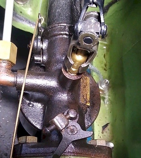

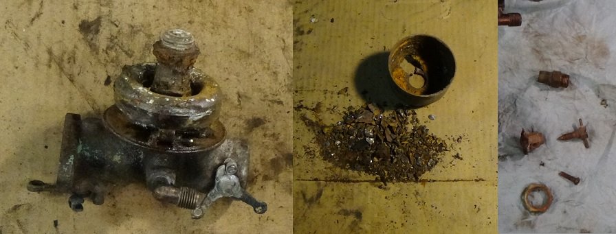

Before I take anything apart, I allowed the carburetor to dry and then ran two short videos while I opened the sediment valve. Here is before and after photos:
fuelish 01.jpg (91.08 KiB) Viewed 2117 times
fuelish 02.jpg (83.88 KiB) Viewed 2117 times
fuelish 03.jpg (54.71 KiB) Viewed 2117 times
Vern (Vieux Carre)

What I found tonight:
Cleaned out the sediment bowl - found a little debris.
Cleaned out the carb bowl - found a little debris.
Does not have the larger T-6333-B.
Float needle seems to be almost buried above the surface.
Tang on float was not making contact with needle anymore.
Vern (Vieux Carre)

In case someone missed it, the carburetor has a "NH" tag on it yet there is what appears to be a "G" steel needle. I checked my email receipts from years ago and packing lists. All I see if stuff purchased for "NH" but I don't even see that part number listed in my records anywhere. So, I think it must have come with the Holly, and that is why it was sold to begin with. Maybe I'm wrong, that this is the correct part but I certainly knew next to nothing back then. Anyway, I ordered the 6210 and 6212 this morning, and gaskets.
