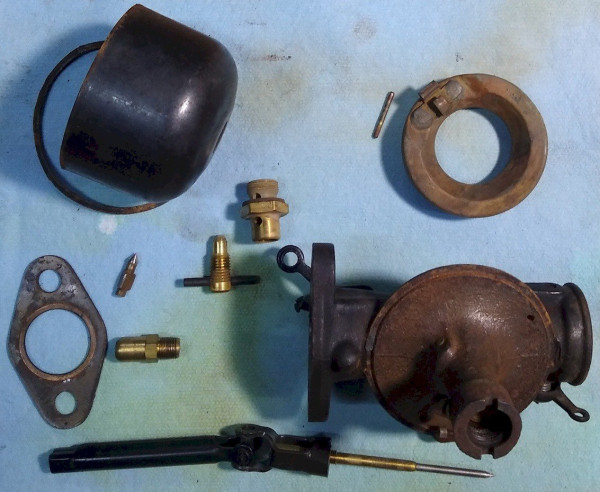

Re: Factory *spark gap* Low vs. High head
Posted: Mon Sep 29, 2025 10:27 pm
by varmint
What I found tonight:
Cleaned out the sediment bowl - found a little debris.
Cleaned out the carb bowl - found a little debris.
Does not have the larger T-6333-B.
Float needle seems to be almost buried above the surface.
Tang on float was not making contact with needle anymore.

In case someone missed it, the carburetor has a "NH" tag on it yet there is what appears to be a "G" steel needle. I checked my email receipts from years ago and packing lists. All I see if stuff purchased for "NH" but I don't even see that part number listed in my records anywhere. So, I think it must have come with the Holly, and that is why it was sold to begin with. Maybe I'm wrong, that this is the correct part but I certainly knew next to nothing back then. Anyway, I ordered the 6210 and 6212 this morning, and gaskets.
Posted: Thu Oct 02, 2025 9:50 pm
by varmint
Got the parts in the mail today, assembled the carburetor, put fuel in the tank, turned the sediment valve, and no leaks.
