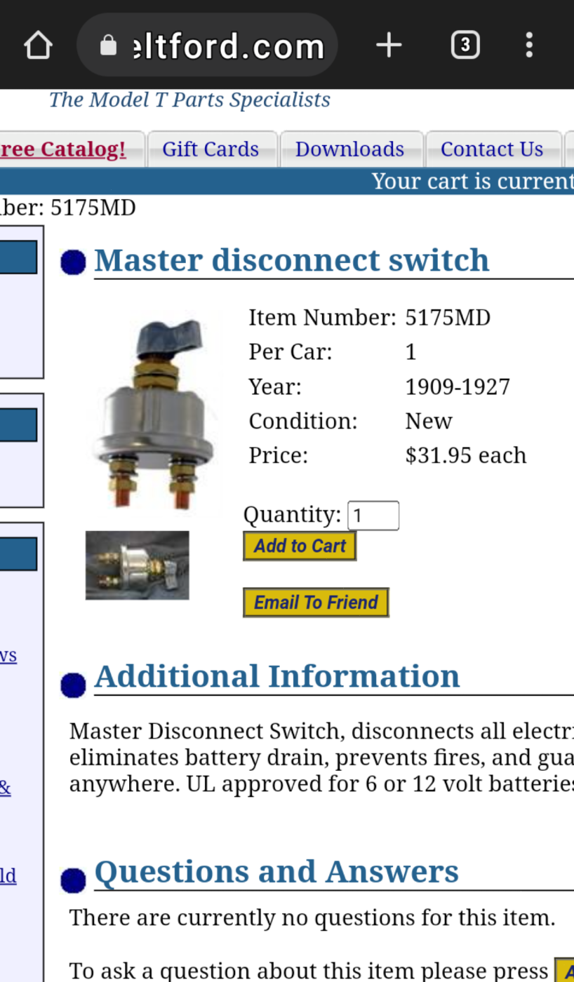

I've had this switch in my car for 3 years. Hearty and reliable. Hasn't let me down.Just get crafty as to where you want to hide it.[/size]

use this and hope it doesn't back off or vibrate loose while engine is running.... no ground makes your generator produce "The magic smoke...." use the one i posted from LANG'S and put it within reach of the driver, so you can shut power down quickly and safely without having to pull over, get out, and access the battery....
Use this one!

This depicts what I use. But I use the switch to cut all power to the battery. The battery remains grounded whether switch on or off.

The harbor freight stuff is not even close to the quality switch LANG'S sells. Choose wisely....
