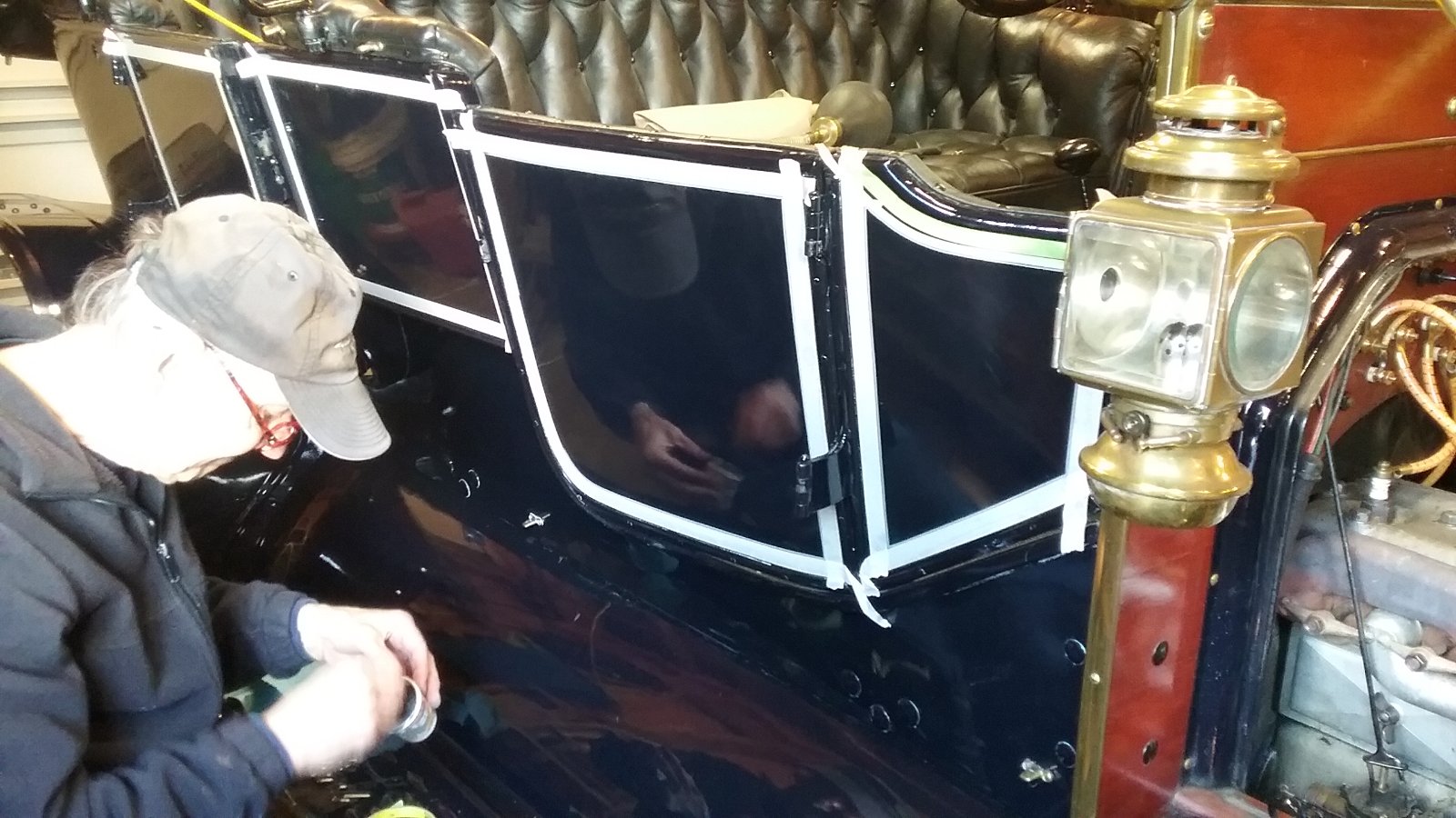

The presence of tape in the above photo doesn’t mean the stripe will be taped off. Many stripers use tape as a visual guide only. Are they poor craftsmen ? Perhaps not as able as the guy who can do a credible job entirely “free hand”, but they are few and far between.
Re: Pinstriping Details 1912 Roadster
Posted: Mon Oct 13, 2025 2:07 pm
by KWTownsend
Allen, when I first saw the tape I had the same initial thought. Then he explained that is was for a guide only, as Rich pointed out. The stripe was not "taped off". He mixed the French Grey by eye and he did all the striping free hand with an itty bitty brush. He was a true craftsman and didn't charge me enough. He was facing some physical limitations and told me my car was the last one he'd do.
Here is how the magic happened...
