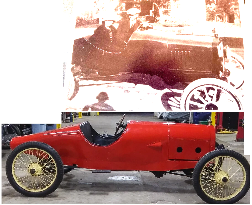

A client sent me this picture of a speedster his grandfather built. The client would like to know if the body is factory or homemade? I think it looks close to the Champion model A body, but I invite your opinions.
Chris
Re: Does this original speedster look like a commercial or homemade body?
Posted: Thu Oct 23, 2025 11:39 am
by TRDxB2
Need to match to the passenger side body line
Posted: Thu Oct 23, 2025 11:46 am
by TXGOAT2
Similar, but not an exact match. Looks manufactured, and manufactured speedster bodies probably had variations within a single maker's products over time.
Posted: Thu Oct 23, 2025 12:42 pm
by ewdysar
To my eye, it looks to be a closer match to the Model "C' in the advertisement. The louvered hood and the cowl to hood transition angle are very similar to the drawing. The car in the photo looks to have taken the suggestion in the advert to remove the stock Ford fenders, running boards and splash aprons, but it still appears to be running the stock Ford radiator as described in the advert copy for the "C" version.
Keep crankin',
Eric
Posted: Thu Oct 23, 2025 12:54 pm
by RajoRacer
The cowl line is "swept" back on the advertised body unlike the one in the photo - it's straight - not the same.
Posted: Thu Oct 23, 2025 1:15 pm
by Humblej
Regardless of the make and model of a particular manufacturer, to answer the original question, it looks to me like a manufactured body not a homemade body.
Posted: Thu Oct 23, 2025 9:53 pm
by AndyClary
Looks similar to C. But you have to remember that the same bodies were sold under a variety of names.
Andy
Posted: Fri Oct 24, 2025 12:57 am
by Dodge
Manufactured. There were so many short lived manufacturers its hard to pinpoint the exact manufacuturer of some of these bodies.
Posted: Fri Oct 24, 2025 1:50 am
by TRDxB2
Hard to match it, but some similarities. The builder of the car did make some modifications to the original design.
Top of back seat, length of cowl, steering wheel close to dash.

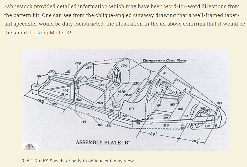

This link has the instructions for thr RED-I-Cut need to scroll down https://www.mtfca.com/discus/messages/3 ... 1386522911
