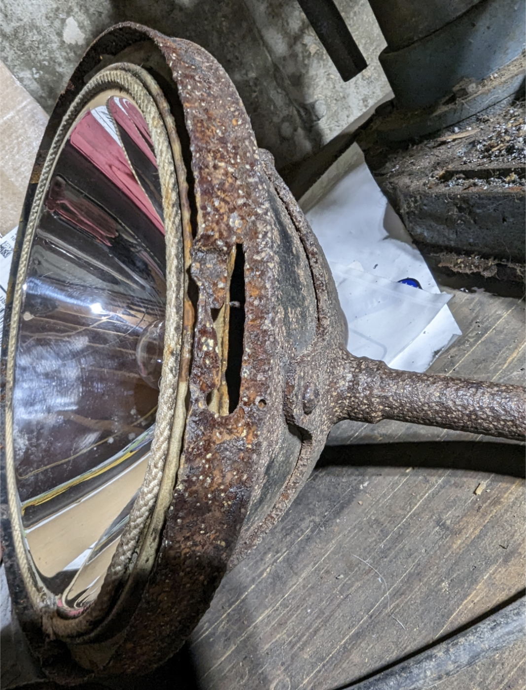

by DanTreace
Thickness is important too, to prevent lens rattle, the modern nylon cord on left is smaller, the larger cotton cord (like clothes line) with more twists is better.
Originals used a type of black tar like adhesive on the cord seal......

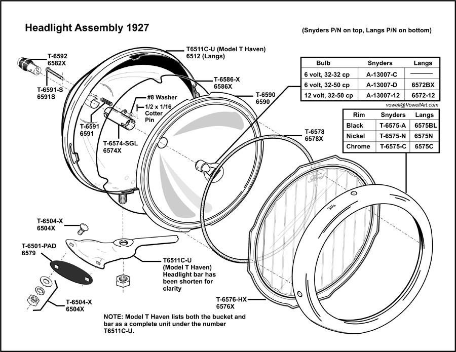

Posted: Mon Nov 10, 2025 4:19 pm
by jiminbartow
From Vowellart in the MTFCA gallery:
