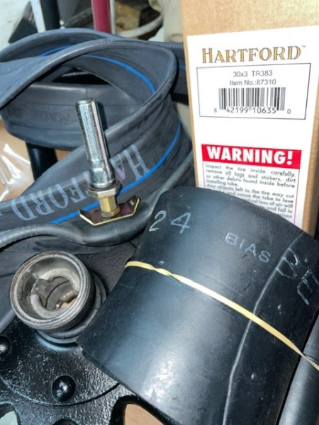

Post by DanTreace » Sun Dec 07, 2025 9:24 am

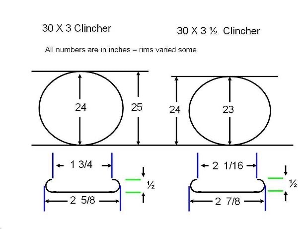

IMO, don't think that can work to stuff a 23" dia flap and the smaller 23” tube in the 30x3 tire casing that is made to fit 24" clincher rim.
30 x 3 1/2 clincher tires and tubes and flaps go on the 23” rim.
Got these from Coker, right size 24” dia. 30x3 brass stem tube, and proper 24" flap to go into the 30x3 tire clincher 24" front rim.

Dan, did you have any problems cutting off the rubber stem on those Hartfords? I haven't tried it yet. I see you have an incorrect bridge washer. I wonder why that company can't make them as original?

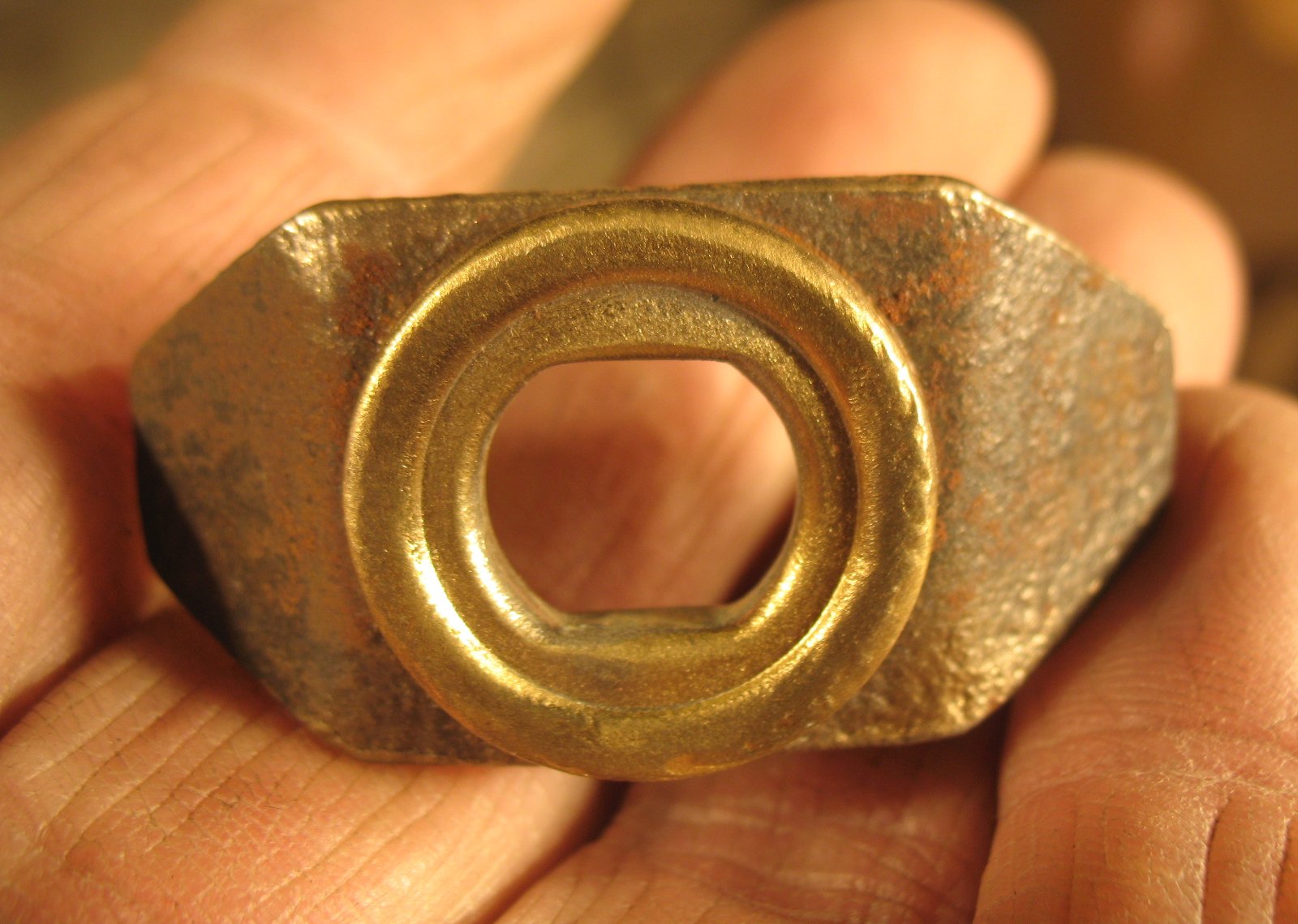

"Wrong" bridge washers cost $12 each, new
Who here would pay $30 each for "Correct" washers?
I seriously doubt that there is a market for correct new washers given that authentic parts can be had for a couple bucks, but I would not consider tooling up and making dies for less than that, and it would have to be for a market that displayed a healthy demand. I don't make parts on speculation any more - got enough of those on the shelf already... :?
I'll just sit back and wait for pre-production orders to roll in and see if it leads to anything.
Posts: 7411
Re: Tube Size Question
Post by Steve Jelf » Sun Dec 07, 2025 6:00 pm
$30 for a bridge washer is pretty scary. I'm glad I got into this game when you could still pick up tire hardware cheap at swap meets.

Post by DanTreace » Sun Dec 07, 2025 9:29 pm

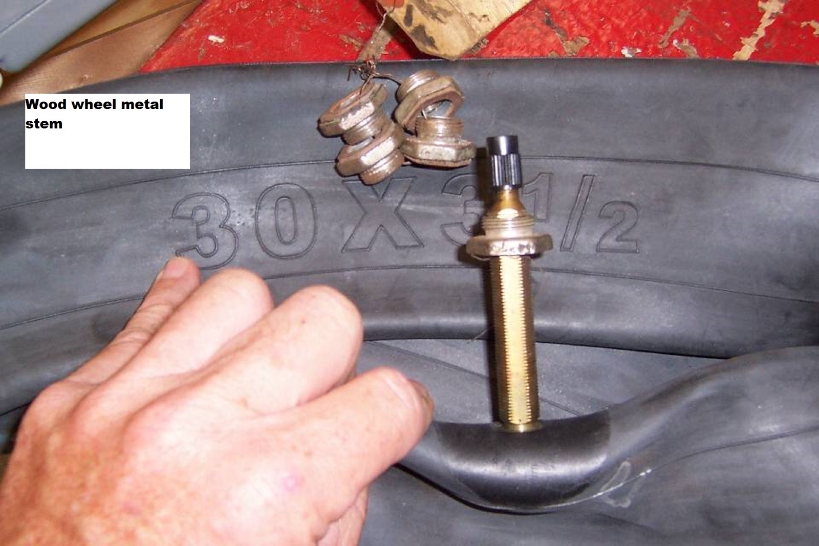

Of course the correct is the original type of combination ring and bridge washer. The ring preforms the pressure around the base of the stem to prevent leakage.
With modern new metal stem tubes, the stem is already vulcanized to the tube, so the ring is insignificant, the repro flat bridge washer does it's duty of keeping the stem from shifting, as the rim nut exerts the pressure.
Now if the owner wants to cut off a new rubber stem tube to place a metal stem, the combo ring and bridge washer is needed, and the correct "777" small size ring and bridge washer and associate hardware has to be located, as this size isn't made new.
The advantage of the new metal stem tubes is the "725" size dust caps and rim nuts will fit with ease.
INo. 777.jpeg (87.01 KiB) Viewed 4018 times
The "777" is the smaller stem, but most later cars used the "725".

Note in Dan's first printed page....the tube is sandwiched between the flange on the valve stem and the bridge washer with its pressed in sealing ring. That drawing that keeps on being posted showing the FLAP also sandwiched between the flange and bridge washer is just that, somebody's inaccurate drawing.
With rubber stemmed tubes, there is no bridge washer and no stem nut to take a dust cap, because there is no need for them, just as there is no need for them on brass stems, some of which were thinner and never had thread anyway. If any stem is canted in use it indicates that the tyre is running under-inflated. Anchoring it with a stem nut to keep them upright Is not the amswer. Noticing a canted stem may well be a wake-up call that the tyre needs to be re-inflated.

Post by Original Smith » Sat Dec 13, 2025 1:09 pm
I posted this ages ago, so perhaps some have forgotten! An 888 valve stem easily replaces the 777, being 1/4" shorter. Same everything else. It may decrease the weight slightly. I'm using them in all of my cars.
