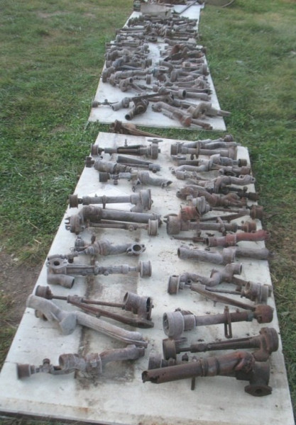

Went through several radiators in my hoard , they all leaked in one way or another , my recently deceased father was insistent that we put a water pump on , so he rebuilt it ( he was a machinist and mechanic ) and installed it on the vehicle . Never really drove it any length of time , so once I started putting it back together , I left the pump on , just ordered a new radiator and will take it off if it will hurt anything , but would like to leave it on because my dad had rebuilt it , if that makes any sense ,

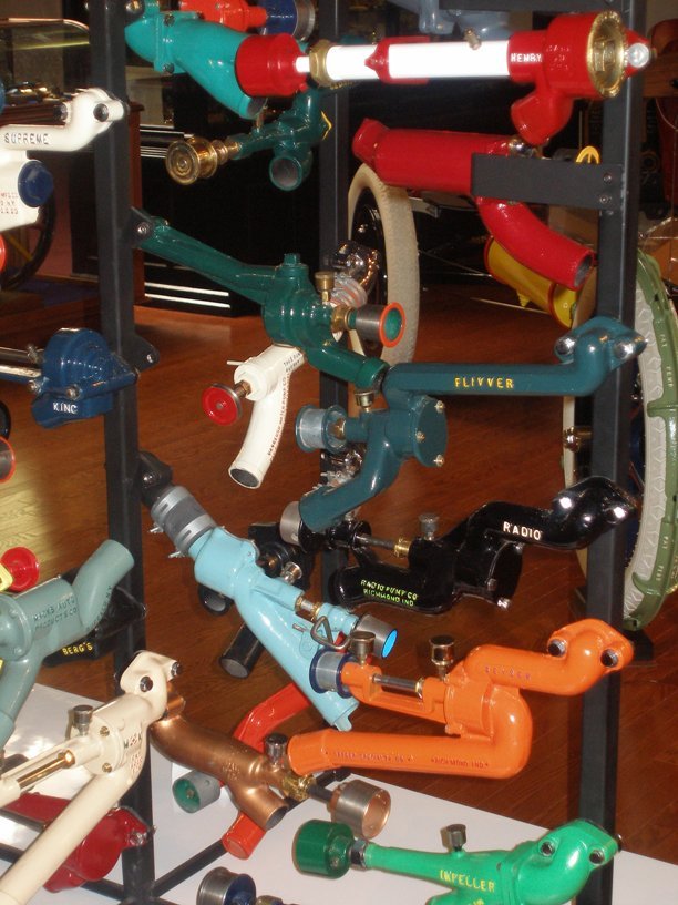

Henry Ford used water pumps whenever there was a practical need. Starting with the 1928 Model A, every Ford had a water pump. In 1932, Ford introduced a V8, and every one of them had TWO water pumps! All Ford V8s through 1953 had two water pumps.
- Posts: 8679
Re: Radiator /water pump
A comparison of specific HP output:
Model T: 0.11 hp per cubic inch displacement (No water pump)
Model A: 0.20 HP per cubic inch displacement (Water pump)
1938 V8: 0.38 HP per cubic inch displacement (Dual water pumps)
Ford, and most everyone else, installed water pumps as specific output increased.

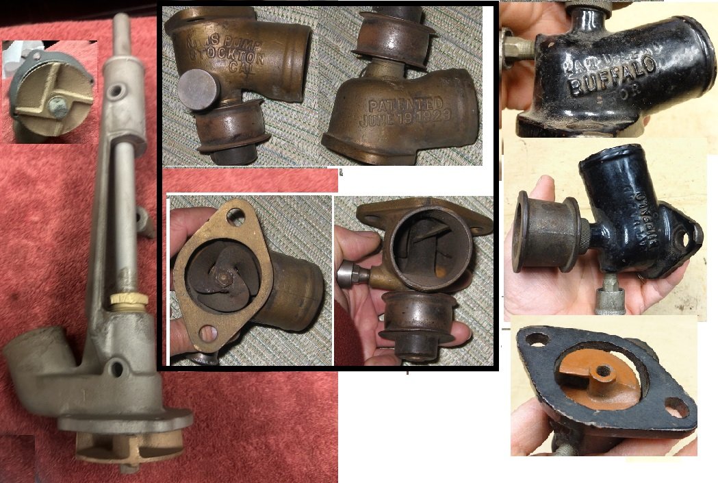

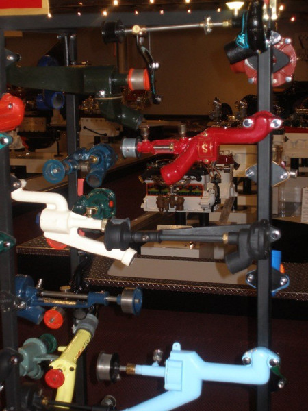

The answer to your question all depends on which water pump you have, and there were lots... --Oldrusty26 wrote: ↑Mon Dec 08, 2025 11:22 amNot to open a fresh can of worms on an old subject ( I’m going to anyhow ) I’ve ordered a new flat tube radiator for my roadster pick up from brass works , my engine currently has a water pump , question is , will the water pump restrict the cooling capabilities of the new radiator and should I remove it , or would it be ok to just leave it on ? I realize that they are not needed , but will it hurt anything to be left alone ?
Thanks in advance !!
The impellers on many were an open design, so they wouldn't restrict water flow in the event of a belt failure --
By Stan Howe on Thursday, November 01, 2007
While I don't run a pump usually, it is fair to say that some of them work a lot better than others and that they DO circulate the water. Some of them don't look to me like they would have ever moved much water but some of them move a lot of water, even at idle or just above. I have a bunch of them, have always been going to put together a display. Now I have a bead blaster again I hope to get some of them cleaned up and mounted on a board or something. The trick on the packing is to use the correct packing, water pump packing. If the shaft is smooth and the packing good, they won't leak and will still turn. Just because it is dark and cold out this morning I'm going to post these pictures of some of the pump collection at the Speedy Bill Museum in Lincoln, Nebraska. This isn't all of them. Maybe it will inspire me to go out and turn the heat on in the shop and do something today.

Topic author - Posts: 105
- Joined: Tue Jan 22, 2019 8:13 am
- First Name: Travis
- Last Name: Melnick
- * REQUIRED* Type and Year of Model Ts owned: 26 Rpu 27 Tudor 25 TT 25 runabout many misc projects
- Location: Waterford pa
- Board Member Since: 2012
Awsome !! That’s a fantastic display of pumps . There’s several dozen in my parts hoard
