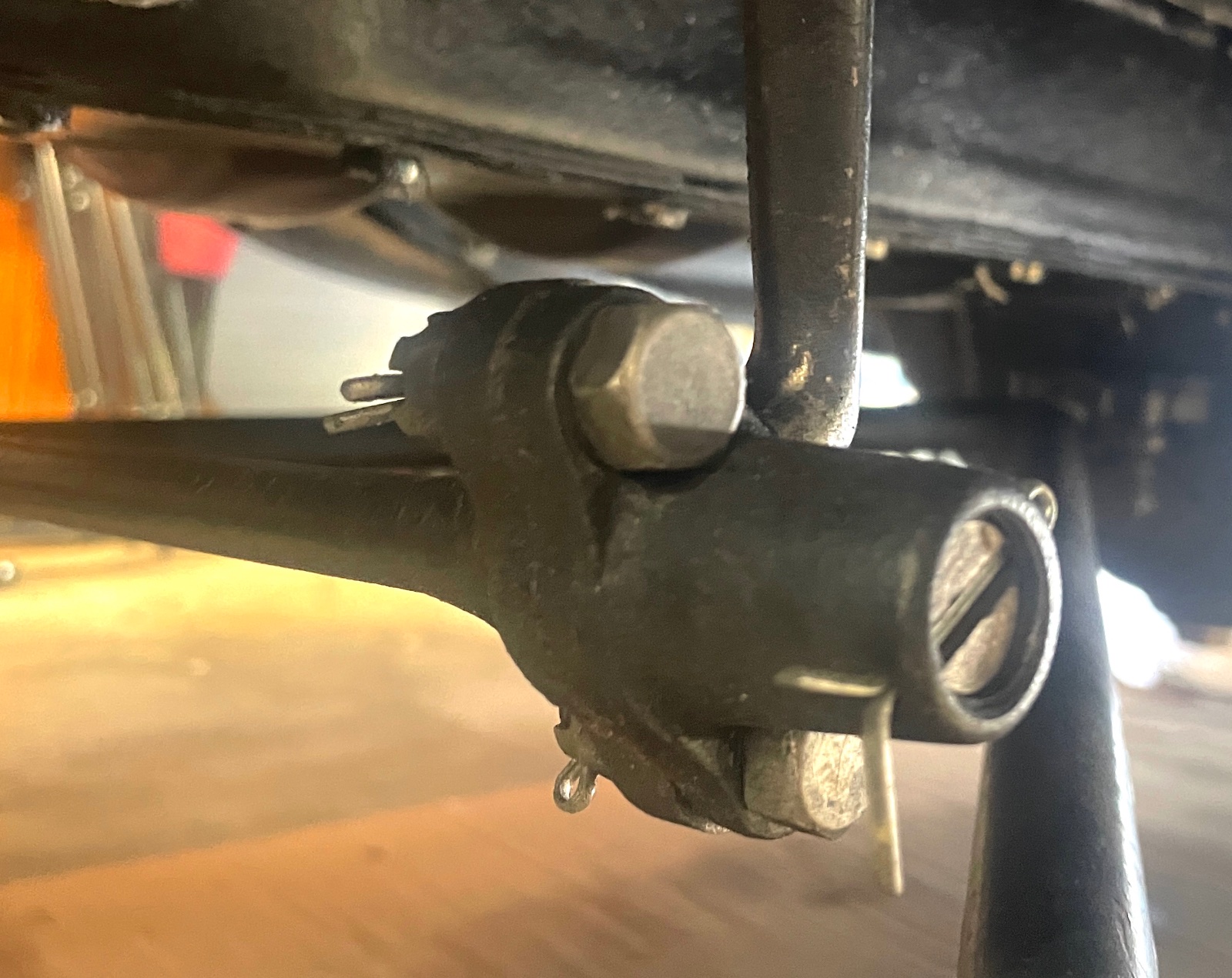

This is close up of the Sprague drag link spring loaded piece on the pitman arm.
FYI, Dennis Fleming has a center door with this accessory steering gear, have seen the car in his T barn.
Or you can use an APCO spring loaded cap to take up wear too.
