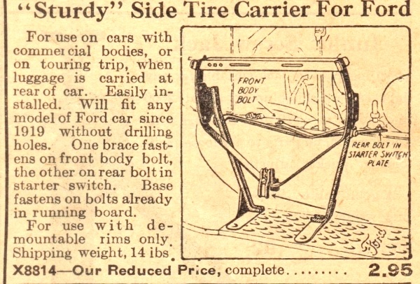

Would image Larry found a NOS Accessory Rim and tire carrier of this brand.
Or made a copy of one? Likely his is an original accessory, can see the angle channel iron for the uprights, just like the accessory.
Sure is very practical without harming the sheet metal or drilling added holes.
Scan0415 (600x406).jpg (140.56 KiB) Viewed 704 times

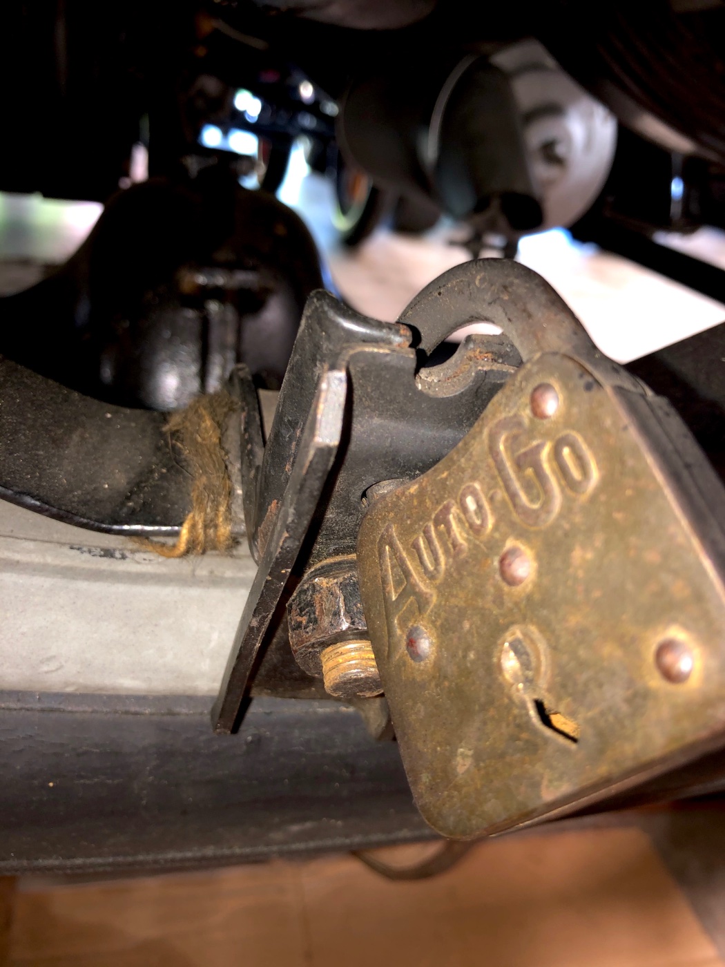

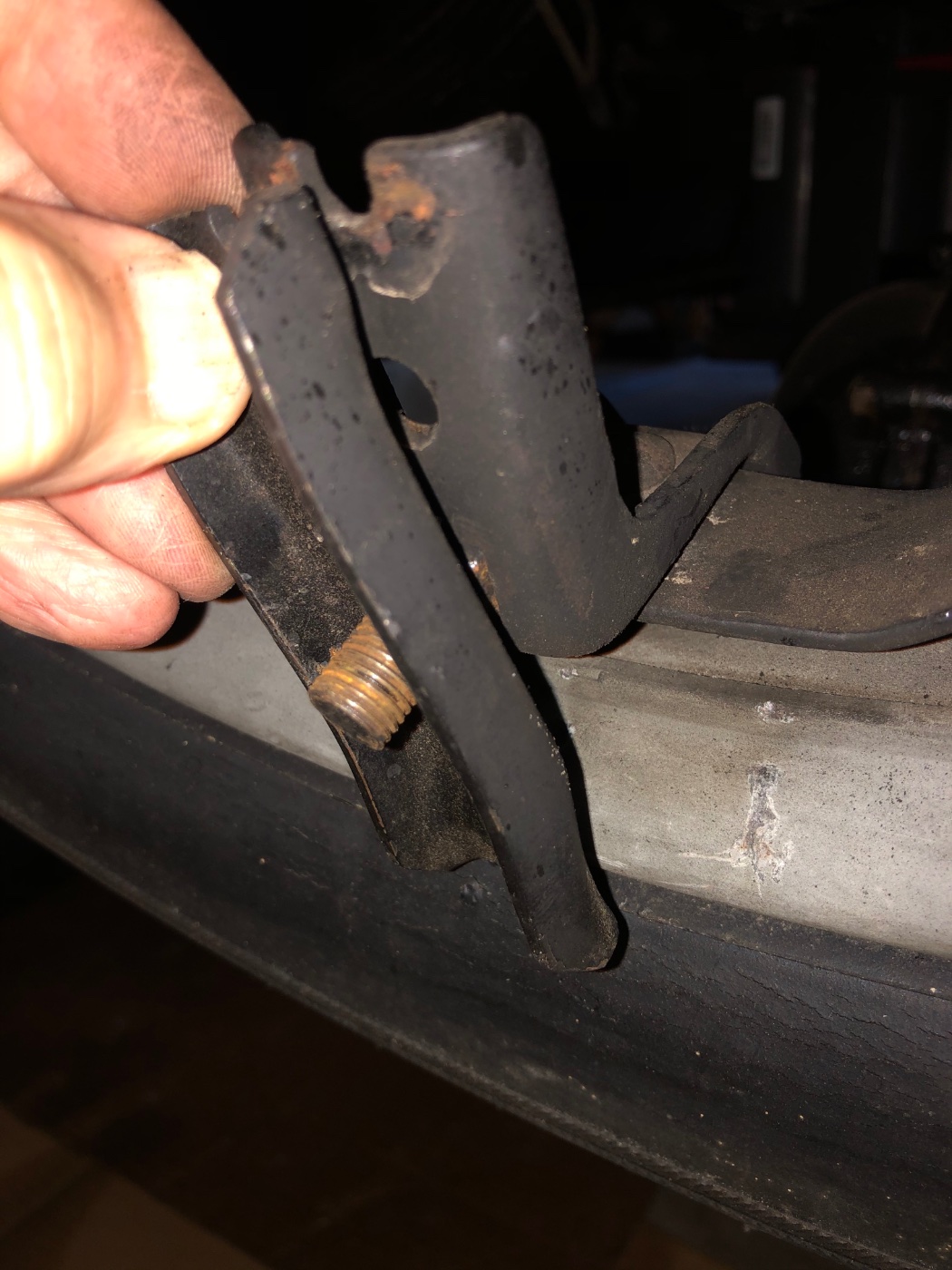

AND....the missing piece
I hesitate(Not really) to point out that the spare is mounted incorrectly on this carrier.
Is the 2849-D Spare Rim Carrier Clamp
And for safe keeping of that expensive tire and rim, add a padlock ;)

Actually upper rim lugs should be evenly spaced to the mount ears on the topside. turn the rim CCW about 45 degrees. The stem would left of center.
There is a clamp that holds the rim in (not thru a mounting lug)
#2849D "spare rim carrier clamp outer 19-25"
The nut holds the clamp in place. Above is a hole & slot matching the carrier mount as you see there. The hole & slot are meant for a padlock.

What a neat piece. I thought Larry might have made modifications to an original rear carrier. But, your advertisement shows the exact piece.
It appears the accessory manufacturer modified a ford carrier with different bracketing to mount on the running board. That looks like a ford carrier complete with license plate & tail light mount. What a nice find.

The first photos were posted because I don't know how to post a photo from my cell phone. This carrier was purchased by me many years ago. I restored it and hung it in the garage for several years. I decided to put it on finally and the photos show the result. This is an original aftermarket tire carrier that uses the original Ford carrier in the center. The two brackets that attach the unit to the running boards are adapted to the original. There are two straps that offer stability to the unit. One goes to the front body mount, and the other goes to the rear starter switch bolt. I drove the car on a tour down in San Diego yesterday, and the unit seems to be happy in it's new location.
