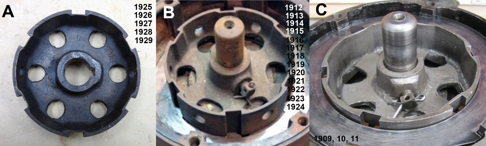

Is this the correct Clutch disk drum?
Thanks again.

1920 after April? (my reference material is @ home)-1925 same until the wide drum
"Is this the correct Clutch disk drum?"
This is the most confused part. How to identify.
Since I see ford script on top, I would say, yes, its correct for 20-22?.(late using the 3 thick thrust washers.)
Some time later the back side has a beefer looking casting. Probably 22-27.
As another point, on the 3 washers. The thin one I had & are available look the same OD wise as the thick washers.

I would appreciate getting some help clarifying these different clutch disk drums.

B) 6 holes would be early, like 14,15 & earlier. Probably DB marked.
A) Ford script on top side (Post brass hat thrust. 3 washers) Post early '20.
C) Ford script. Hard to tell, but looks like a heavier casting. Back side is heavier with a chamfer to the thrust surface. Look on the back.
This would be later than A. Most common type found today. This one fits your 22-25 range.
Happy to see you figured out the clutch disk difference. That would have been my next comment/edit.

Point of clarity: I believe the clutch drum with the 6 holes along the OUTSIDE is an "early" drum which would have been used with the "early" brake drum using the "top hat" style bushing & 2 steel thrust washers.

I just did a look at each parts catalog from 1909 to 1929 and found these years as presentation and order of presentation.
Jim Key
The top hat style bushing is the thrust washer. There are no additional steel washers used.(originally)
Not all early clutch hubs have 6 holes.(pre '20) Not all 2 hole hubs are post '20. There is that period from about '15 to early '20 that have the 2 holes & the smaller thrust surface for use with the top hat bushing. There is the period from early '20 to around '21ish that have no Ford script, but fit correctly with the 3 steel washers. The 6 hole I have is DB marked.
The top hat bushing was used until early '20
Early brake drums that require a distance plate & 26 disks were used thru early '16.
The above information comes from service bulletins, period documents some from past posts & observation with measurement.

Just looking @ B. A 14 clutch hub is different in the thrust face clearance than a '24.
I do believe all of them will fit any year transmission/brake drum & center shaft.
The difference is in the amount of thrust washer thickness thats needed to maintain the thrust spec.
You could use an early hub in a 27 transmission drum, but you would need a thinner thrust washer pack OR remove .015 off the hubs thrust surface.

After further R&D, and re-reading Trent B's post from years ago, I think I am closer to the truth today with these clutch drums.
Benson archives mentions a T-725 (1909) and T-725B (after 1909).

Some of the information matches my findings. Some are in error?
751B lists the 1 piece type '17-'27 Also listing the 3 piece type '09-"21 (4 years MFG both??)
725B listed as '09-'27. (thrust surfaces are different '20-'27)
Distance plate usage & hat brake bushing use do coincide with service bulletin notices.
Aluminum HH's claim to be the same '11-'15. We know there are reinforcements added around mount holes for '15.
Thanks for posting this info. Ill sift thru it.
