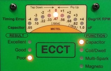

I am using a ECCT coil tester.
Since you are using the ECCT Capacitor Test function, If the the test result is "Poor" illustrated below:
ECCT Capacitor Result with Leakage.jpg (45.02 KiB) Viewed 263 times
Referring to the ECCT Instruction Manual for guidance: Section 4.3 on Page 8 in bold red text: Capacitors that test Poor but are in the range of 0.47uF to 0.56uF do NOT need to be replaced. The reason is explained in detail previously.

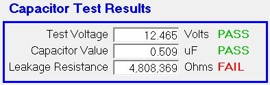

An added benefit of using the ECCT Advanced Features Software is a clearly displays the parameter testing poor is Leakage Not capacitor value. In hindsight, the leakage test should not have been this sensitive because such a high value (> 100,000) has no significant impact on ignition coil operation. Always judge the need for capacitor replacement on Capacitor VALUE, NOT LEAKAGE! Capacitors that test LOW in value (0uF to 0.22uF) warrant replacement. 0.33uF is marginal but still within the typical 20% tolerance range.

I learned from Mr. K's instruction on leakage test failures.
We have been holding the lower point down.
Having the point bar touching the core is no good & there is the possibility of fingers touching the upper & lower point bars.
So an insulator between the points is the way to go.
