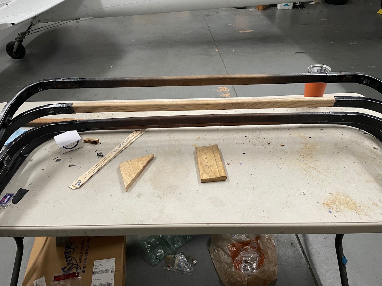

I started today (Tuesday) by replacing the windshield stanchions with a nicer set than those that came with the car. The old ones looked nice enough, but when I wire wheeled them in preparation for repaint I found that they were badly pitted and had been repaired with body filler. I found a nearly pristine set in the classifieds here a few months ago, and got them cleaned up and painted last week.
I then started to pull staples. :shock: I ground a staple puller out of an old 3/16” diameter scratch awl, which I had in turn ground out of an old screwdriver many years ago. I got all of the staples out except those attaching the rear panel, and only had to touch up the tip once. For ease of access I removed the majority of the staples with the top folded down, raising each finished bow for access to the next.
Sharp hollow ground angled tip on my homemade staple puller made getting behind the staple relatively easy. Quenching the tip in water immediately after grinding made it hard enough for reasonable durability.
Upon getting the main top panel loose from the front three bows, I noticed there were no straps between the rear bow and the header, none between the seat tack rail and rear bow, and no straps inside the pad covers, as called for in the Classtique kit and all videos I’ve seen on the subject. The only fore/aft structure was the pad covers, and the only structure between the rear and second bows was the rear panel itself. The top always stayed neat and tight (except for the broken bow), so I’m guessing that whoever installed this top was good at upholstery, but wasn’t very familiar with Model T’s.
Look ma, no straps! This is the configuration I took the measurements from.
Before removing the pad covers I raised the top and reattached the header bow to the windshield so I could take measurements to compare with Rick Duquette’s sketch. The rear bow is a full 4 inches higher and nearly 5 inches further forward than it should be, and the 3rd bow is 4 inches higher than it should be. Fixing these discrepancies should improve the look, and maybe lower the top enough to go in my enclosed trailer with the top up.
My actual measurements are circled.
This last photo is where I ended up tonight. After removing the rear panel I’m going to remove the bow assembly from the car so I can clean and repaint it, replace the 3rd bow, and wrap the bows.
On the 3rd bow (highest in the picture) you can see the broken end of the wood.

I got the top frame off the car today and removed the broken third bow. One thing I hadn’t noticed before is that the bows are slightly arched over their length, about 1/8” on the front and rear, and about 3/8” on the middle two. My plan was to buy some white ash stock and have a friend with a wood shop plane it to size and round over the edges. Since the third bow (counting from the rear) is nearly horizontal, would it even be noticeable if I left it straight?
Miles
1924 Touring “Bonnie”
1925 Express Wagon “Clyde”
Posts: 4508
Re: New Classtique Top for my ‘24 Touring
Post by Jerry VanOoteghem » Thu Mar 19, 2026 7:21 pm
Miles,
When I replaced the front bow in my Touring car, I purchased a full set of bows and used only the front one. I have two left. One is 41-1/4" long and the other is 40-1/4" long. They appear to be white ash and are trimmed down at the ends to fit the bow sockets. If those dimensions suit your project, you're welcomed to them. Let me know.

mbowen
Posts: 465
First Name: Miles
Last Name: Bowen
Location: Brighton, MI
Post by mbowen » Thu Mar 19, 2026 9:13 pm
Jerry, the 41-1/4” bow is perfect. Text or email me about when and where I can pick it up. I’m up for a road trip just about any time. ;)

I got the new third bow fitted today. I’m embarrassed to say it, but I made a bad assumption, and the bow I picked up from Jerry was an inch too long (no, the third bow is NOT the same length as the second. :oops:) Rather than make another 100-mile round trip I just shortened it. The opening in the right side iron was slightly smaller than the one on the left, so some filing of the bow was required. I don’t have the rivets yet, so final installation will have to wait a while. I still need to sand and repaint the irons so there’s no rush.
Miles
Posts: 7342
Post by Allan » Wed Mar 25, 2026 6:31 am
Over the years the folding mechanism will have worn pins, perhaps bent irons and other maladies. It is important to get the bow set working and aligned as it should be before setting out fitting the top. The foundations need to be correct for a decent job. Using the webbing straps to maintain this bow relationship is not the way to go.
Once the bow set is working as it should, the bows can be held in place with thin laths of timber tacked to the underside of the bows, with short lengths on the inside to hold the back bow at the desired angle. Then you are ready to attach the webbing straps and hood bags.
Hope this helps.
