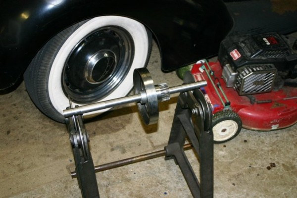

Posts: 7413
Re: Transmission drum balancing
Post by Steve Jelf » Sat Jul 06, 2019 1:33 pm
What R.P.M. do you intend to run this engine ?
I wouldn't push it over ten thousand. :D
If you use little magnets for weights you don't have to mess with tape. They're cheap. These little round ones weigh 4 grams, but you can get them in different sizes.

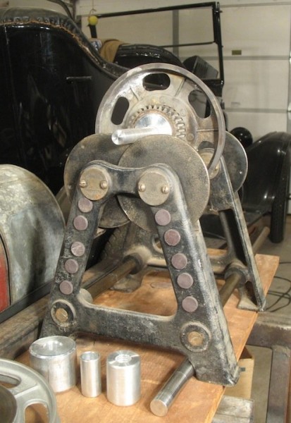

Here's my setup,
I noticed in Steve's picture (I'm assuming that is Bender's balancer) that there is one shaft and a couple of adpaters that slip on to the shaft for each different drum? Can to tell me what diameter the shaft is? I believe I should make those pieces, it may make my work easier.
Mike

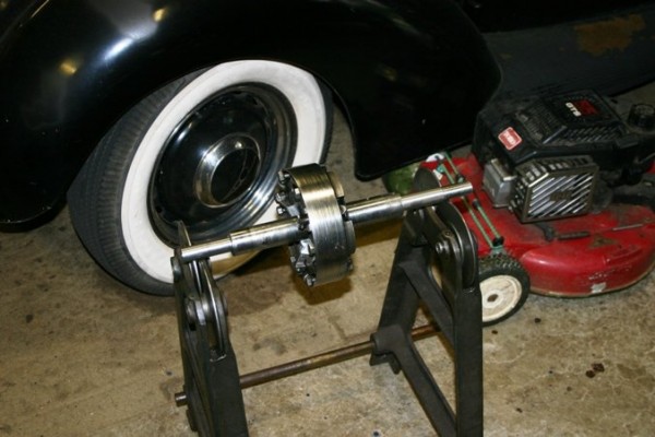

The balancer is Steve's but I have one much like it. To answer your question on balancing shafts I made one for each drum. I have found that finding the heavy side of the brake drum and drive plate and putting them 180 degrees out really helps in balancing them. I set up the brake/drum as a unit and then balance. Hope that helps.
Posts: 7413
Post by Steve Jelf » Sat Jul 06, 2019 3:17 pm
I have two shafts, ⁵⁄₈" and ⁷⁄₈". Both work OK. I think I made the larger one then found the mandrel for something I wanted to measure would require a smaller one to fit. I made the shafts from an old junk axle shaft. All the mandrels and shafts were done on a borrowed lathe at the local juco machine shop.

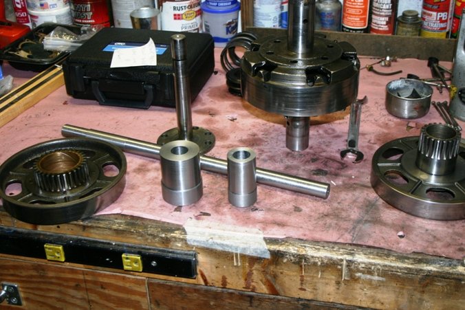

Well..... over the week end I had some time to make a shaft and a couple of donuts
Today, I found some time to first try these.
This should make balancing a lot easier. THanks for the help
