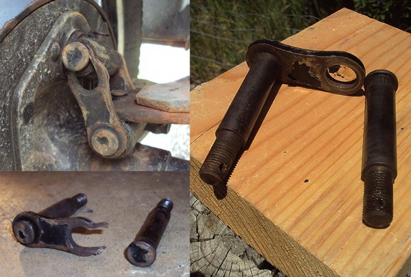

6 years ago I posted the failure of my rear spring shackle. The photo became the "poster boy" for this style and it's problems. Several others mentioned their disappointments with them. I didn't want to be the complaining customer and have reported that even though I had bought some of the better shackles the 3 remaining shackles were in place and working. This weekend I finally got around to replacing the rears. While the remaining rear shackle was doing it's job it had worn the hole in one side larger and oval.

I found the loose shackle bolt was greasy but the other had lots of red rust on it and in it's bushing. Further more a piece of felt was still in one oiler. I had thought this was a good idea to keep the oil from running though too fast but evidently it caked and wasn't letting much oil through at all. Shown is a hooked tool to remove the felt. This very well may be what led to the failure 6 years ago. If the shackle bolt seized in the bushing and the link rode on the serrated part it sawed it's way through. If so I need to take responsibility for the failure rather than blaming the design.
