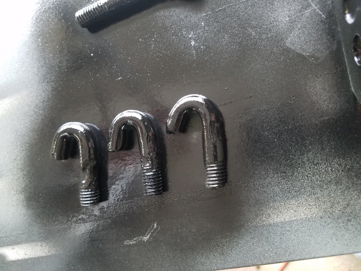

Glad it warmed up a bit. Spent some time on the old Rockford lathe tonight.
Turned the left bolt into the center bolt to match the original right bolt.
I made 14 of the 29 bolts that broke or was beyond saving.

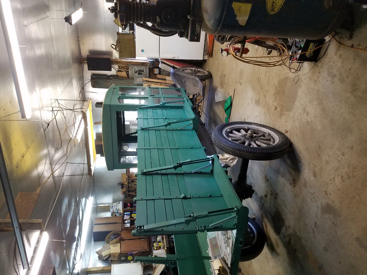

Re: 8in1 American Convertible Motor Truck Body " restoration"
Posted: Sat Mar 23, 2019 1:18 pm
by Dallas Landers
Let the fun begin!

I found some interesting thing on the 8in1. The rods that hold the sides in place are all different. There are 4 of them. The way they attatch to the bed is different also. Now these rods have to be the same length or the sides will be crooked when it if folded out. I think one is original but with nothing to compare it to Im not sure. I just painted all that hardware but will get photos posted.
Posted: Thu Mar 28, 2019 5:17 pm
by RustyFords
Interesting. Are these rods things that would've seen heavy usage...and therefore became worn out or broken over time?
Posted: Thu Mar 28, 2019 5:21 pm
by Dallas Landers
I thought this was interesting. This eye bolt is flat stock folded over and hammered round and is split like a cottoer pin and threaded.
You can see the four different ends on these support rods.
These two are close but not the same.
These two are close to the same. Both hammered and folded but they added a rivet to one.
I think during a hard life this were some of the repairs done to keep it going. I can almost smell the smoke from the forge that these parts were made on and hear the ring of the hammer. I can see where it was filed and cleaned up.
These take the place of the eye bolt in the photo above along with another metal piece. Not sure which is original and dont really care as it adds to its charm. Just keeps me thinking about how they made that part and how it broke. I have had to straighten many things on this bed from its former life of hard work. I will use this bed as it is a truck but it will have a much easier life now.
Posted: Thu Mar 28, 2019 5:28 pm
by Dallas Landers
Don, these rods support the side racks when they are folded out or upright. I think what probably broke is the eye on the end of the rod. It is pretty thin. The rod is 1/2 inch round so pleanty heavy.
I think back then without a welder, forging a new one was all that could be done. Unless you ordered a part and waited to finish your work while waiting on it to arrive.

Posted: Sun May 26, 2019 12:07 pm
by Dallas Landers
A few photos of bed and how it works
Rods in closed bed style
Locks to keep sides closed. 1/4 turn to unlock.
Folded out with support rods in place and cotter puns to keep in place

Thanks Dave. Maybe not better but it is usable. It will never look better than now because the way its made it gets scratched just moving the many parts. It will make a nice truck for hauling people or just about anything.

That looks fantastic! Love the top job you did!
Hahaha, I saw the arch as soon as I saw the tape pic. :)

I would sure like to see this in person. Will it be at the OCF this year?

Thanks Duey! Turned out pretty good for a beginner.
Ed, I plan on it. By then I should have some miles on it and be better at shifting that chicago 3 speed. If they will have me and I can find a trailer big enough.
