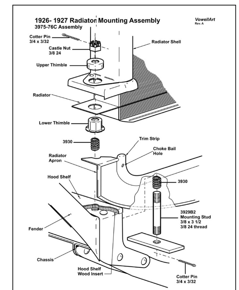

I went to put on the original apron that I removed over 50 years ago on a 26 coupe. When the crank hole and screw below hole is aligned up, the 2 tabs that go over the radiator studs are about a 1/2" above the frame. I don't remember anything between the tabs and the frame, am I wrong. I'd appreciate a diagram of how this fits together.

Go's above the hood shelves.

Posted: Wed Aug 14, 2019 8:11 pm
by DanTreace
Re: Radiator Apron Not Fitting Right
Posted: Wed Aug 14, 2019 8:17 pm
by dunoon
That's it, Thanks loads

On my ’26, the radiator apron fits on top of the hood shelves otherwise the crank hole and other features would not line up.
Jim S. correctly answered this.
Posted: Mon Aug 19, 2019 9:38 pm
by Jim, Sr.
Adam, Look at the drawing again. On 1926 and 27 the hood shelves are longer and pass under the radiator apron.
