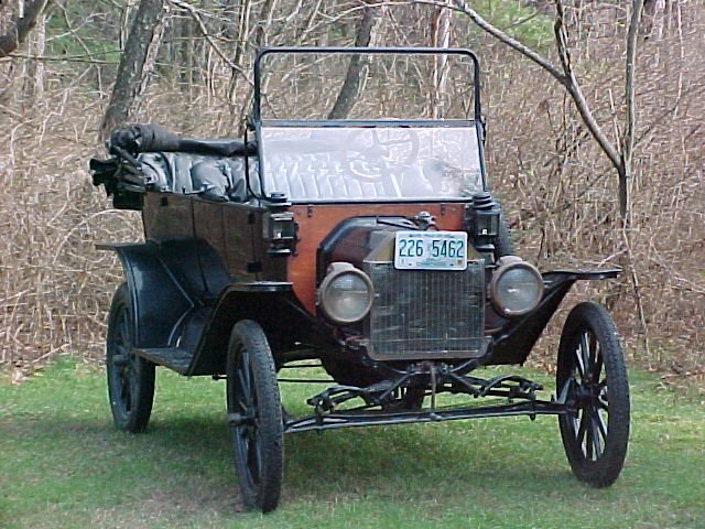

Wassamatta youze guys ? Let's find a "formula" that puts a 90-year-old mellow
patina on brass and leave that polished stuff to 70's disco decor !

No problem! Lizzie lives outside during her using season April through November.
Patinating formula:
Periodic sprays of irrigation water, the fine droplets from cottonwood trees, the inevitable contributions from the occasional bird and road dust.
It's up to the owner whether to accumulate the annual effects for another 89 years, or "go disco" at some point. Sometimes polishing brass can be a fun winter pastime. :lol:
