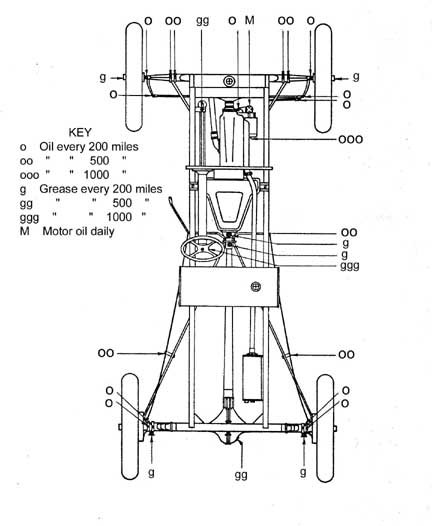

Do not overgrease the universal joint or the rear axles. I hope that you have taken the rear wheels off and checked your bearings and sleeves. Then follow the following charts.
And you can also purchase a full size chart from the dealers that is easier to read and a plus to have in your garage.

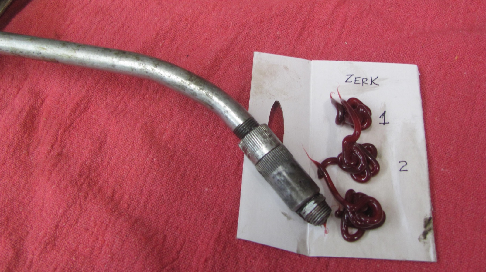

The typical Zerk has a smaller orifice than the dope cup openings. So you have to measure output of your grease gun.
My grease gun is the typical with long handle and a full open and close passes out a small narrow worm of grease, here is what 3 pumps looks like in a small Zerk as used on Ford 1/8" pipe thread grease fittings.
Ford Owner's Manuals state to use the dope cups, by filling and running down a 'couple' of times, to me that is at least 3 full dope cups, run down to the base......here is what 3 complete dope fills looks like in volume of grease. The dope cup base opening is larger than a Zerk, so the grease worm is larger!
Agree with comments on the U-Joint, that part needs the most grease as to schedule, Ford used the largest grease cup there.
IMO, fill the large U-joint dope multiple times and turns (or pumps of the grease gun if using a Zerk there), until new fresh grease oozes out on the globe of the torque tube. Wipe off the excess, then rub that on the clutch lever cam :lol:

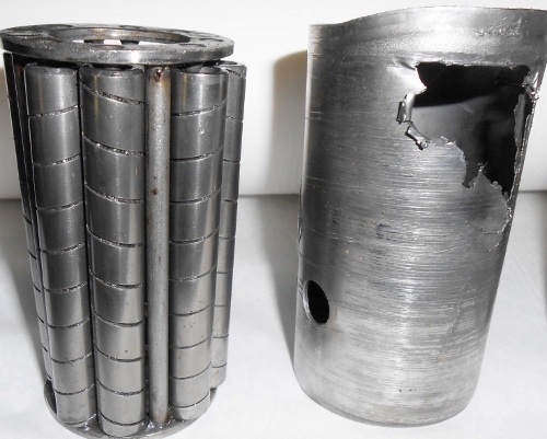

Respectfully, have seen failures on tours due to lack of proper lubrication.
Use your own judgement.
But our old Ford bearing tolerances aren't like todays modern vehicles, and we are all dealing with old used parts most times that need help, as gaps and voids let the lube dissipate.
Maintaining these antique vehicles for lubrication is important, some may get lulled into lackadaisy, as our normal every day moderns are so trouble-free for lubrications.

With due respect Dan, those bearing shells may have failed on a tour, but they were long gone before the few tour miles were put on them. They may well have been poorly lubricated, or perhaps were poor quality replacements.
I was thinking of the front wheel bearings mainly. These are precision Timken bearings , made like modern bearings, but performing much less stressful duty than the considerably smaller units in modern cars. Modern lubricants also perform much better than those available in the T era. If one does the mileage Dean Yoder puts on his T, then they may require service, but for most hobby cars, such service satisfies the need for tinkering rather than maintenance.
