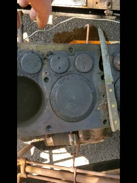

I have a similar, but slightly different problem: 4 groove aluminum pistons, with really big ring gaps.
Just today I pulled the pistons from a 27 engine that I purchased to replace the tired unit in my 27.
It is low mileage, and so the plan was to take it apart, check all the clearances, address any issues, and put it back together.
The pistons are aluminum 0.20 over and have FOUR rings. I will try to post a picture tomorrow.
All that is stamped on the top is "front", and ".0020"
I was told that it had new pistons because the originals had frozen in place.
New in this case is a matter of some creative interpretation, as they have some carbon in the center that looks like they were used for a while somewhere. So they are new to this engine anyway.
Indeed everything in the engine and transmission agrees with the description (without creative interpretation, I'm happy to report). (the only new parts had to do with the pistons, still some shims on the mains, (though checking the clearance suggests those shims need to go.)
I was able to check for taper in the cylinders and there is none. So it looks like the cylinders were cleaned up and these pistons fit the bill.
I plan to check piston and cylinder diameters next, if that's ok I'm happy to use these pistons. It's the rings that have me concerned.
The issue that has me stopped in my tracks is the ring gap:
I checked the top 2 rings on one piston, and they each have more the 0.030 gap.
So, now what?
I've looked, and no one seems to be selling ring sets for four groove pistons (0.020 over)
(Assuming my existing rings measure 1/8"):
Can I use 2, 3-ring sets and use (the extra top ring, or the extra 2nd ring) for ring 2 or ring 3?, or
Is there some other way to get a set of 4 rings?
In addition to what rings to purchase, I would like to know:
- which ring to double up on? wand which groove to put it in.
- how to orient each ring, and
- what ring gap to use for each?
Any help on this would be most apricated.

.031 was an original Ford factory oversize. The other factory oversize pistons and rings are .0025, .005, and .033. From Ford Service Bulletin Vol.5 No.6 Pg 45 , June 1924
Re: Help identifying Model T pistons, please!
Posted: Sat Jan 16, 2021 1:13 am
by Chris Haynes
I think you are forgetting one important step. Mic the cylinders to see how much they are worn. If they are over limits putting new rings in won't cure the problem.
Posted: Sat Jan 16, 2021 7:22 am
by Allan
I'm with Chris. If they are .031 oversize pistons with a worn set of rings, the bores will need measuring for wear and taper. Plus, if they are worn, a rebore to take .040" oversize alloy pistons may well not clean up the bores. Your machine shop will be able to advise you once they have measure and perhaps test bored a cylinder or two.
Hope this helps.
Posted: Sat Jan 16, 2021 11:11 am
by Mark Gregush
On my 25 with original cast iron pistons; Replaced the valves and doubled up the top ring using the 1/8" rings as a stop gap. Needed to get it running as I was on a time crunch and didn't have any extra std 1/4 rings on hand. Well 1, 2 and 3 pistons anyway, I didn't have enough extra 1/8" rings to do No 4 so it got the 1/4" ring. I figured having them in the top grove would allow plenty of oil to get to the cylinder walls.
When this engine gets rebuilt, the plan is to use cast iron pistons and I may keep the doubled up rings in the top grove for better compression and oil control. ;)
While the transmission and rear end are "loose", the engine has pretty darn good compression for being worn.

Thanks all for your responses!
Attached are the proverbial 2000 words.
With regard to bore diameter, I haven't forgot about it. I expect it will be suitable for 20 over pistons. I will check as soon as I get my hands on a 4" mic. (I've got one coming in the mail)
I was able to check for taper and there is none. Therefore, I don't plan on any significant increase in the bore diameter.
All the information I have seen says the ring gaps should be like 0.012 to 0.015 ish.
My gaps are > 0.030! Therefore I need new rings (at least). Or do I? Could it be that these pistons are meant to have 30+ gaps?
The question is: where to buy them? All the ones I see for sale are 3 ring sets, not 4.
If I buy 3 ring sets, do I buy 2 sets and use 2 of the middle rings, or 2 of the top rings, or as was recommended by ____ 2 of the oil rings?
Or I could leave one ring out? (I think I can rule this out, unless someone has had a positive experience with this approach.)

Here are the picutures
Posted: Sat Jan 16, 2021 12:39 pm
by 70boss2wv
Note the markings:
C3910 020 and FRONT

Posted: Wed Jun 30, 2021 1:43 pm
by Jdd
I am getting a lot of blow by past my rings. My Model T truck is pretty rough, I’m not sure it’s worth a complete engine overhaul. Can I get away with putting a set of rings on my old pistons if everything else doesn’t look too bad? And can I do that without taking the motor out of the vehicle?
Posted: Wed Jun 30, 2021 2:08 pm
by John kuehn
I think I would rebore to the next closest bore to straighten it up and install new aluminum pistons and rings. Unless it’s a low mileage engine with hardly any wear that’s the way to go.

Re: Model T rings
Posted: Wed Jun 30, 2021 2:33 pm
by speedytinc
Depends on bore wear & taper. More than .006" clearance - next bore size. Less than- rings only Is there a bunch of piston slap noise now? Does it go away when hot?
You can pull them out with the engine still in. Deglazing or honing is tough in # 4. Valve grind also. You will be addressing the valves also. If #4 Needs Valve work, the engine can be moved forward without pulling or you can remove the firewall.
Posted: Wed Jun 30, 2021 5:04 pm
by kmatt2
Those after market cast iron pistons may or may not be made for a Ford. The SS 174 most likely means Standatd Size. The Ford T standard size is 177 CID. The 0.31 is the over size as has been said. Frist check the cylinders for current size and uneven or taper ware. If the engine doesn't need to be boared, and you don't want to go to 0.30 aluminum pistons you could try to find a useable set of 0.031 Ford cast iron pistons that you can get rings for.
Any way you go it should bring that compression up. Be sure to upgrade those two piece valves to new valves that you can get from T part supliers.
