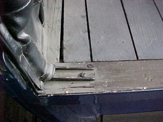

Hello William,
I have attached two photos of my 1913 front seat and springs. It is hard to see, but there is a notch in the plywood on which the springs rest.

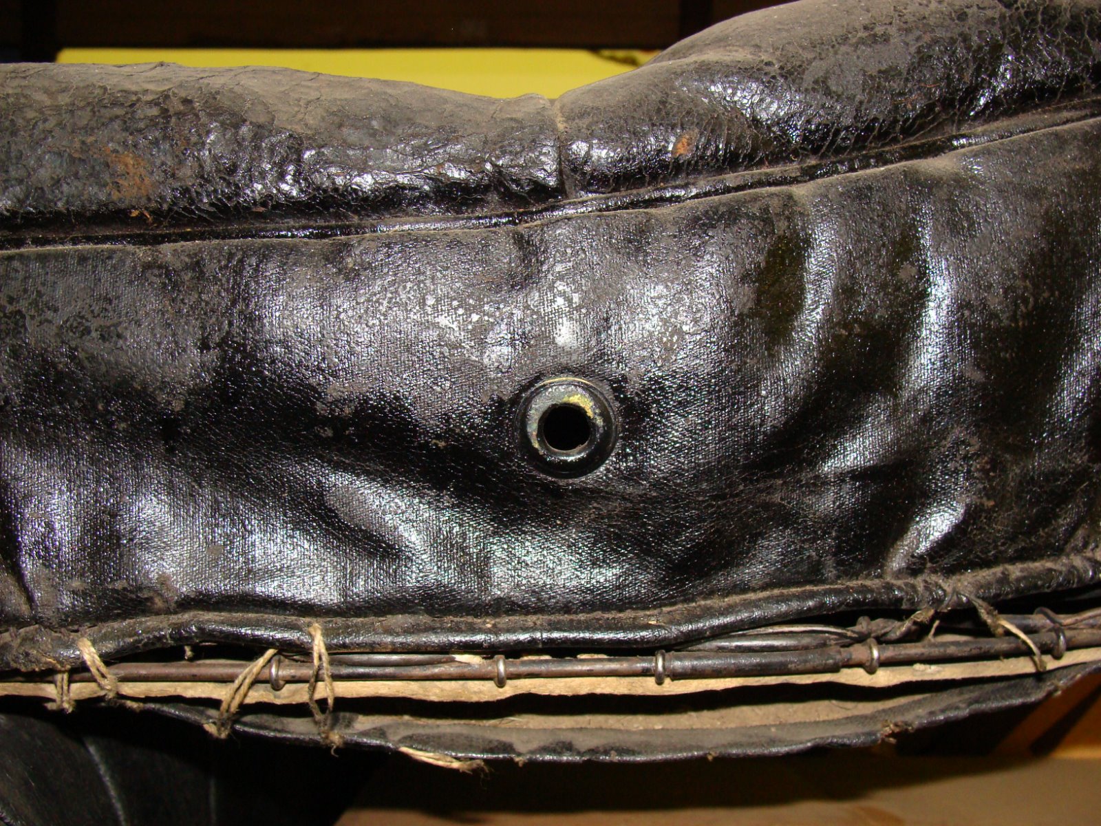

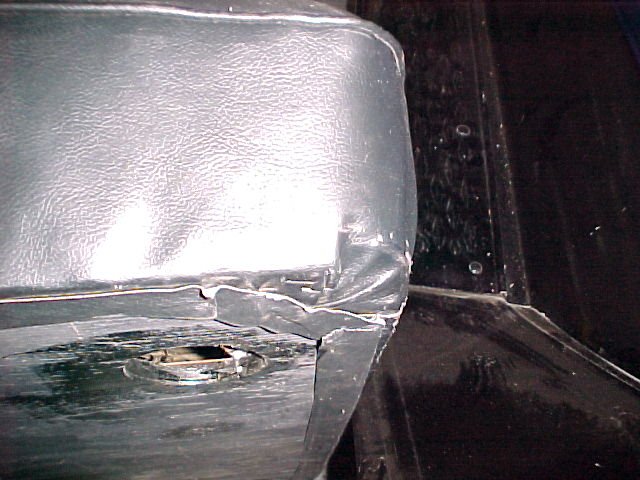

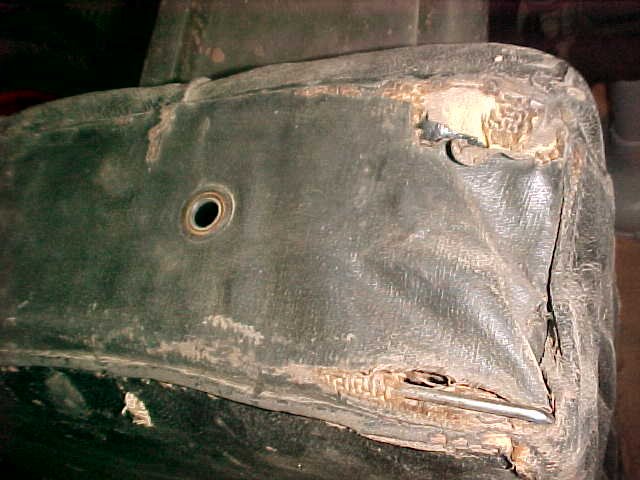

Look on the bottom side of the doors for a body number.
My late 1911 and cars through 1912 used hardboard covered artificial leather on the underside of the springs. The whole assembly was stitched together. Instead of hardboard I used 1/8" plywood and cut reliefs for the body irons. The originals just sat of the irons and brackets.
Here are some pics of originals...
Earlier 1911 cars with the bent-wood frame for the seat springs have notches cut in the wood.
