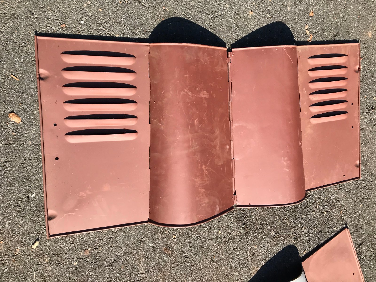

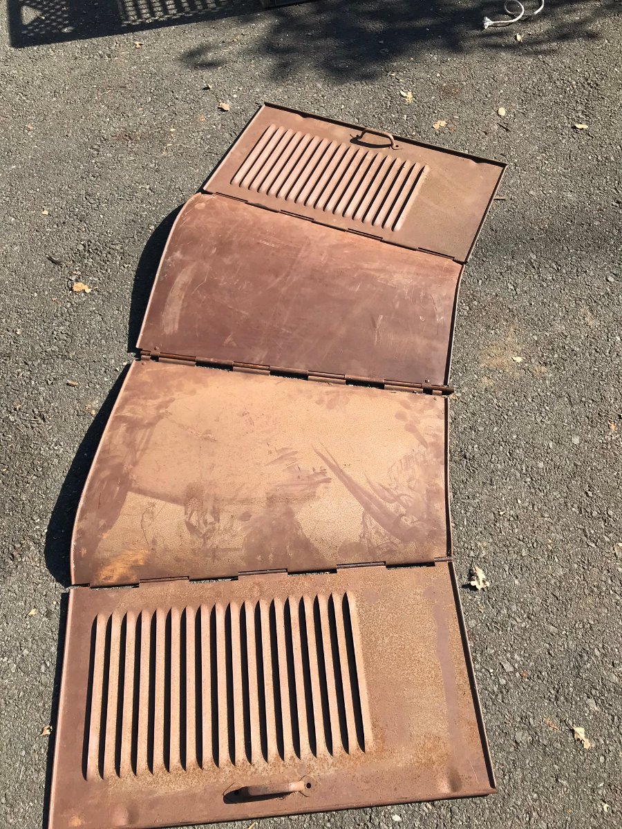

Post by AdminJeff » Mon Sep 09, 2019 8:27 pm
Anyone?
It's a LOT different from this hood
This is like a game of Clue.... I really need a visitor or two to come to Santa Rosa and help me identify half this stuff....
Jeff
D Stroud
Posts: 1015
First Name: David
Last Name: Stroud
Board Member Since: 2011
Re: What is this hood?
Post by D Stroud » Mon Sep 09, 2019 8:32 pm
Jeff, the first(rusty) one appears to be a '26-'27 hood. The second one(primered) one appears to be a repro hood for a '24-'25 high radiator. Dave
Post by Wayne Sheldon » Mon Sep 09, 2019 9:04 pm
David S is right on!
Post by Norman Kling » Mon Sep 09, 2019 9:19 pm
I think David is correct, however, the side panels are on backward. The louvers should be facing out.
Post by dobro1956 » Mon Sep 09, 2019 9:31 pm
I agree with the others. top is 26-27 and the bottom is repro 24-25. I would love to come and play "Clue" with you. but the commute would be a little rough .. :) Just keep posting the stuff here, we will all help figure it out .....
Post by John kuehn » Mon Sep 09, 2019 9:39 pm
Had to look twice but the lovers are indeed on backwards on the 24-25 high hood. The panels are in great shape. In the 24-25 hood pic it looks like the panel in the right corner of the pic is a low hood panel. Maybe!
AdminJeff
Post by AdminJeff » Mon Sep 09, 2019 9:39 pm
This is great. Right down to the backwards side panels! It was a puzzle. There are just dozens of pieces everywhere and Im piecing them all together best I can. I did match the bottom one to my '21, so that wasn't too bad. This guy loved rust colored primer. Better than rust by itself I suppose!

AdminJeff
Post by AdminJeff » Mon Sep 09, 2019 9:41 pm
Good eye. That's yet another set entirely. That's the one I matched to my '21.

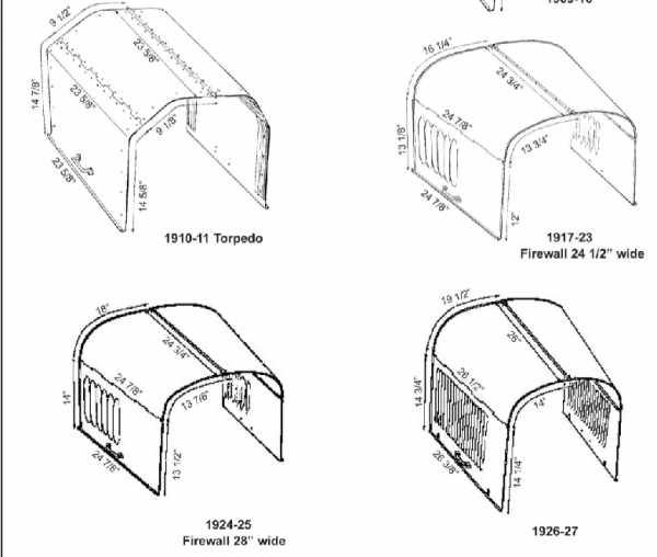

Posts: 6540
Post by TRDxB2 » Tue Sep 10, 2019 12:17 am
Hood dimensions
Post by D Stroud » Tue Sep 10, 2019 1:01 am
Fellers, look again at the '24-'25 hood. The panels aren't on backwards, your looking at the shadows. The dimples for the hood hooks bear this out. ;) ;) Dave
