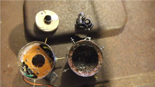

Hello grumpy old people that think money is more important than life.
Now what would be really controversial? An E-timer!
So I made my own. Just to make people mad.
It's an arduino. That they use to teach programming to children.
And a few hall effect sensors, and MOSFETs.
Timer, old versus new.JPG (34.62 KiB) Viewed 5334 times
It runs, it drives.

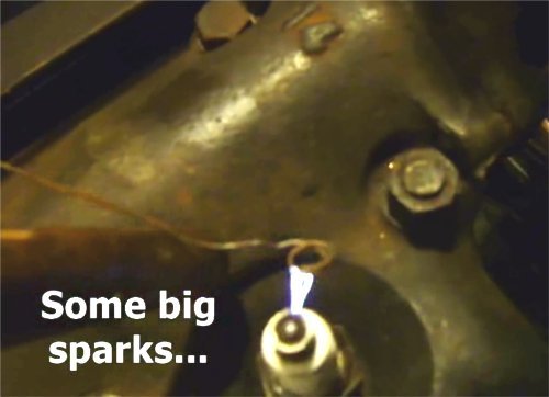

For coils I used old decaying ones that had open secondaries and no points at all. Nobody else thought they'd amount to anything. Work really well after all.
big sparks.jpg (24.7 KiB) Viewed 5334 times
Never ran so smooth.

Excellent! Just curious - why MOSFETs instead of triacs?

Mindless, make sure you run plenty of grease inside that timer like originals. Watch out for infringing on the "Big Company's" patent rights or the lawyers will have fun. Did you disable your magneto? Looks pretty Cool!! Smarter than the ave. T!!
