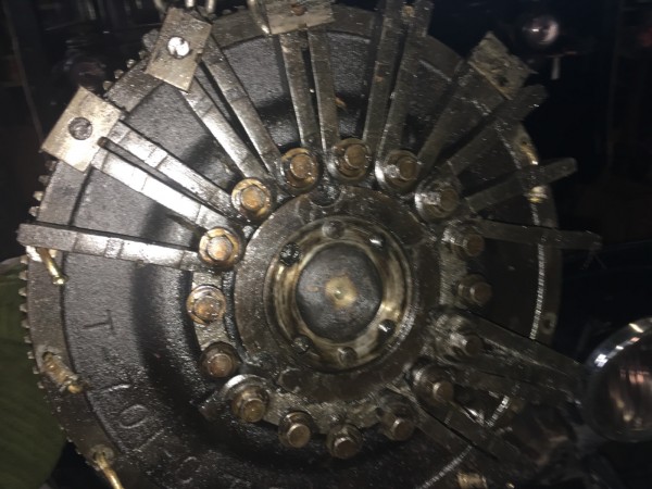

Posted: Sun Sep 29, 2019 8:46 pm
by TonyB
Don’t run it with a washer in the motor because this is the result when a customer did that for 30 minutes☹️
Notice the missing magnets
The pan had to welded and the hogs head had two cracks☹️
