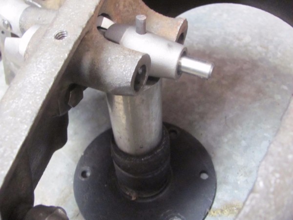

So I had my new kevlar bands on and was attempting to put on the last washer and nut on the last band when the inevitable dropped the washer and nut into the nether regions. But have no fear! I had tied a thread to it for just this sort of problem and proceeded to try to fish it out. To no avail! It was stuck. So after several methods of persuasion and foul language the thread broke. I pulled the plug and drained the oil. Low and behold the nut and washer were right above the drain hole still tied together with thread. But! they seem to be stuck on some sort of grate on either side of the drain hole. They do not seem to be able to come out. What can I do now?

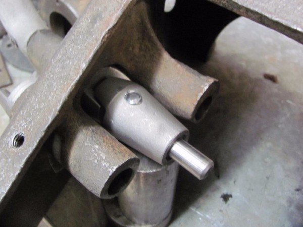

Re: Kevlar-ing along when the nut dropped into nether regions.
Hogshead is off! I was able to rotate the magneto and retrieve the errant nut and washer. Now I am attempting to replace the notch and pedal support.

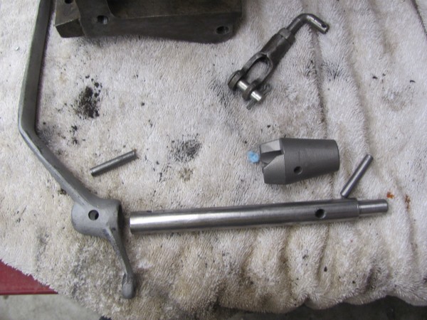

Why are the new notch rivet holes different sizes and the rivet only fits through one side and does not go through the other side?
I cut the head off the old rivet on both sides with an angle grinder and have pounded it a lot with a punch but it is not moving. Is there a way to get the rivet out other than drilling a lot?
Thanks in advance.

I select a punch that is smaller than the rivet body...then select a # drill that is just larger than the punch. Drill both ends of the rivet about 1/3 of the way through. You can typically beat the rivet out with the punch when thus relieved. You MUST support the notch and not allow the pedal boss in the hog's head to be the support for this beating. It can lead to serious damage to the hogs head if you do not support it properly. The small hole allows you to drill through the notch, your shaft, and still enlarge the hole (wherever the drill comes out). If the hole in the pedal shaft is not perfect, your drill will follow it wherever it goes and will still make a clean, round hole in the notch. If not per the original drawing, I still think it is a great idea of the supplier and appreciate it.

Thanks Scott, I read your explanation but am still not sure what the smaller rivet hole in the new notch is for.
- Posts: 6803
Drill it out. Insert rivet. Pein over.

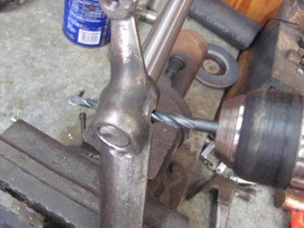

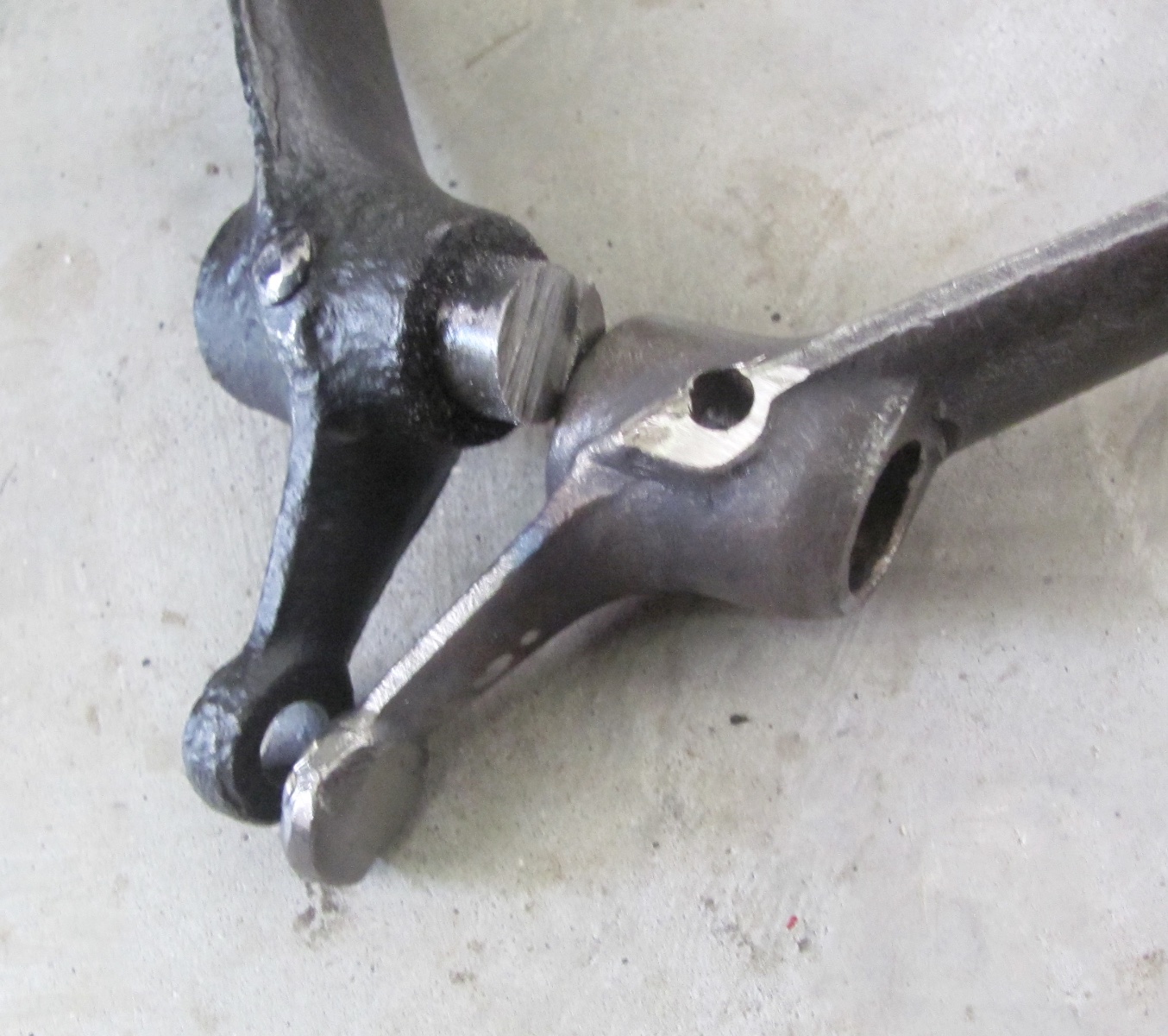

Drilled the notch a bunch on both sides with a drill press. I have not hit the shaft yet. I have it on an anvil now so hopefully it won't get damaged. Hitting it with a 5 lb sledge and a punch. Tried hammer and punch on both sides. Not moving at all. What else can I try?

Easy way is to completely restore with new parts. IMO, cut off the old low speed shaft near the pedal, and then place a new shaft. Works best too if you replace the low speed support. Then with new notch, you have it all done factory.
Trying to drill out the old rivet in an old shaft can lead to an oversize hole, and the support can get loose. Lots of pedal pressure on those parts, rivets need securing.
Parts pre-drilled and tested on the bench before final riveting, that low speed notch has smaller pilot hole, used to align as you use a 1/4" drill to do the shaft and notch together, makes a clean straight hole for the new rivet.

cannot tell from your picture, but am hoping you are actually on/in the rivet.
sometimes they need heat at this point to encourage the pin to separate from the shaft.
followed by more force from hammer and punch
start this process by filing the notch and pin face, so that the outline of the pin can be definitely determined to ensure you are drilling IN the pin and not 1/2 in the pin and 1/2 in the notch. After filing and heating some, you should visually see an obvious ring/separation of the pin/rivet vs the notch which will ensure you're drilling where you really want. From the picture it is impossible to verify what you've drilled and what is being struck by the hammer/punch.

Thanks Dan, I think you are right. This is a mess and a new shaft and new pedal pin (I went ahead and bought 4 for 25 cents each) are $21 delivered. I have the clutch pedal support and had planned to change that out too including doing the o-ring trick for oil leaks. It is going to be a photo finish though. I am wanting to participate in the Texas T party this coming week. -- IV

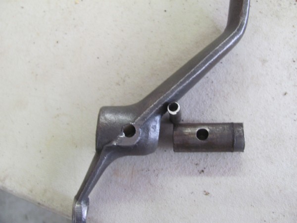

Still wondering why one hole of the notch is smaller than the other and the rivet does not go through?
- Posts: 4087
The maker puts a little note in the pkg. At least one in the last notch received. Just a mention that one side isn't drilled to rivet diameter.
The idea is you place the notch on the shaft, align to the shaft hole, and then drill thru the 1/4" side of the notch, into the 1/4" hole of the shaft, and then exit into the 'smaller' hole on the other side.....keeps the drill on target. You must have a correct size and straight hole thru both the shaft and notch, to accept the rivet, to have a very tight rivet job.
- Posts: 6803
I have found that (many of) the repro shafts have the pedal rivet hole and the notch rivet hole to be too close to each other by up to 1/16". This often causes the pedal to bottom out on the hog's head well before the pedal has rotated (and shifted over) fully.
I do not doubt that this has led to some mistaking the pedal bottoming out, for a "firm pedal" when in low. I believe that this may account for some of the slipping/overheating damage seen which has been on transmissions. Owners believe the band is tightly down on low, when it is nowhere near locked up properly and is simply bottomed on the hog's head boss.
I got tired of fixing them (shafts) and now make my own, as I was loathe to modify the hog's head to accomodate an incorrectly made part.
Mock everything up prior to peining the rivets and ensure full/proper rotation can be had. Some hog's heads will accept this minor discrepancy and others will not.

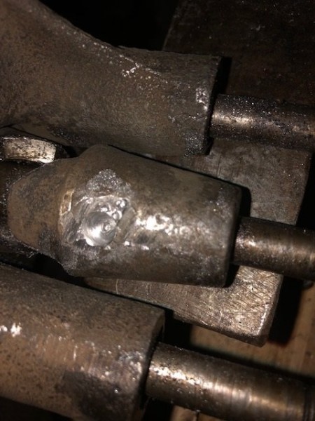

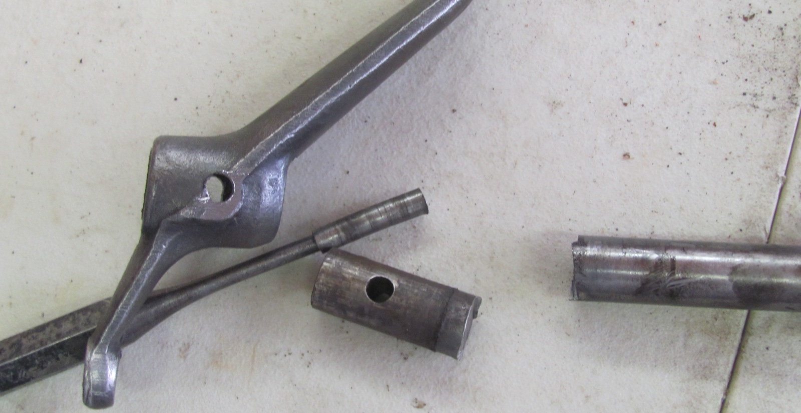

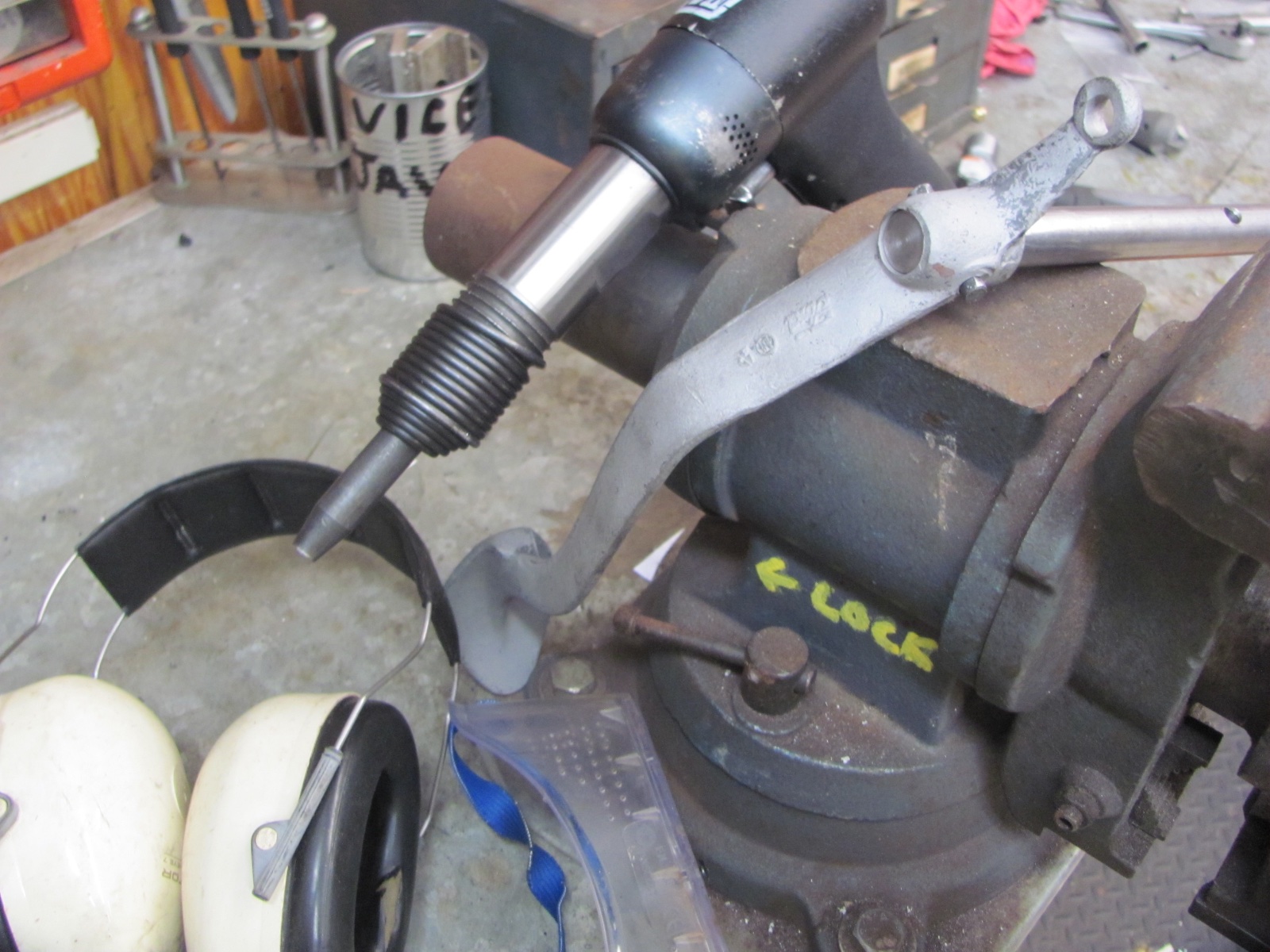

The practical way IMO, is to carefully grind or flat file the surface off the old rivet head, to expose a circle of the rivet shank in the pedal or notch. Then using some penetrate oil, identify the outline of the rivet shank, and use a center punch to mark for the drill.
Select a drill size smaller than the rivet shank, and drill down a depth to about 2 -3 diameters of the rivet. Use a drift punch just less than the drill size, and with swift hard blows of heavy mallet, drive the rivet out.
Doing this work on a bench, with a bench vise to secure for good hammering is IMO essential. Trying to hammer and drive a rivet from a wiggling low speed shaft still in the hogs head is just too much effort or satisfaction of the end result.
Cut the low pedal off, and use a new low speed shaft.
Low pedal cut off, note surface ground to be able to locate the center of the old rivet.
Driven out rivet, still with the drift punch in it.
View of old rivet with hole made by the drill bit. Note it is off center some too, that will happen most times, hard to be dead center. Another reason to use a new low speed shaft.
Align drilling the hole in the pedal to the new shaft so the new rivet will go straight in.

Dan that is an outstanding solution that I went ahead and ordered a new shaft hopefully arriving tomorrow. However, since I am going to Texas T Party Friday I cheated and took my hogshead to a machine shop. Forgive my weakness. They drilled out the mess I had made, filled in the oversize hole with welding then re-bored it, even put the notch and new clutch support with o-ring trick back on neat as you please. For more money than your way. But I will do it your way the next time. So the bands are in, the nut and washer retrieved, the cams are new, I've cleaned up the mating surfaces which where dirty as could be and I am going to attempt to put it all back together tomorrow and test drive.

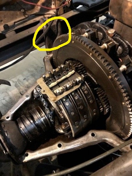

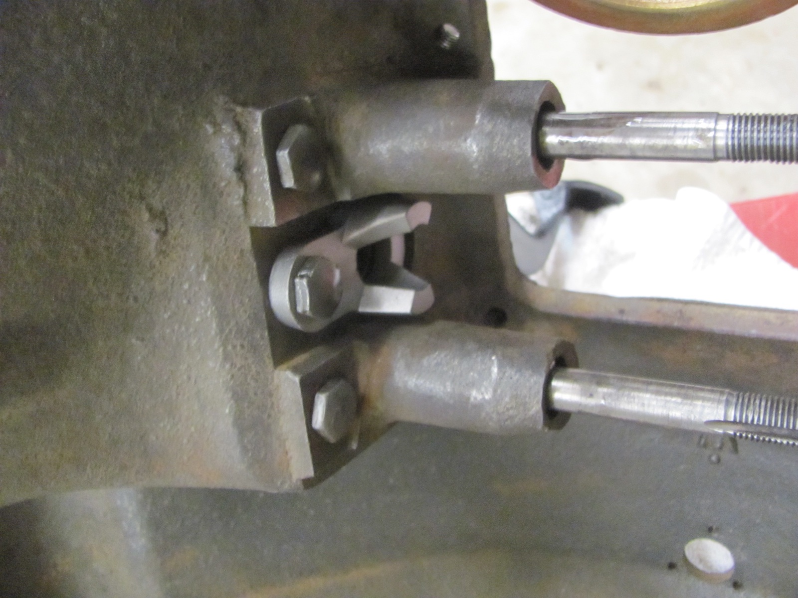

It looks like you are missing the wood block (at least the left one) between the pan ear and frame. Maybe the nut is hidden in the shadows but I don't see one.

Probably isn't a wood block there. What is the wood block for? -- IV

They provide support/reinforcement.
My car was missing them too. I bought a couple from Lang’s and will be installing them this weekend.

Possibly why my frame was bent. What is Lang's part number for it and more or less where does it go?
