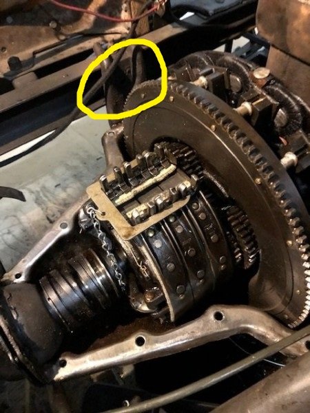

Re: Kevlar-ing along when the nut dropped into nether regions.
Posted: Wed Oct 09, 2019 7:42 am
by Mark Nunn
It looks like you are missing the wood block (at least the left one) between the pan ear and frame. Maybe the nut is hidden in the shadows but I don't see one.
Posted: Wed Oct 09, 2019 11:38 pm
by ivaldes1
Probably isn't a wood block there. What is the wood block for? -- IV
Posted: Thu Oct 10, 2019 12:04 am
by ivaldes1
Possibly why my frame was bent. What is Lang's part number for it and more or less where does it go?
Posted: Thu Oct 10, 2019 7:59 am
by Mark Nunn
The blocks fit inside the frame rails behind the pan ears. A horizontal bolt goes through the outside of the frame rail, through a hole in the block and a hole in the pan ear.
IV wood block.jpg (71.13 KiB) Viewed 9829 times
The block part number is 3083. If you buy the bolt kit, Lang's part number is 3083BS. Don't get a bolt kit from Chaffin's. I did this summer and the bolts were too short to install cotter pins. The small bolt was 3/16" too short!
