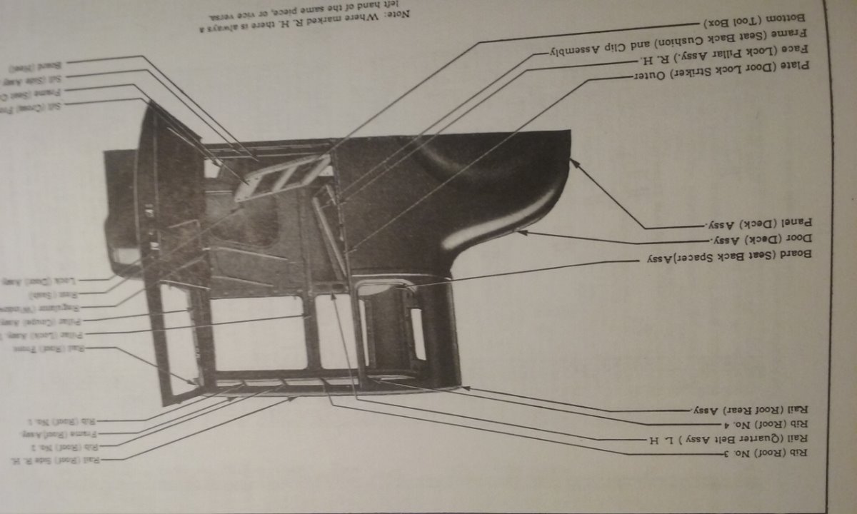

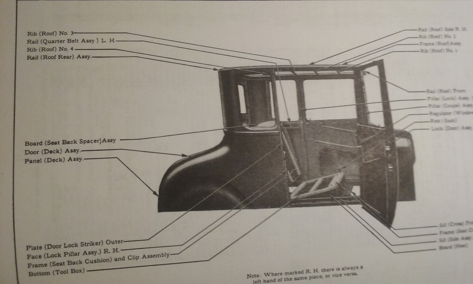

Not sure I know what you mean by a coupe seat back panel. There is no metal panel directly behind the seat. The seat back springs mount to a wood frame that is visible through the trunk. There is a package tray that fills the gap between the top of the seat back and the rear window. Several versions over the years, most were metal with different amounts of wood, some were all wood. All were cloth covered. If that is what you need there are no repos, and not the sort of thing you find used. The metal tray has a lot of bends that making a new one from scratch will be a challenge...particularly if you do not have a pattern to copy. But you say the roadster has one, so the roadster does not have a package tray, the piece behind the seat on a roadster is the back of the body. The coupe is a very different body than the roadster.

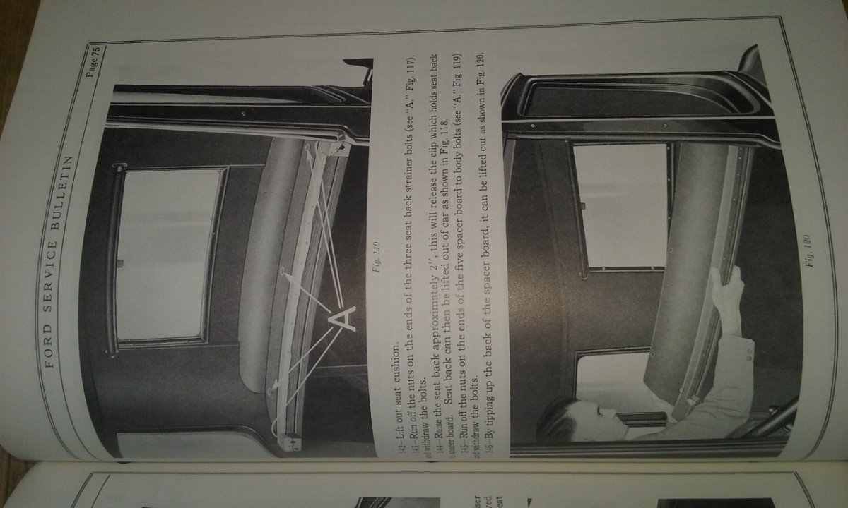

From the Ford Service Bulletin.
