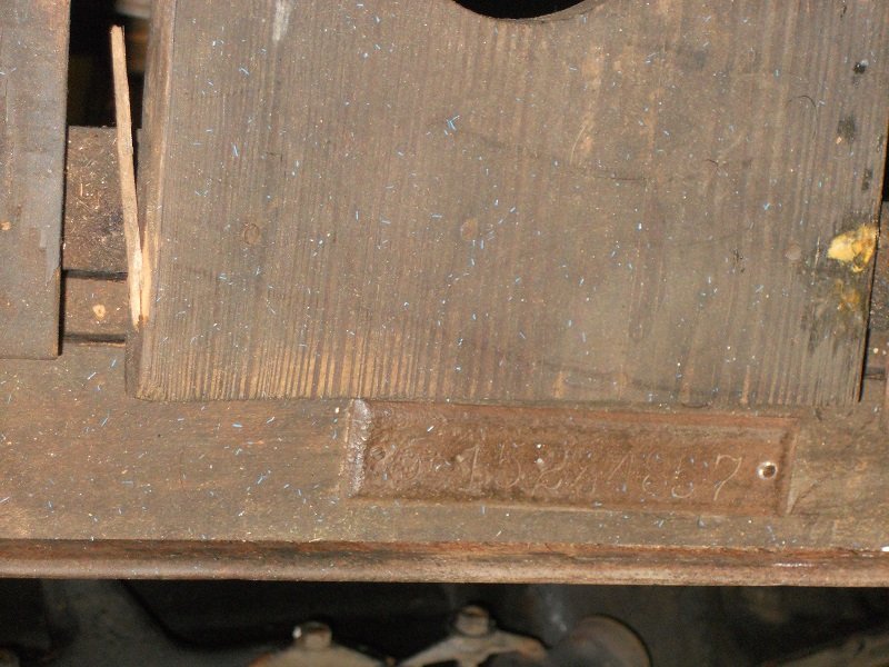

The body tag shows 5 15 224857 and is easier to read when you can change the angle you look at it.

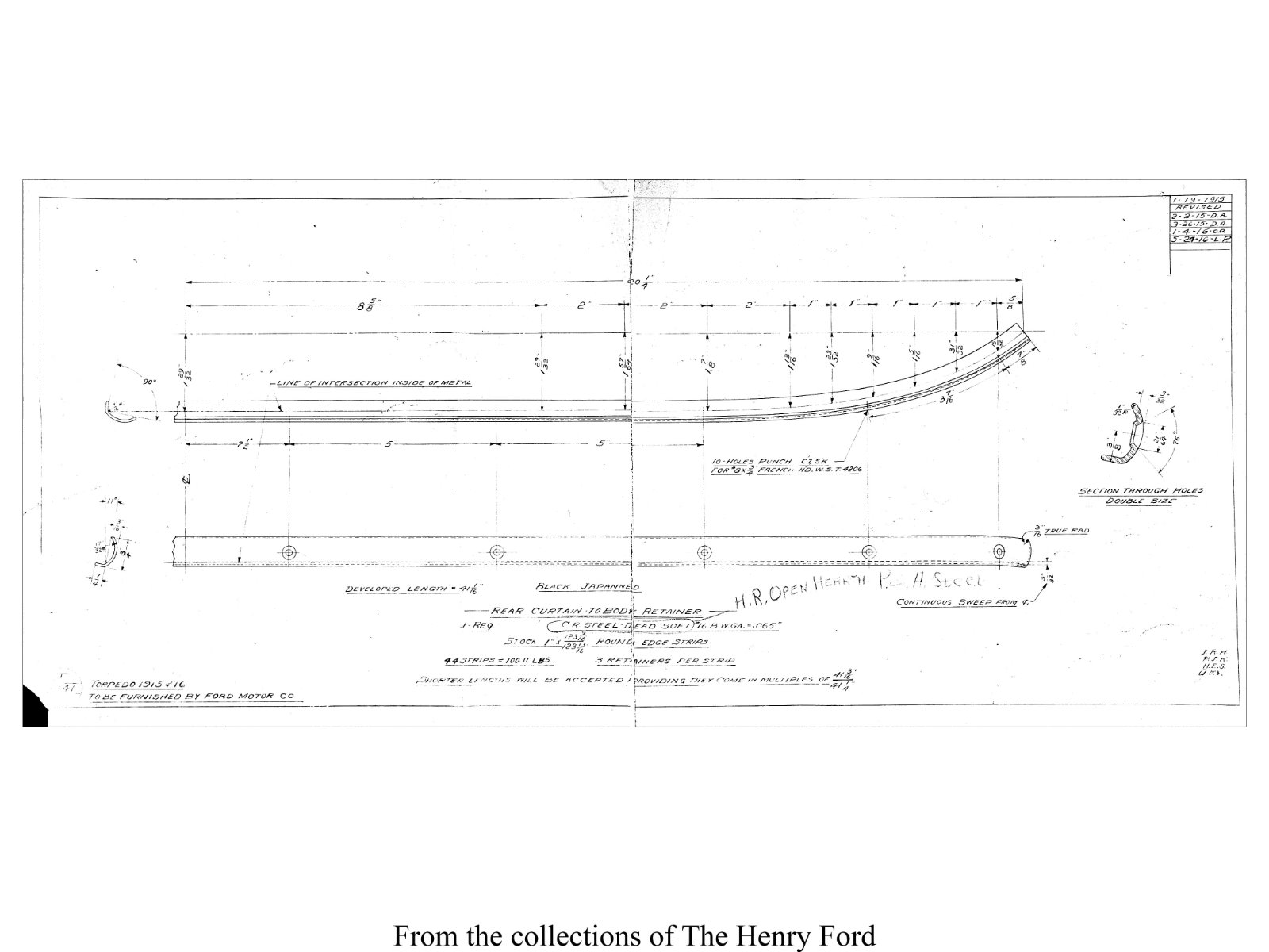

It is looking good. Is the end roll of upholstery leather?
The back of the rear curtain is trimmed with a metal edge piece, not welt strip.
Keith

Thanks for answering my next question Keith! My runabout has that metal retaining strip, but the previous restorer sandwiched it between the upholstery back and top. I was wondering if it actually mounted like you showed in the picture that you posted.

I had also emailed Mike at Classtique's, and he confirmed that the metal strip goes on the outside. I had sent him a picture how mine was installed when I took it apart, and he said that he'd never seen it installed that way.
