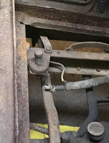

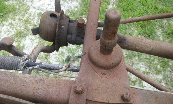

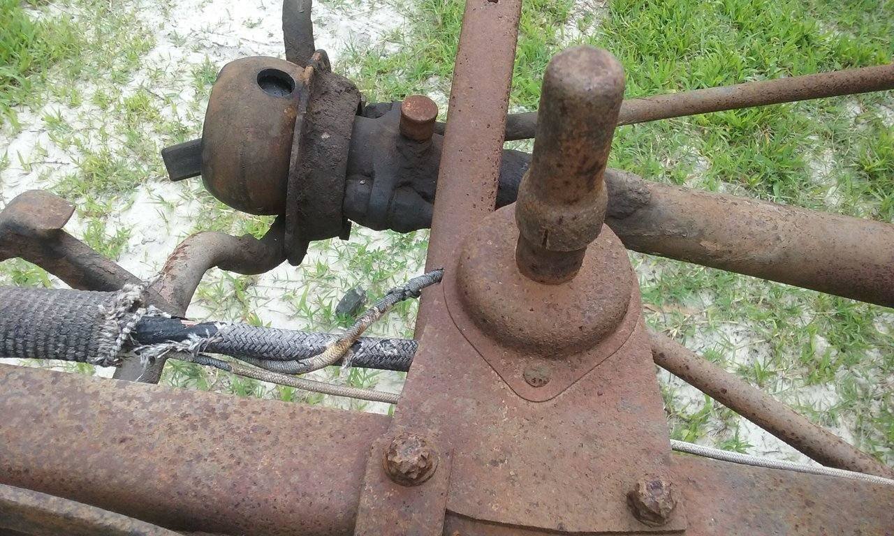

Re: MOUNTING STARTER BUTTON
This is a photo I collected about a year or two ago from a T truck.
Vern (Vieux Carre)

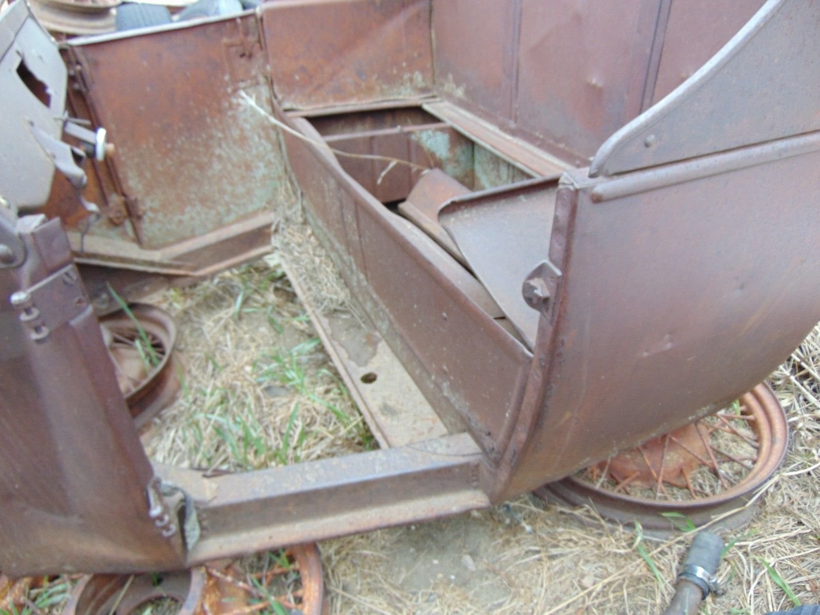

- Posts: 4084
Scott is right.
The TT starter switch is on the frame in the same place as the T. Otherwise the hole in the heel panel for the button wouldn't fit!
One of the bolts that holds the running board brace strap is used for one side of the starter bracket.
Click on photos to enlarge
Note starter button hole on heel panel of C-Cab open body for the later TT's.
None of the pictures sent are like mine, I don't have any predrilled holes in the frame and the cross brace to the rear running board bracket runs higher across and curves down at the frame rail and then is riveted to the frame and then continues on. MY truck being a 19 open bodied does not have the hole for the switch in the body. I am going to drill two holes in the top frame rail at approximately the same location as noted in the pictures. This will leave about 3/4" sticking thru. thanks for the pictures when I get mine out of my garage i'll post some of mine.
