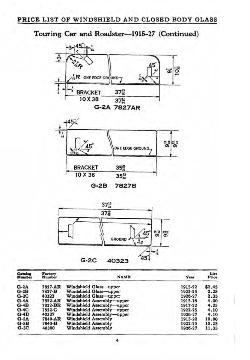

Check your glass dimensions and compare to this drawing if you are unsure of what you have.
