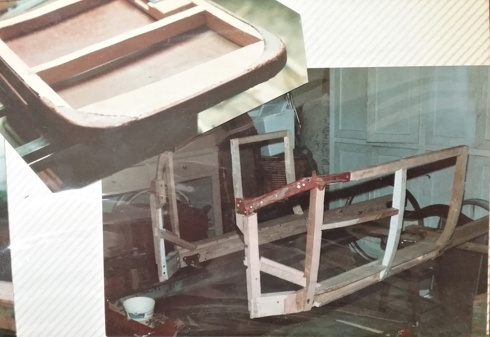

I bought a set of wood plans from Mel Miller when I rebuilt the 1917 Touring in the late 1980’s. It was quite successful though I did end up with pile of sawdust about 12” high. So they were NOT drop in. Later I contacted Mel to see if wanted to sell his business and received a not interested reply. A couple of decades later Leon was selling plans which he told me he copied from actual T bodies. Of course Leon has now passed, so who knows what will happen next.
The major problems I found with the plans is that they were two dimensional while the required wood is three dimensional. Many pieces, especially the vertical, have twists in them and are tough to replicate. After wasting some good expensive wood, I made trial pieces out of cheap 2x4’s. I never did get the shape of the rear doors correct
I kept the plans for years but the blue prints faded and became unreadable. I also kept the trial pieces but the whole went to the dump late last year
So I can offer little, except encouragement.
