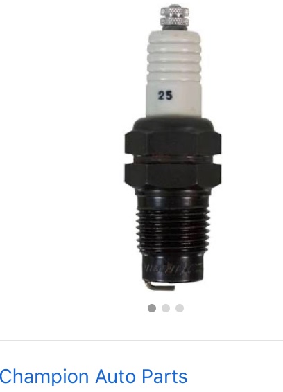

Champion 25 is good long reach for Model T cyl head, better than Motorcraft 1/2” plugs. Just take care to finger tight the terminal nut, electrode is glued. But same is true to preserve any plug terminal post, just snug the nut with finger to lock on plug wire terminal, hold nut and then backward twist the wire terminal to tighten. Never use pliers!

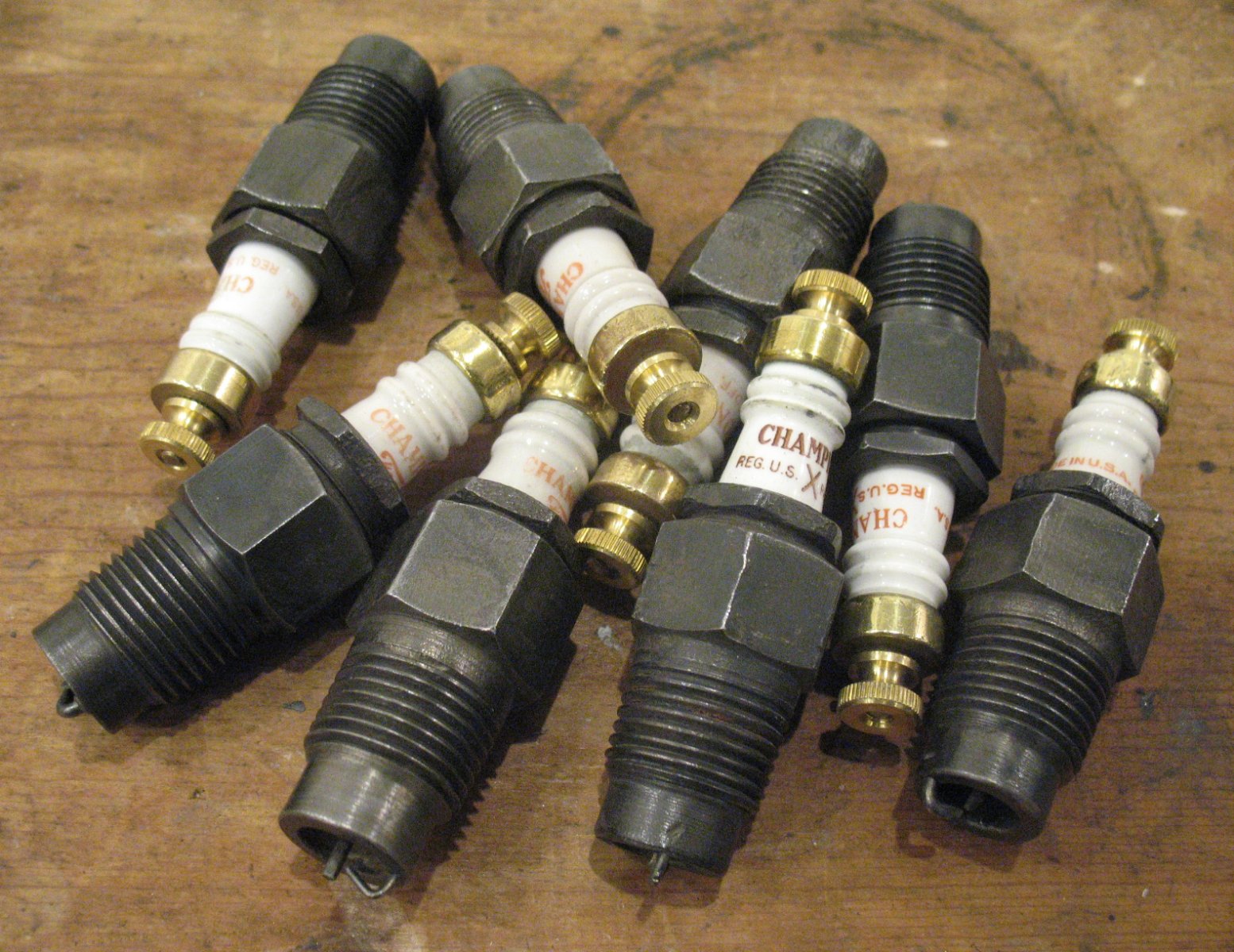

Original Champion X plugs from the teens and twenties are often very good after you clean them up, and can often be found at swap meets for $5 each or less. They sometimes also turn up on eBay.There have probably been over a hundred brands of plugs made for your T, and some of the old ones as as good today as they were a hundred years ago. I'm currently running a set of the old Splitdorf ivory plugs, and they're fine. On the other hand, the Splitdorf green plugs look neat but rarely work.
I often use original Champion X plugs because they are plentiful, cheap, and functional. They were Ford OEM equipment, so they outnumber other old plugs by a lot. Here's a page on those: http://dauntlessgeezer.com/DG95.html

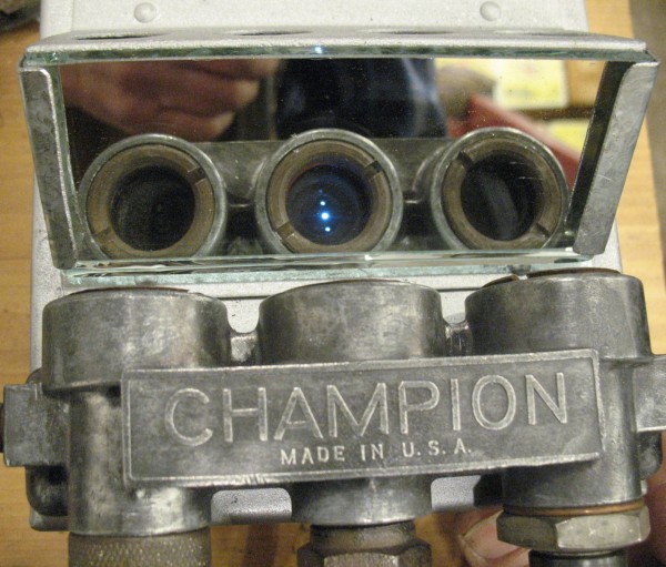

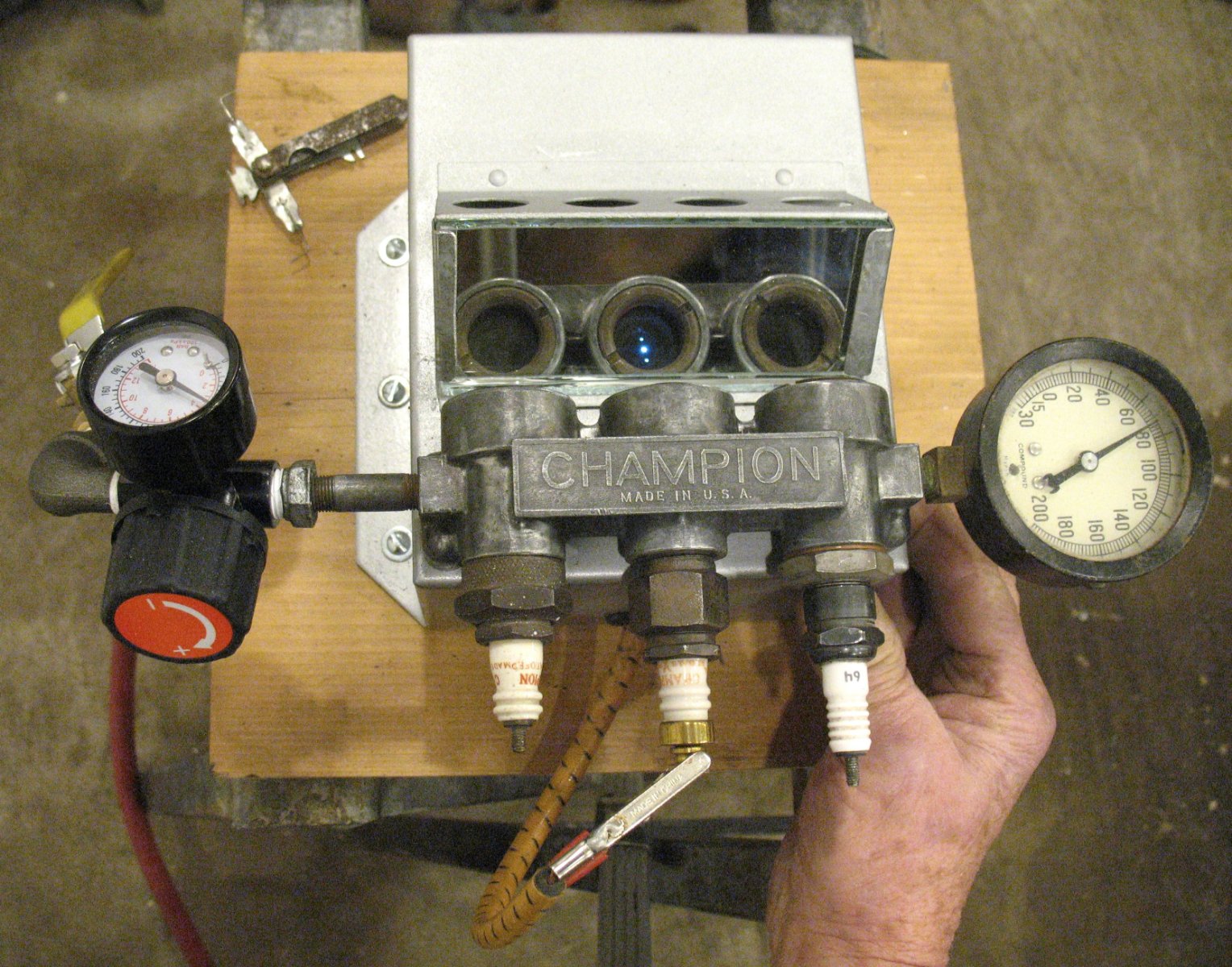

As John Regan has occasionally reminded us, laying the plugs out on top of the engine isn't a real spark plug test. It doesn't show you whether the plugs actually work in the car under compression. A plug tester is the tool for that.
70 psi is more pressure than you're likely to have in a Model T. If you get a good spark there, it's good to go.
The center dot is the actual spark. The two little ones are reflections.
A lot of old plugs clean up very nicely.

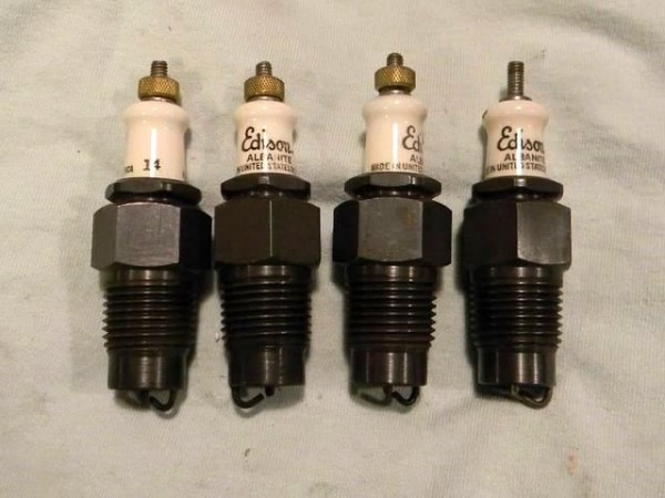

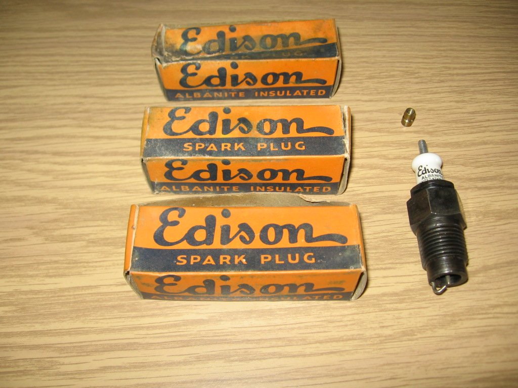

Ok, so let's hear from those using the Edison 14s. I was lucky enough to find a box of ten NOS of these but have yet to try them. I'm running the Champion Xs now.

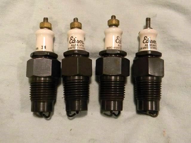

The engine in my 1924 has a stock high head and nominal compression ratio aluminum pistons. I run a Truefire ignition and gap my plugs to 0.030". The Champion X plugs I originally ran fired OK, but would look sooty after a few hundred miles when I took them out to inspect them. I switched to the Edison 14 plugs and they stayed clean, which implies to me that the Edison 14s are a hotter heat range than the Champion X. After inspecting the Edisons a few times, I finally decided to just leave them in and have run several thousand trouble free miles without touching them. I have not run into any pre-ignition or after-running issues that might be indications of too hot a plug.
Am I running my carb (Kingston L4) too rich? Possibly, but I have tried leaning it out and when I do I start getting lean misfire problems at Idle.

Mark and Marty... I do run a set of Edison for teens in r26 runabout and also very pleased with their performance. We also installed a set of Edison 14's in the 22 touring at the Edison estate in West Orange New Jersey, and also no problems noted. I have always set the Gap to 0.025", and also observed by Mark the Edison 14's do run a lot cleaner then the champion x plugs. Availability of NOS Edison 14's is getting very scarce. If you do find used they do clean up very good and will give good service.

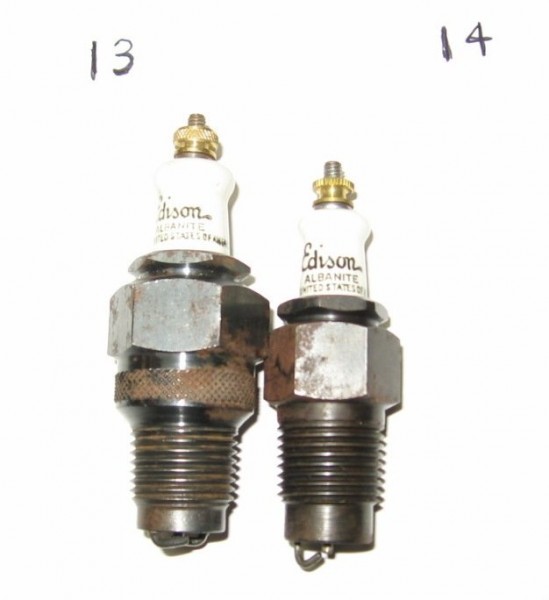

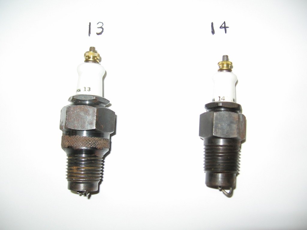

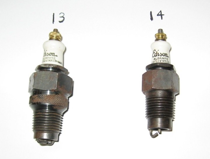

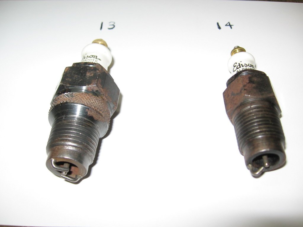

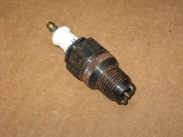

Edison 13s will also work in a T, but they are even harder to find than the 14s. The 13s are physically larger and have dual ground electrodes. I have no experience with how they run.
