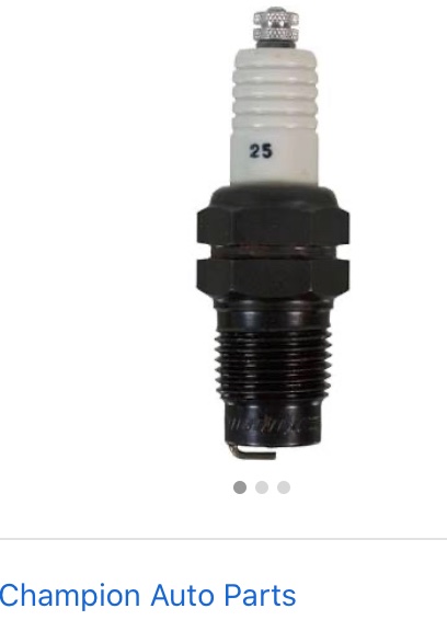

Champion 25 is good long reach for Model T cyl head, better than Motorcraft 1/2” plugs. Just take care to finger tight the terminal nut, electrode is glued. But same is true to preserve any plug terminal post, just snug the nut with finger to lock on plug wire terminal, hold nut and then backward twist the wire terminal to tighten. Never use pliers!
As for adapters, IMO, they keep the plug too high, poorer ignition, you want the spark deep into the compression chamber.

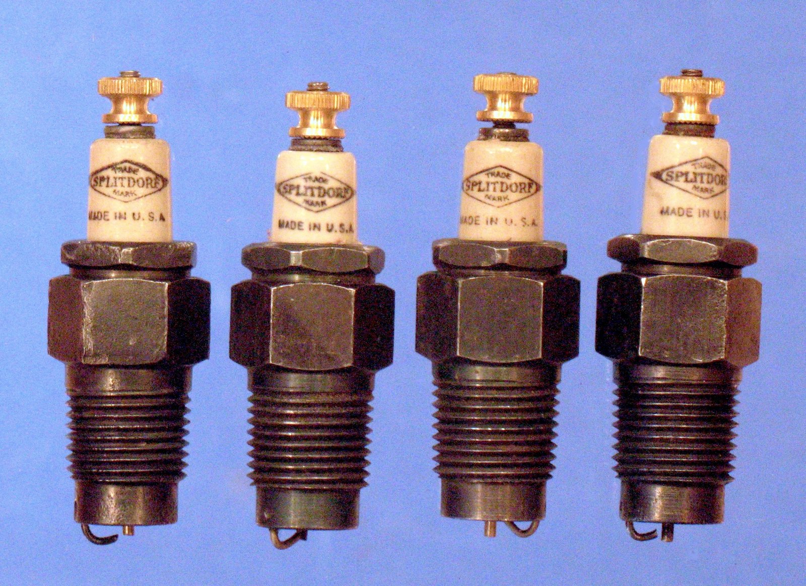

Original Champion X plugs from the teens and twenties are often very good after you clean them up, and can often be found at swap meets for $5 each or less. They sometimes also turn up on eBay.There have probably been over a hundred brands of plugs made for your T, and some of the old ones as as good today as they were a hundred years ago. I'm currently running a set of the old Splitdorf ivory plugs, and they're fine. On the other hand, the Splitdorf green plugs look neat but rarely work.

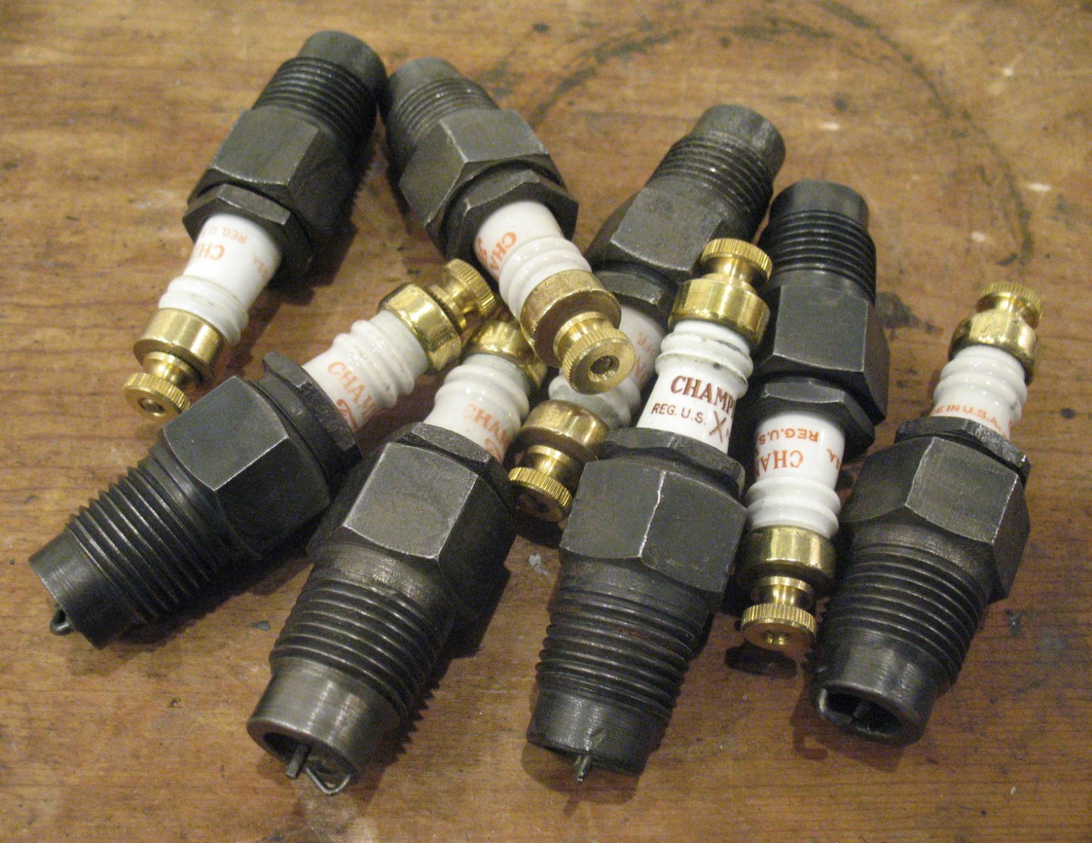

These are working OK for me.

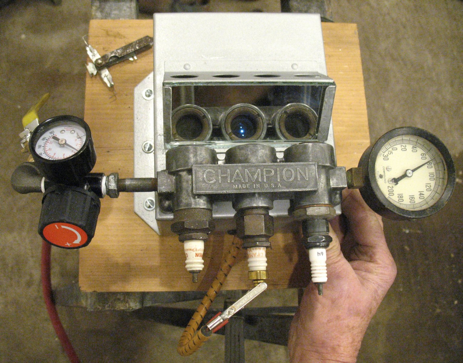

As John Regan has occasionally reminded us, laying the plugs out on top of the engine isn't a real spark plug test. It doesn't show you whether the plugs actually work in the car under compression. A plug tester is the tool for that.
70 psi is more pressure than you're likely to have in a Model T. If you get a good spark there, it's good to go.
A lot of old plugs clean up very nicely.
