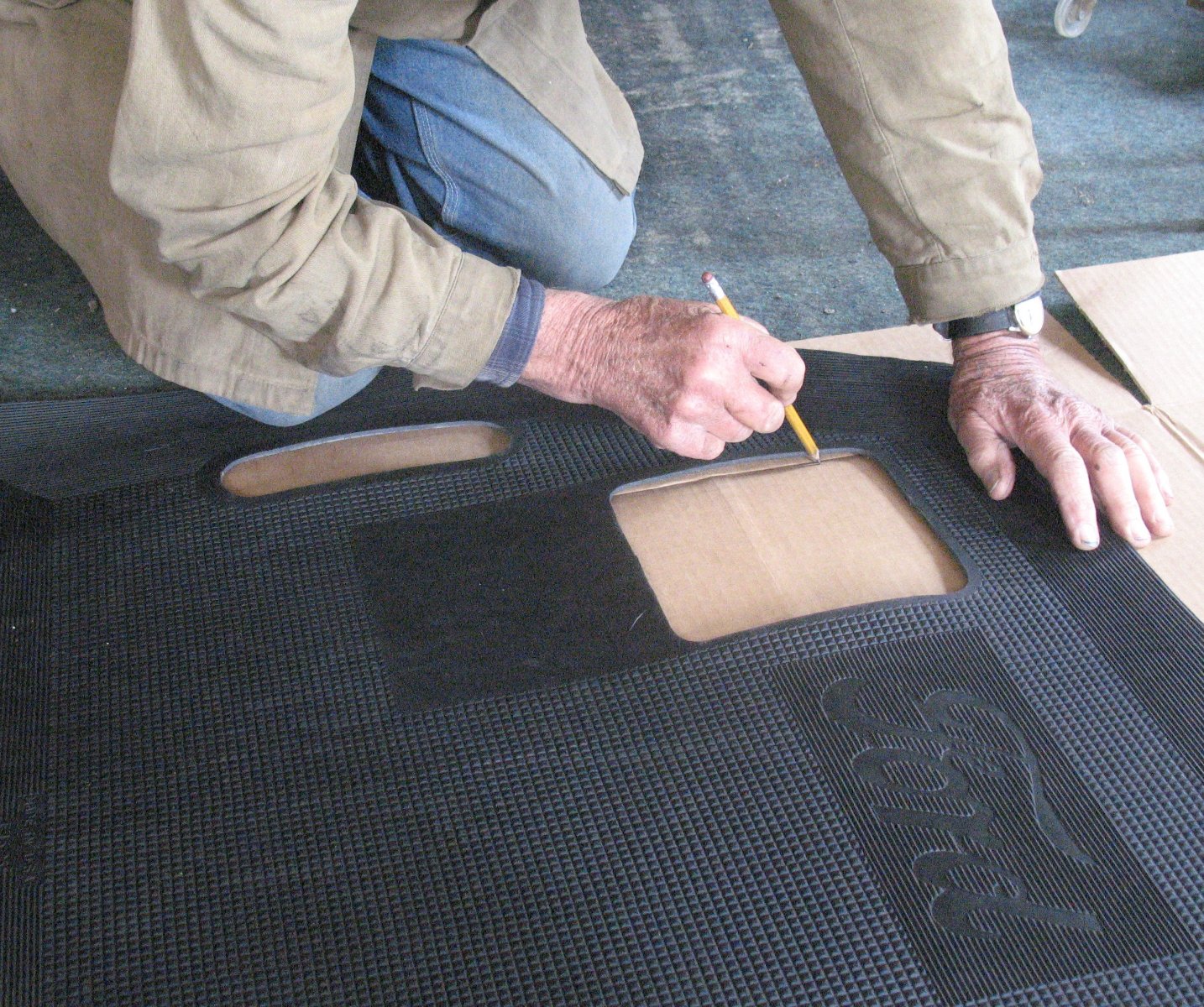

I've never had a floor mat in the runabout, so last week I bought one and today I installed it. The mats are made a little oversize so they can be trimmed to fit various years from 1915 to 1924. This mat is impressively thick and heavy. If it's good rubber it should last a long time.
The materials needed for the job are cardboard and tape. A fry case will suit. It's free.
Make the main body of the pattern by tracing and cutting out the pedal and lever holes.
Align the pattern with the lever and pedals and tape it in place.
Lay on smaller pieces that fit the outer edges of the floor and tape them to the main body of the pattern.
Align the pattern with the mat's pedal and lever holes and trim off the pieces of mat that stick out.

Mat installed and ready to go. I didn't have to trim off very much.
