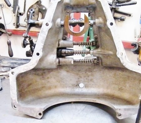

Hogshead off. It's such a pain of a job, I would suggest relining the bands with kevlar linings at the same time.

No it’s not real easy to remove the transmission cover BUT it’s a job that every T owner ought to do or at least try to do.
Once you do it one time it’s something you will be glad you did.
And while you have it off replace all the pedal cams which are available and install Kevlar bands. If I can remove a transmission cover anybody with any mechanical aptitude can do it.
And you need to peen both sides of the slow speed cam when replacing it. And you can’t do it very well unless the cover is off and on the workbench and something under the rivet to be a backup where it’s peeled. Just the way it is

The answer is yes! Easy to do if you are young or agile. Just be careful not to get oil or grease on the upholstery. Pull the seat cushion and cover the door panels. Loosen the two bottom bolts at the universal joint a few turns and take out the two top bolts. Block the rear wheels so they won't roll forward and then push the car forward as far as you can and block the front wheels so they won't roll back. This will pull the universal joint back a bit so you can loosen the fourth from the hogs head. Pry back the fourth main a fraction of an inch. Then remove all the bolts which hold the hogs head to the engine and crankcase. When you remove the two bolts between the top of the hogs head and the block (on a 26-27 block) you might find some shims between the hogs head and block. When you put things together replace the exact amount of shims in the same place as before because they help hold the 4th main in proper alignment with the block. Then just pry the hogs head loose and raise it Lift it off.
Putting it back on is a different thing. I like to take strong string to hold the band ears together. This will not cause as much problem than wire if it should accidently be dropped into the crankcase. Do this before you install anything. Place the gaskets and felt with gasket sealer. Be sure to get the clutch yoke in the proper slot. After you get the hogs head in place, you can cut the top half of a gasket which goes between the 4th main and hogs head. Remove the blocks at the wheels so the universal joint will go back in place. Start tightening in the middle of each side and work toward the ends. Be especially careful when tightening the bolts at the ends of the hogs head next to the block. They are easy to break the hogs head. Tighten as you would with the head bolts a little at a time starting in the center of each side and working toward the ends until they are tight. After you get the hogs head in place and tightened, put rags along both sides of the transmission. Cover all areas where you could possibly drop a spring, nut or washer and then pedals springs washers and nuts. After you get the nuts on the pedals remove the string around the band ends. After everything is in place, you can remove the rags and make your final adjustments. Don't forget to wire the two bottom bolts at the u joint.
