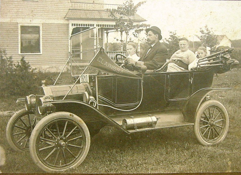

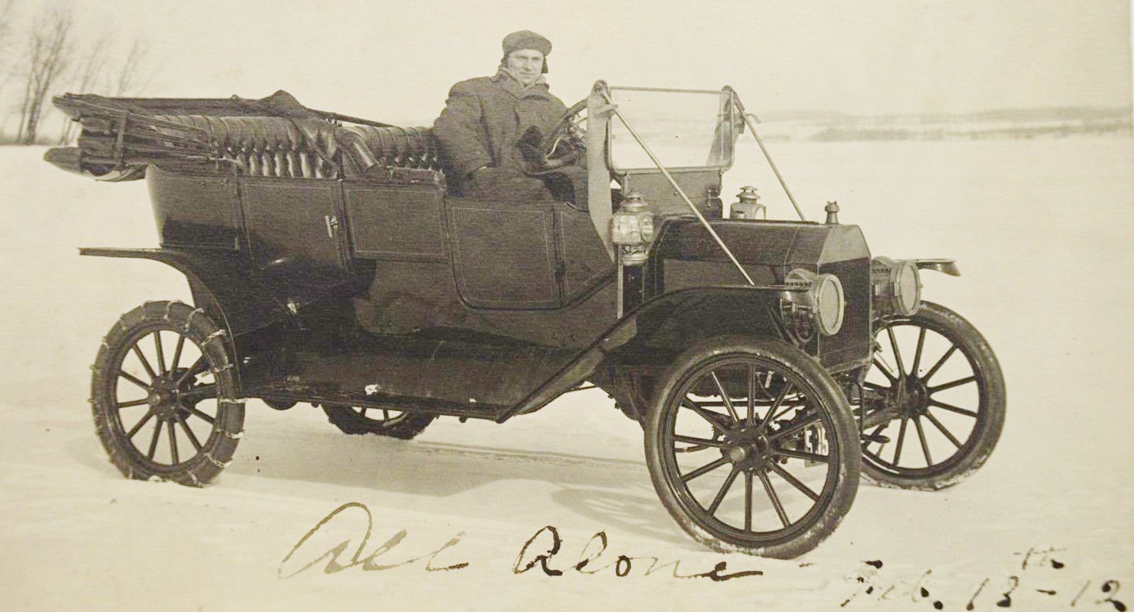

Here are some examples of 1912 touring cars
Unfortunately I was not able to find any modern pictures of restored 1912 cars with correct pin stripe and fore-doors in tact.
