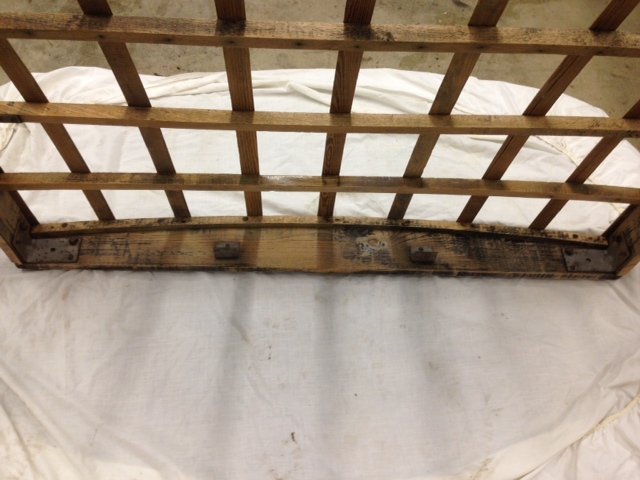

what are these bolts for, side curtain storage brackets?

by JunkyJud
They are the top, center bolt for the rear curtain brackets. The other two lower ones are wood screws.
