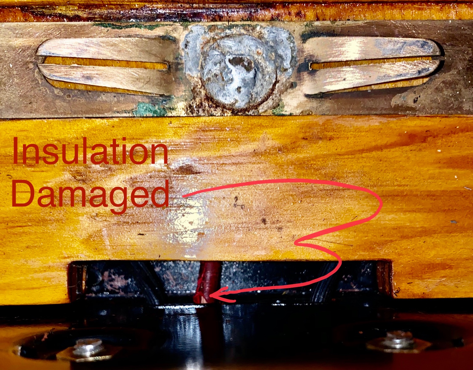

Post by MadMax » Wed Nov 27, 2019 1:30 pm

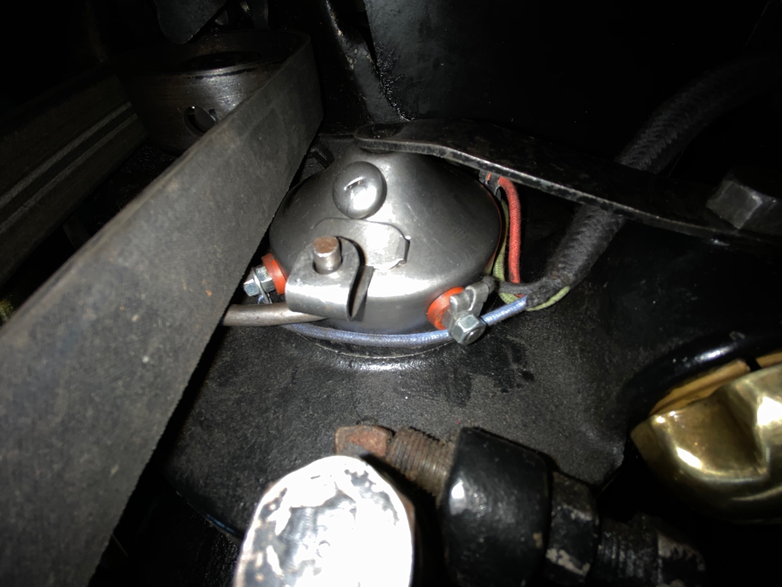

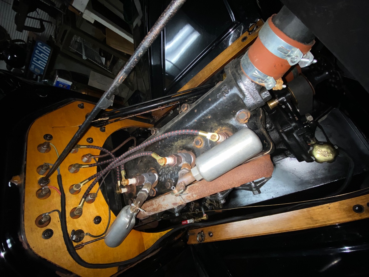

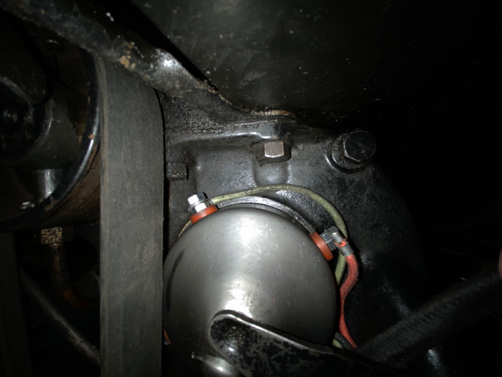

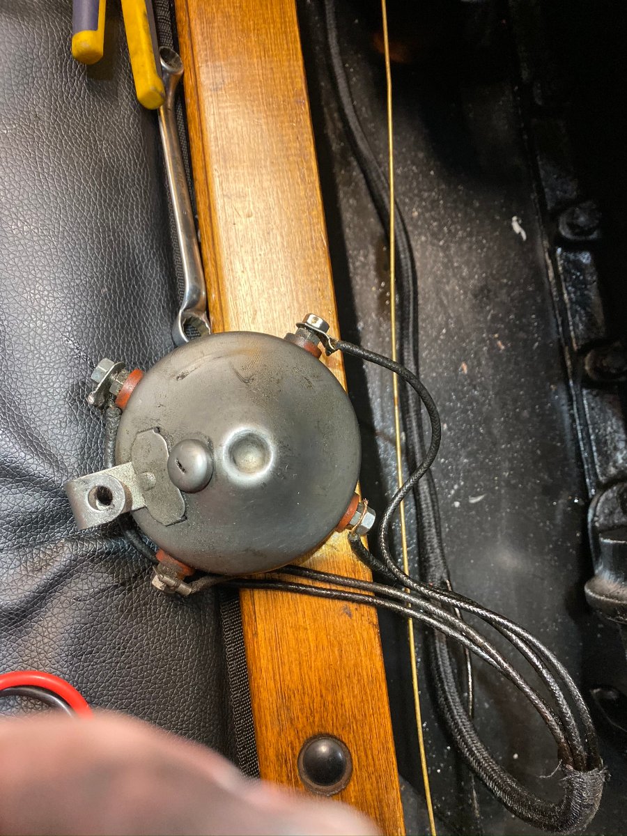

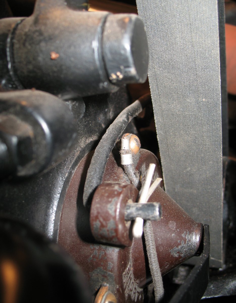

Here are those photos...
Not sure why they are rotated, but if you click on them, they will show correctly.
That last one is showing the wiring coming through the coil box and a nick from the insulation at the penetration.

You may have already checked this out but make sure the timer case terminal wires are not touching the block or when the timer is advanced they are hitting the spark advance rod.
If the car was running pretty good and wasn’t really missing bad it would seem that when you changed the wiring something is getting grounded or not making a good connection. Or so it would seem but not always true. Good luck!

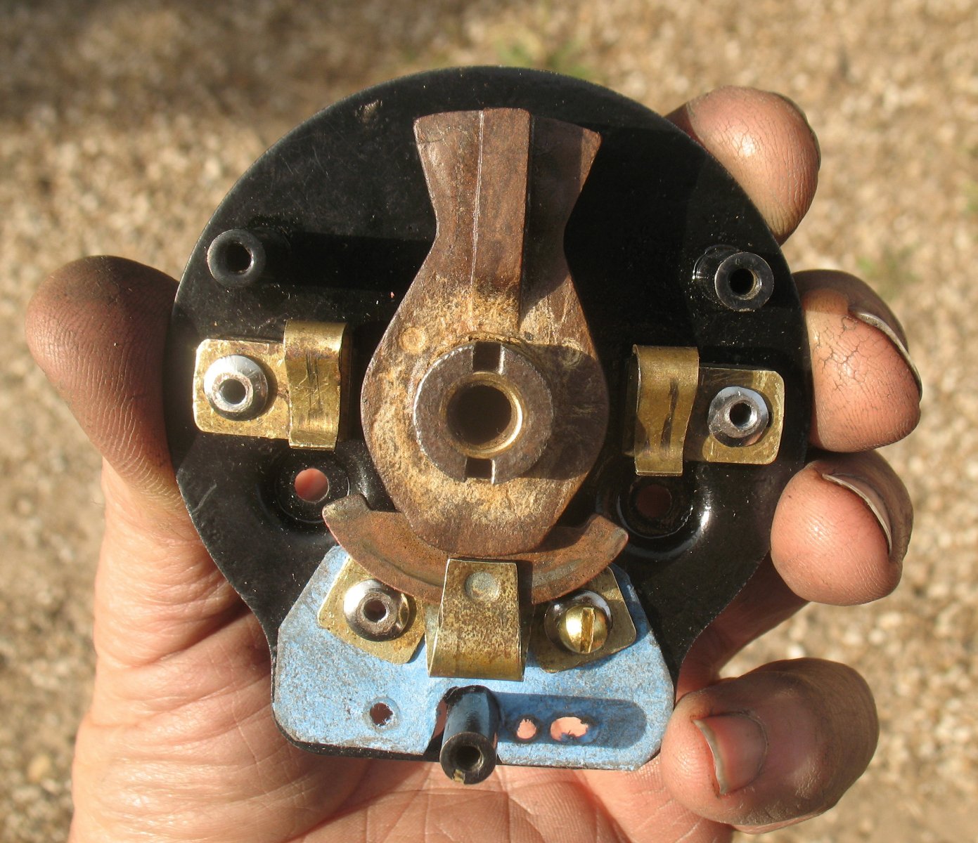

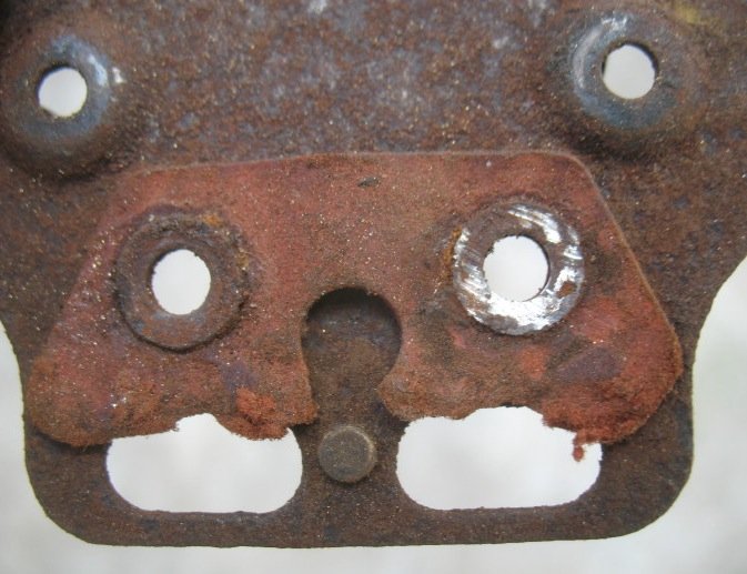

Post by Steve Jelf » Wed Nov 27, 2019 2:48 pm

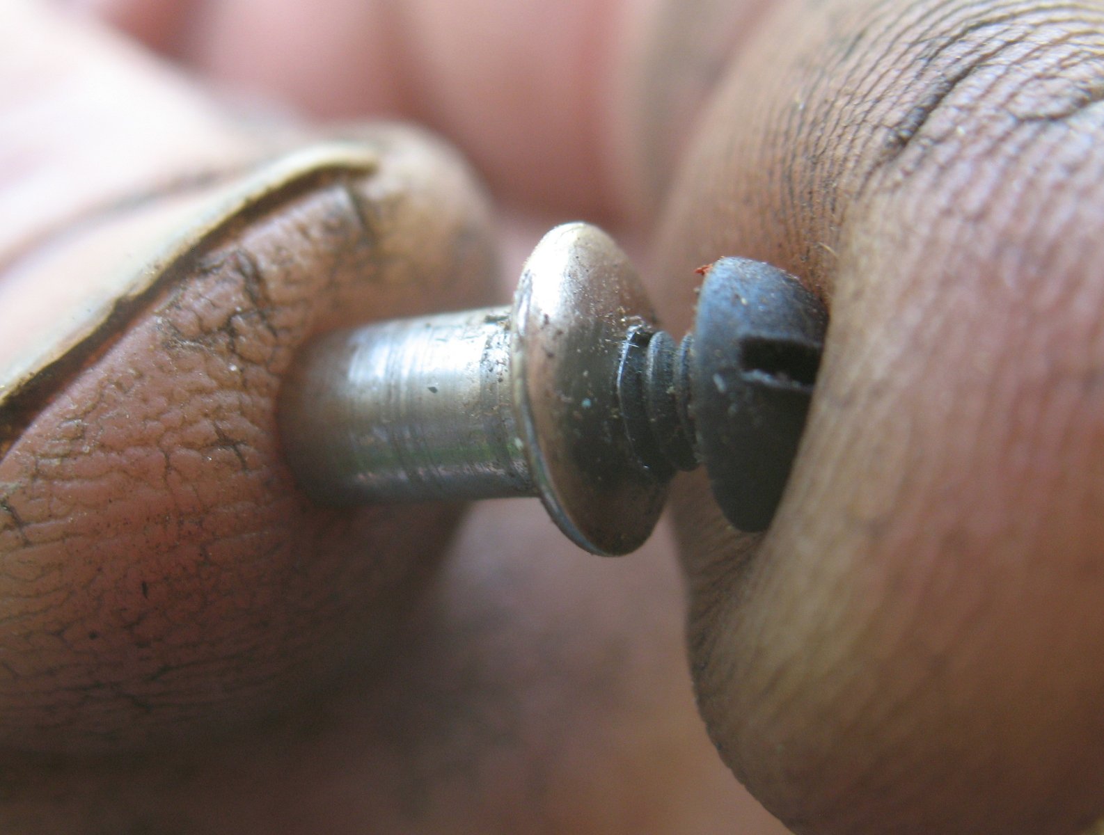

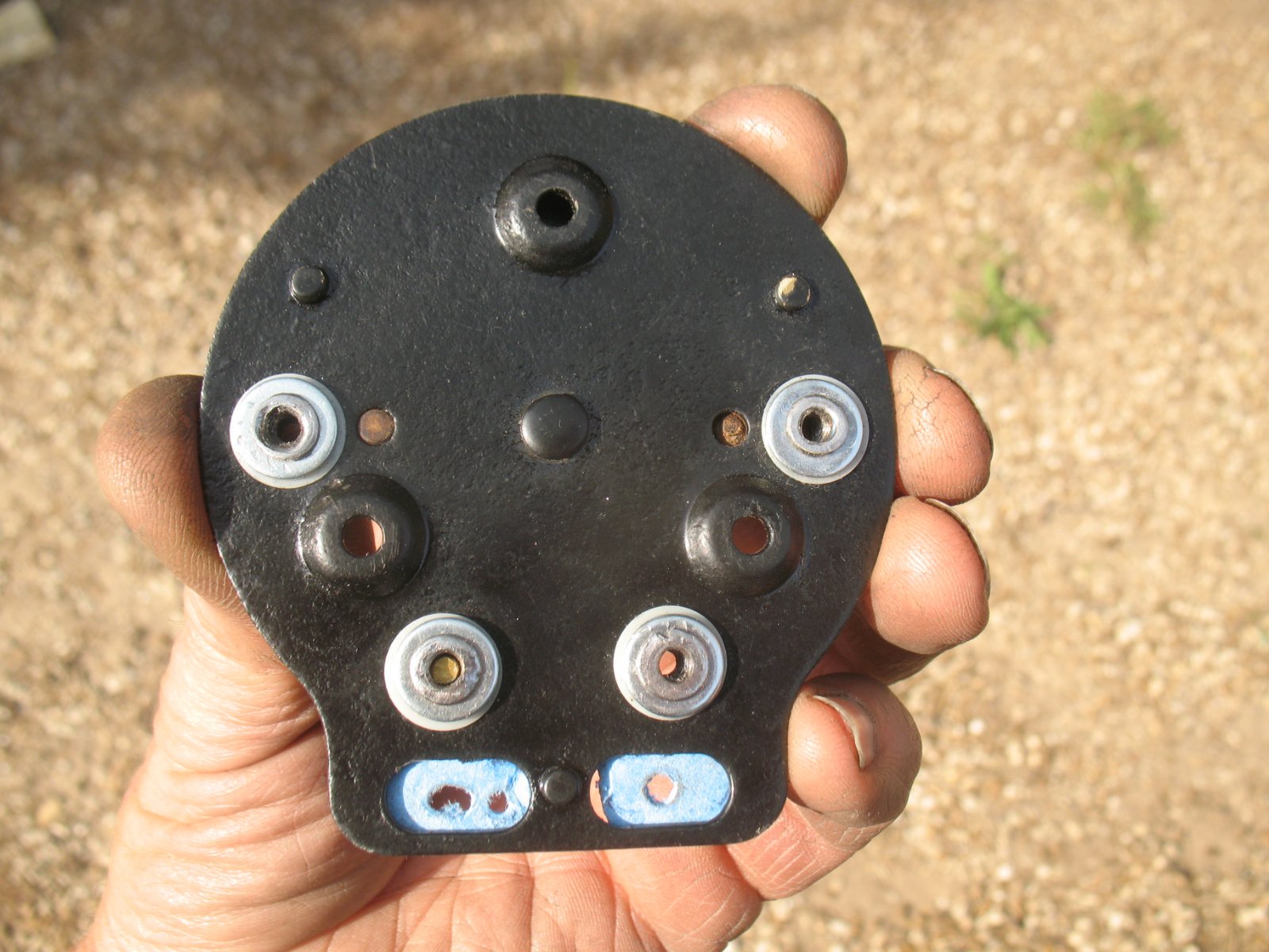

You should not get a shock from any switch, no matter what else you're touching. Look inside your ignition switch and be sure all wires are where they should be and are properly insulated. There should be no path for current to reach the key. While you're in there make sure the metal tabs are tight enough to make solid contact.
Sometimes insulation inside the switch is deteriorated and needs to be replaced.
Thick gasket paper is good for insulation behind the switch.
To install new insulation you will have to remove the old rivets. You can replace them with pop rivets tapped to hold the terminal screws.
The rivets need to be insulated so as to not touch the backing plate. Nylon washers will work for that. The rivets should be mashed flat enough to keep them from touching the coil box.

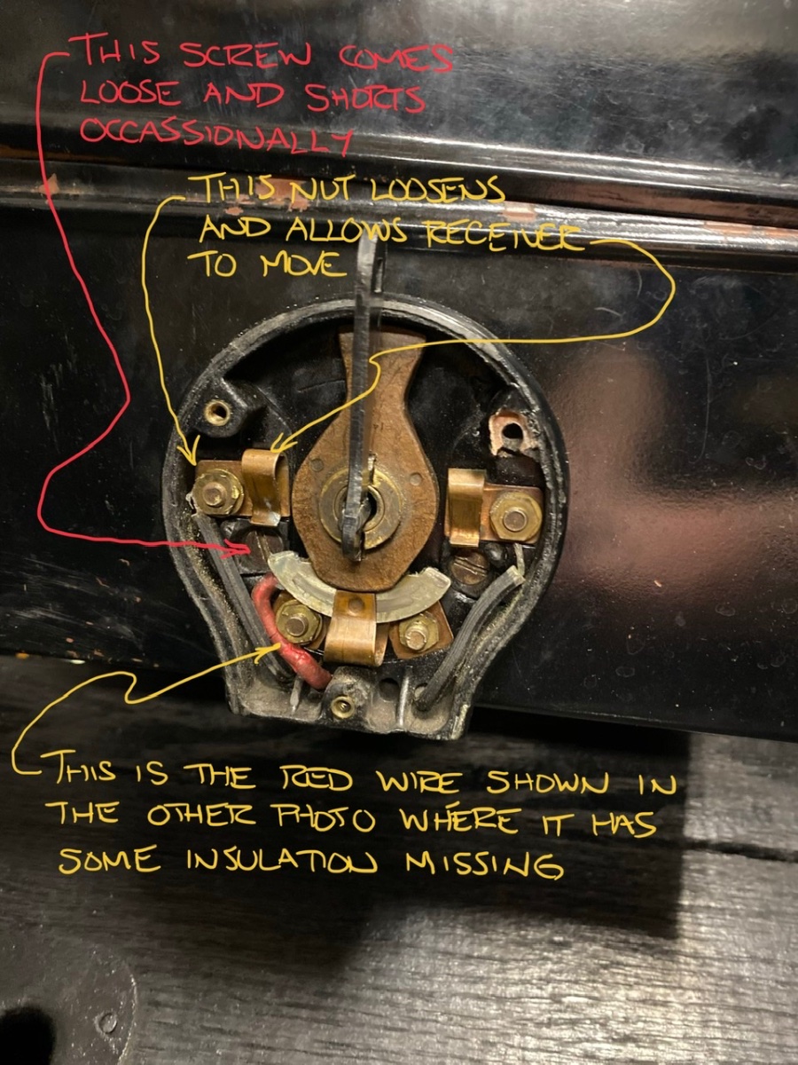

Here is my ignition switch box and a couple notes:
If there was a short in that red wire (in the bottom of the box), wouldn’t I show power somewhere (like the coil box might be ‘hot’)?

The stud in between the terminals looks kinda questionable to me.
You can do a voltage drop test there, check voltage at the wire and then on the stud and terminal. Or you can wire a 12V headlight bulb and check the same way, that will put a load on it...

Steve, I’m thinking your thoughts on the ignition switch are the winner here. Looking back on that picture of the wire at the bottom of the coil box that had some of the insulation off, could this be the short?

Thanks for the reply, Steve. I will check this afternoon after work. I checked it last night as it was one of my 'easy' checks. I just need to make sure I check it correctly this time. ha ha ha. I'm pretty sure they were buzzing even when I advanced the spark and the top terminal wasn't making contact or even close. It never hurts to recheck!
It definitely wasn't an issue of the mag because the car was off when I tested the mag (just to see if there was a short that was putting power through while the ignition was turned to mag). I did this because it sounded like the coils were buzzing while the car was up and running and driving on mag (the coils sounded like it/they would when getting ready to crank start and a coil was aligned so that one of the coils was active). If that makes sense
I'm really worried about that one wire (I mentioned previously) that runs through the bottom of the coil box that has damaged jacketing/insulation. That and your (Steve's) suggestion of damaged insulation in the ignition switch box. I'm likely going to be buying a new one as I need the car up and running for two Christmas parades this weekend. :(

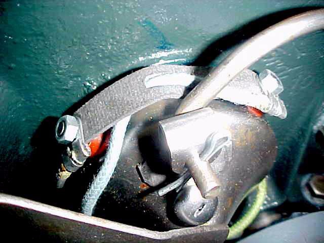

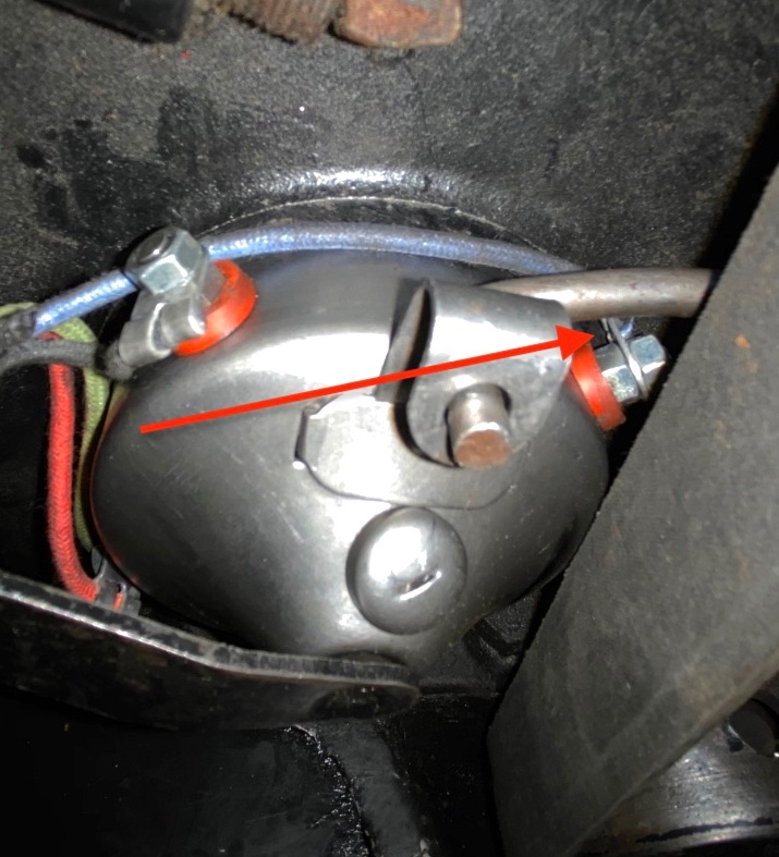

Posts: 4086
Re: Changed Wiring and Problems Running Now
Post by DanTreace » Tue Dec 03, 2019 9:27 am
Max
Seems if wiring changes caused issues, would really look close at the timer wiring again. Those 'flag' style terminal have longer side with the solder wire point. Those flag ends can contact metal of the front plate, bolts, or timer rod. If any contact, a coil wired to that flag will fire. You only want contact of the coil wire to the rotor inside the timer case.
IMO, this is the issue, note your terminal can hit the metal front plate, and the timer rod. That rod does need a cotter, or else it will fall out or back off and contact the terminal, causing the coil to fire. See arrow, plus another flag terminal on the lower side of your timer case is positioned this same incorrect way.

Make those flag terminal all around the timer case look like this:
Or if you place the flag to the rear, a pair of needle-nose pliers can be used to 'bend' the flag up, to make sure in no way can the terminal contact any metal. And be sure to keep the timer rod secure, so it won't flop and contact anything too.
IMG_8293 (550x413).jpg (140.99 KiB) Viewed 9411 times
Posts: 4086
Post by DanTreace » Tue Dec 03, 2019 9:36 am
Forgot to mention, for the very neatest appearance and protection of shorts to the wire there, Ford made this fabric like 'retainer' P/N 5033B ('21-'27) to fit on the timer case under those flag terminals. Lang's makes a repro today. Haven't ever placed one of these, nor seen an original on a T, but these were used. Might be bit harder to install, but sure looks good and should work well. Ford wouldn't have spent pennies on it if it didn't ;)

Hey Dan! Thanks for the suggestion and I'm hoping this is our turkey! I took a couple more photos and I see what you mean. That blue terminal needs to be flipped and rotated 90 degrees counterclockwise! I took a couple more pictures and it seems to be pretty close to touching (if not touching). I was trying to keep it out of the way of the timer rod and instead backed it up against the front plate. This is a picture I took of the old wiring and I can see that it was rotated on the old wiring arrangement.
As far as the bottom terminal that was incorrectly set, I just followed the top one... mostly because the old bottom flag had broken off and I had it temporarily just wrapped around the post and screwed down (in that case, there was hardly any copper left to stay connected!). YOu can see that as well.
I'm feeling pretty confident right now, but I don't want to get my hopes up too high just yet.
I'll let you know. Thanks again!

Post by MadMax » Tue Dec 03, 2019 6:31 pm
And the winner issssssss:
Dan Treace!!!! You hit the problem on the nose. The wires were shorting out against that front plate. I rotated that bottom one. The top one in the photos got bent upward to prevent contact with that front plate or the timer rod.
Many thanks to all of you who had input! Greatly appreciated.
I will still actually be looking over some of the things folks brought up as I think they will help tuning the car better.
