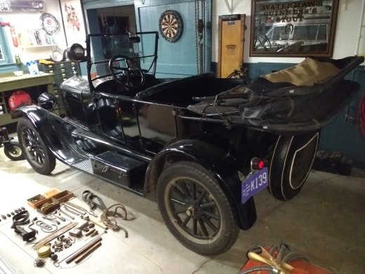

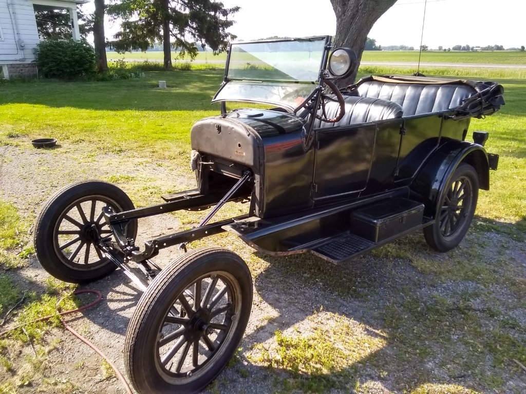

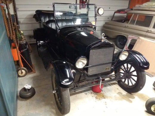

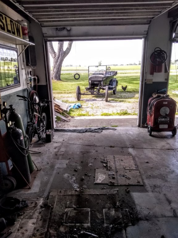

What better way to start a new year and joining the new forum than posting a thread on the refurbishing of my 1926 touring.
I picked up the car a few months ago with the intention of going through it over winter for some summer touring... The FORD itself is in OK condition and was cosmetically restored eons ago, mechanically it's been limping along on borrowed time for a few decades now... lots of worn parts in need of attention.

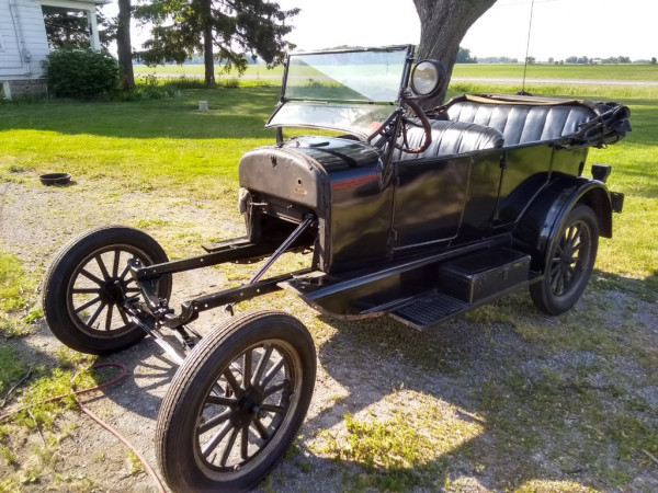

Lets kick this off with a few pictures of the FORD right before work began...

Re: '26 Touring refurb...
Post by RustyFords » Sun Jan 06, 2019 10:57 pm
Nice car Jason....looking forward to seeing your progress.

Looks like a good one.
Now that we have automatic resizing, you can post your picture files full size so they nearly fill the screen.

Nice lookin' car.

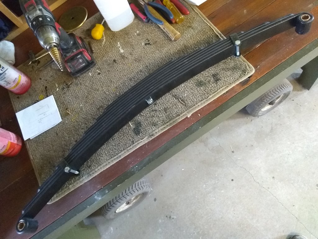

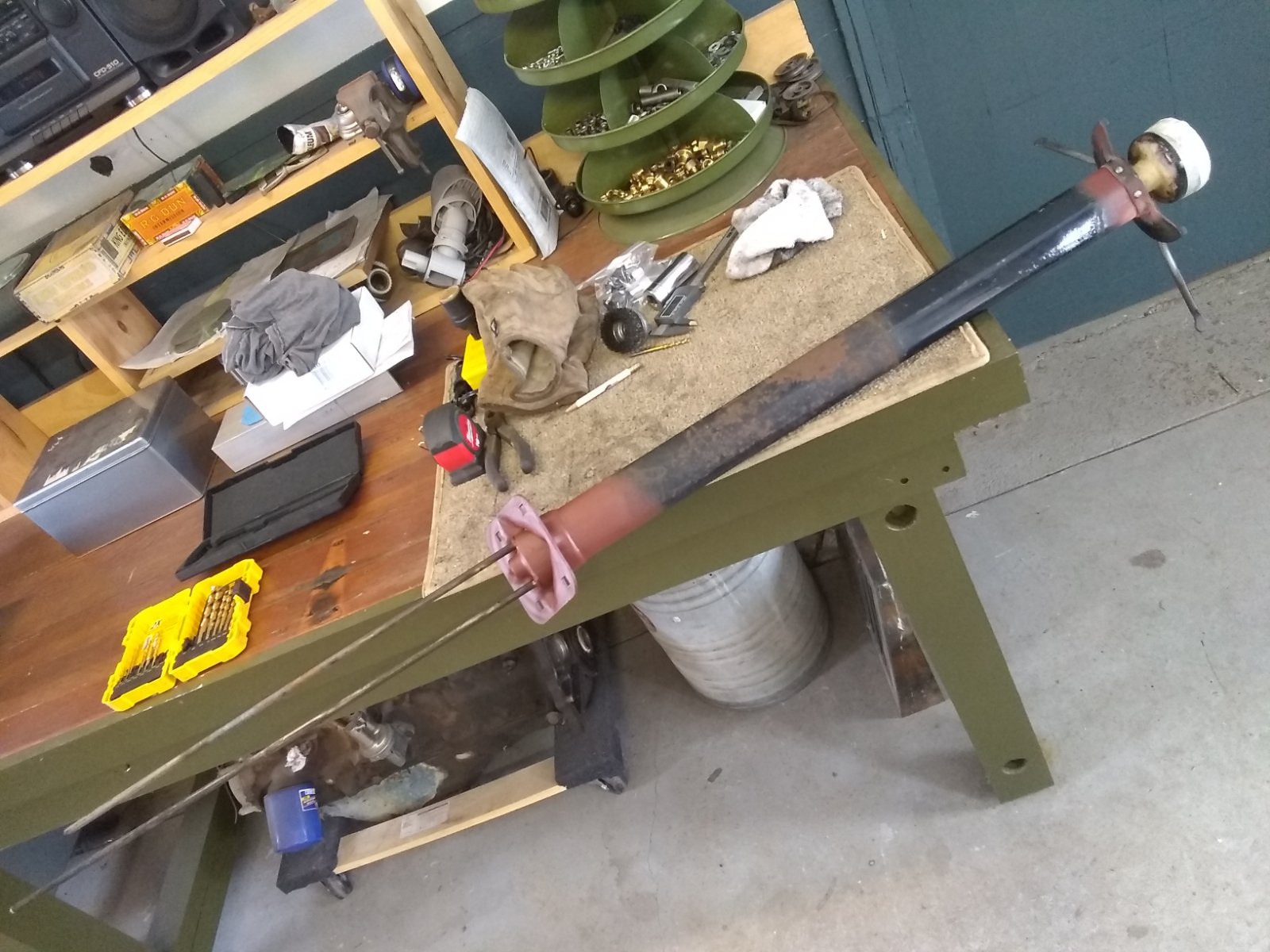

I'm waiting on a new steering shaft and some other things from Lang's so I'm not getting tons done but I have been picking away at stuff. I took the steering column apart as it was slop city. The throttle and spark rods were work as was the quadrant... I welded the rods and reshaped them but the quadrant was so bad I found a NOS one for a replacement. I also found this cool walnut wheel but the spider was too thick for the T column so I'm making a Ford part work. Plan is to make it a Fatman wheel.

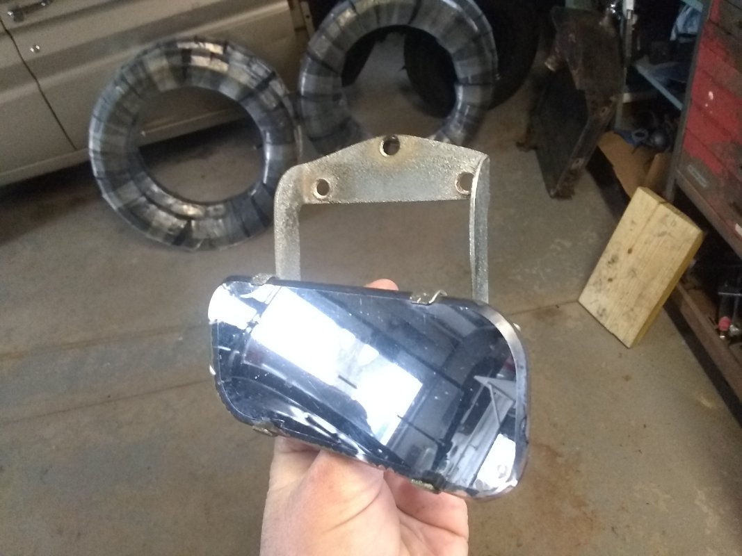

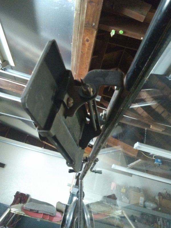

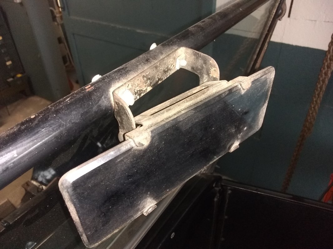

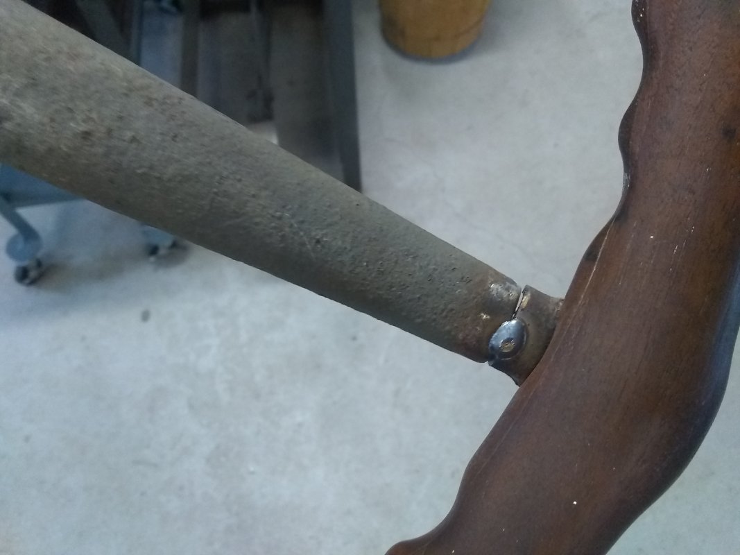

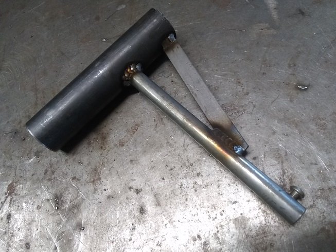

The Ford came with this Trico mirror attached to the window frame but it didn't look right, the bracket wasn't curved to match the window frame... Maybe it's for a closed car. I had one that was curved to match so I swapped it. It's larger than the Trico anyway so it's a win win.

I like your mirror mod. I may have to copy that. I have no trouble finding weathered closed-car rear-view mirrors, but the open car version seems to be scarce as hen's teeth.

A couple other things I'm digging in your initial photos....

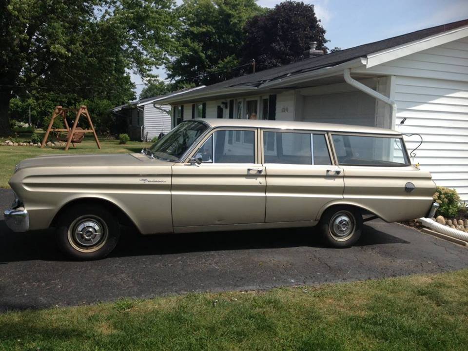

- The wagon...looks like a Falcon. How cool! I'd love to see more photos of it.
- You seem to keep your shop fairly organized. I keep mine the same, mainly out of self-defense. My (undiagnosed) ADD drives me crazy if I don't know where all my stuff is (tools, parts, etc)
1924 Touring

rustyfords wrote:
Mon Jan 07, 2019 3:04 pm

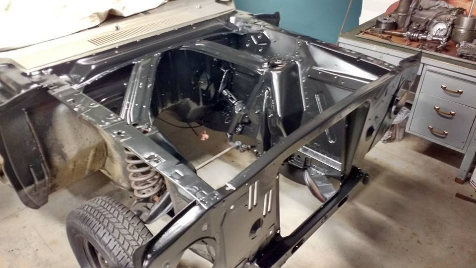

It's a '64 wagon. The last of the falcons I own. The guy I bought it from was going to do a V8 conversion but he never changed the front end over to the heavier V8 stuff so I sold his engine and tracked down a '68 inline 200 with a C4 behind it to swap in. We plan to use it for vacations hauling a little 1960 popup camper we have. I got the engine compartment restored, and am rebuilding the C4 with V8 clutch packs now so towing will never be an issue. Should be alot better than the 2 speed trans that came from the factory.
I do try and keep the shop clean, although it has it's moments! It was originally the 1930's milking building here when the farm was operational. The previous owner did some work to it but i'm going through it to suit my needs, getting there!

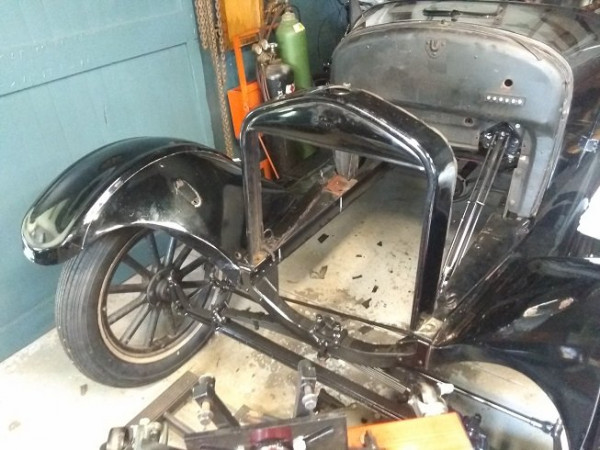

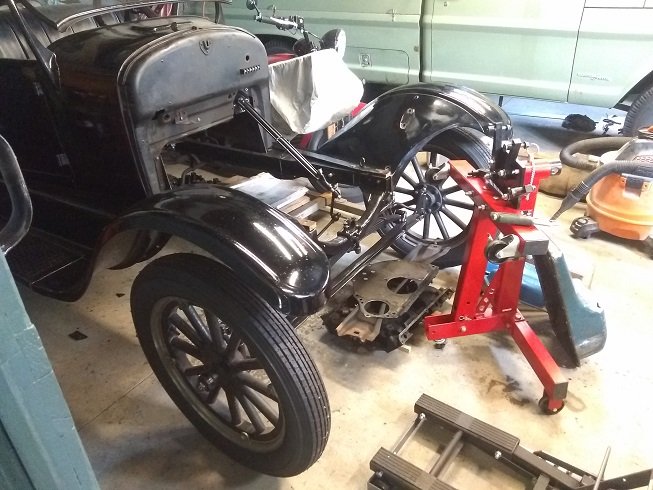

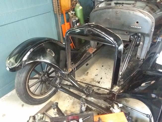

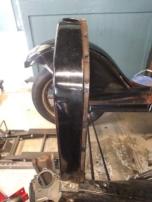

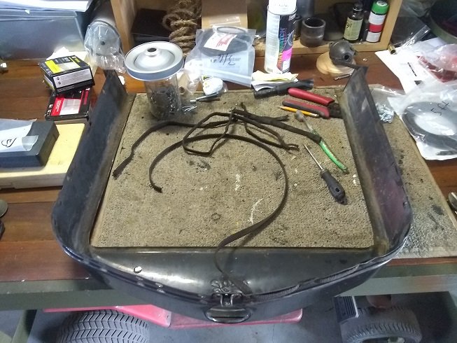

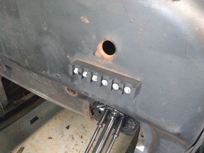

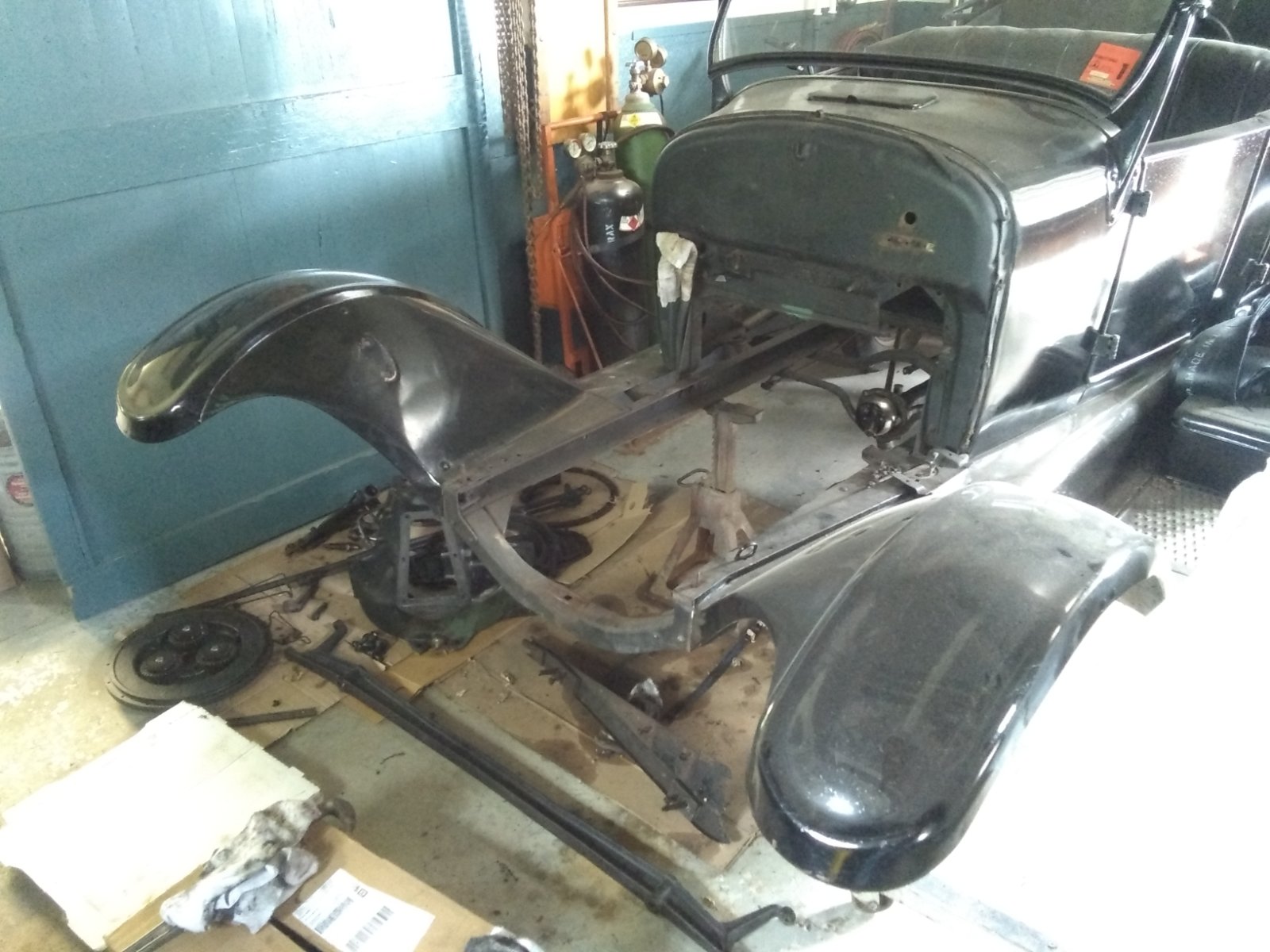

Working on removing the engine to go through it so I've got the floor boards and front end off for access. Somebody hacked up the dash switch assembly so I pulled that as well, maybe I'll fab up something custom that looks period...
... and my number is Beechwood 4-5789

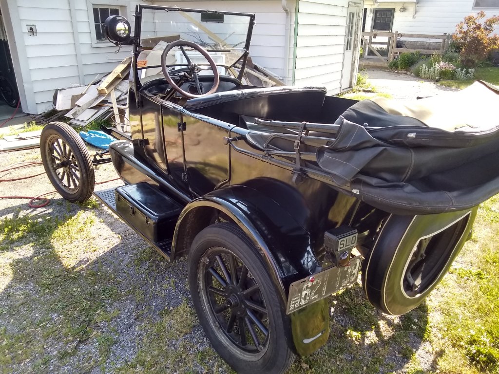

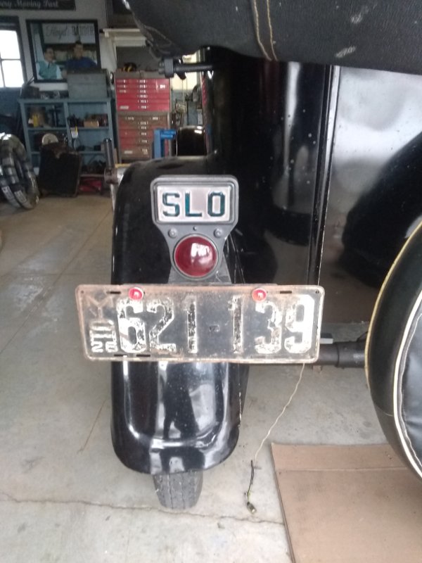

I snagged this accessory taillight for the back. Since we can use YOM plates here in MI I have been on the lookout, finally found a decent pair... '26 plates are hard to find.

That is so cool. Great minds must think alike. I called about that car a couple months ago but it was sold. Must have took two days just to wash it, looks great now! The listing and YouTube vid are still up if you want to get the "real" before pictures. Congrats and Good Luck with it!

That “SLO” piece is beautiful.

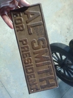

Post by Barth_Tool_Co » Fri Jan 11, 2019 9:33 pm

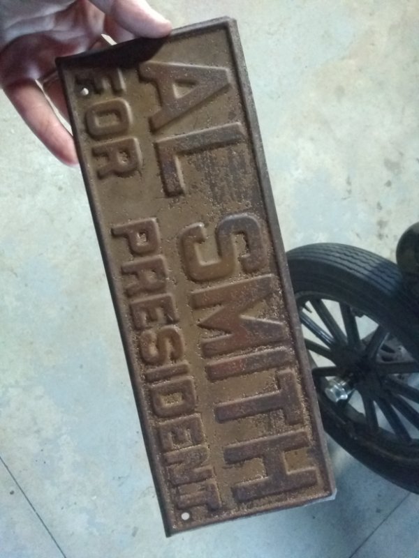

Picked up this plate for mounting on the rear tire carrier...

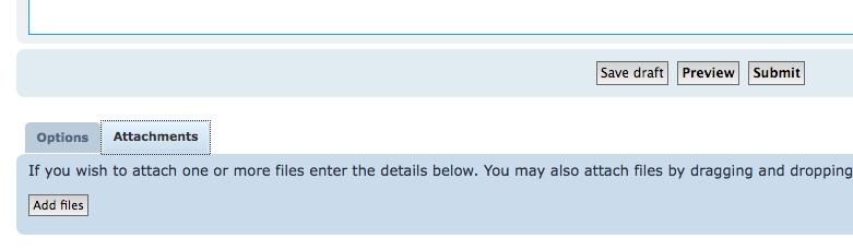

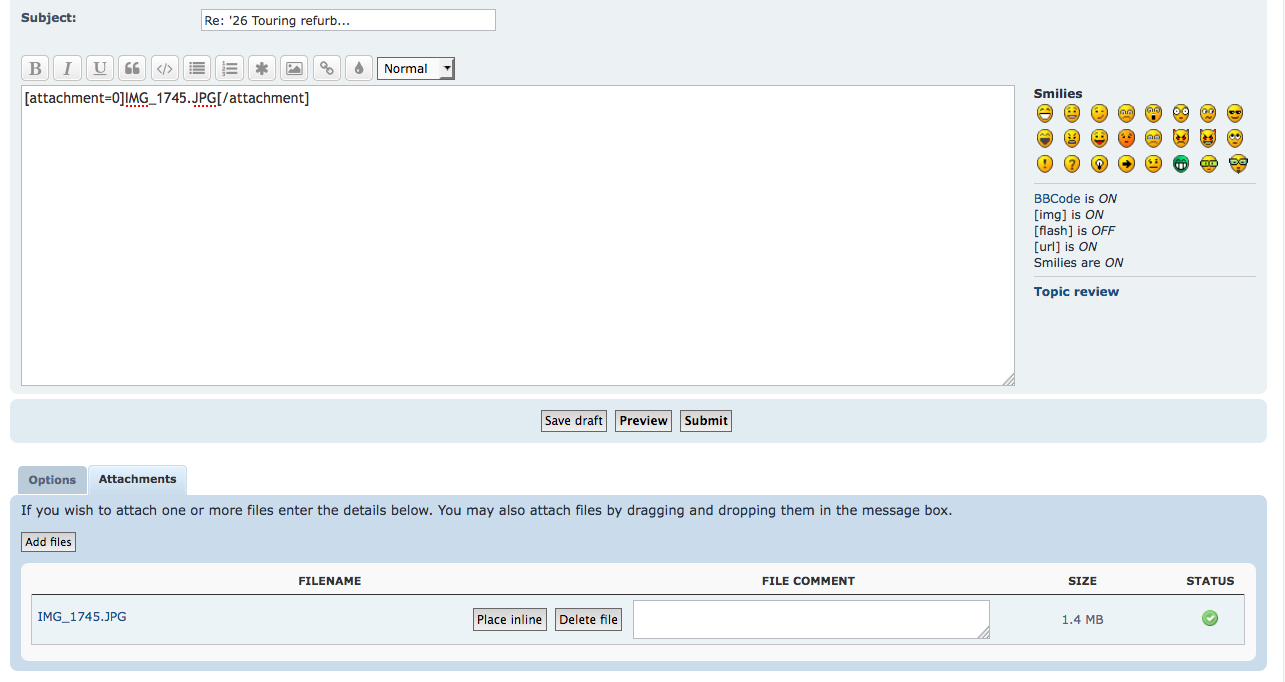

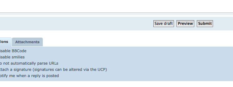

Just below the Save, Preview and Submit buttons is a small tab labeled Attachments. Click on the Add Files button in there to select and post a picture (or whatever type file the Board software allows/supports).

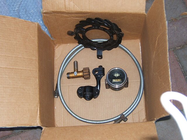

1926-27 Wood wheel 490 speedometer parts
Source: http://www.mtfca.com/discus/messages/11 ... 1292196239
Posts: 7411

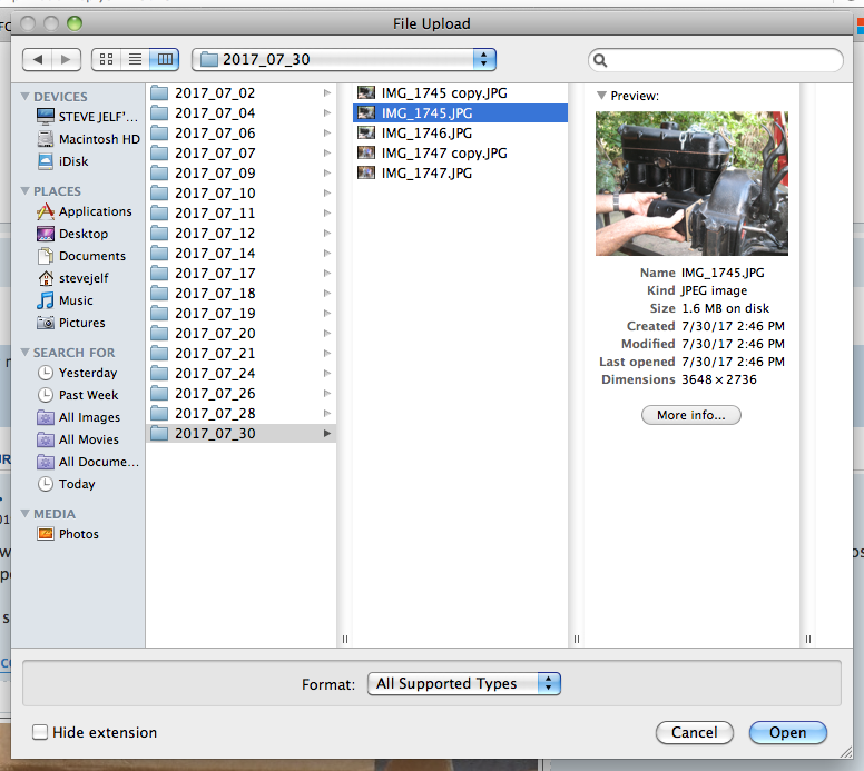

Post by Steve Jelf » Mon Jan 28, 2019 12:46 pm

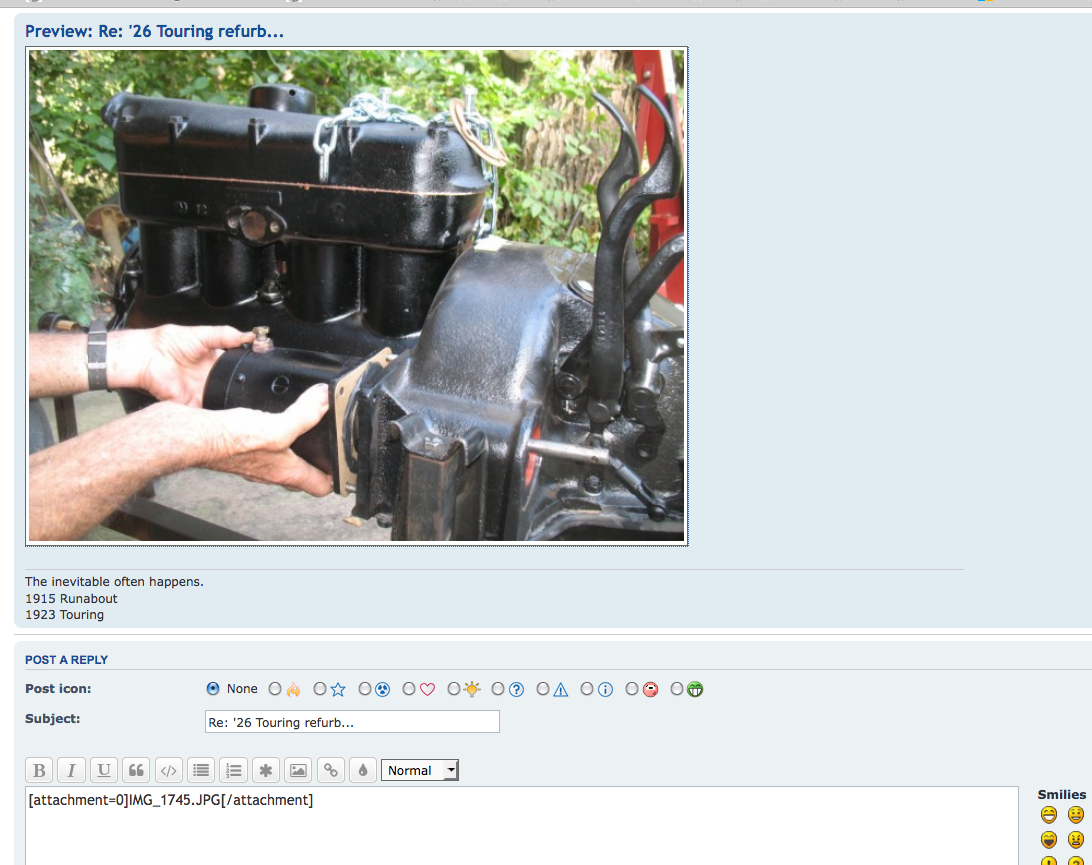

Jim, posting a picture here is easier than on the old forum. You don't have to resize. Here's how:
Below the composition box, click Attachments.
Click Add Files.
Find the file that you want to post from your computer, click on it, and click Open.
Click Place inline and the name of the file will appear in the box.
Click Preview and your picture will appear in the box.

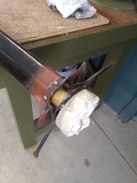

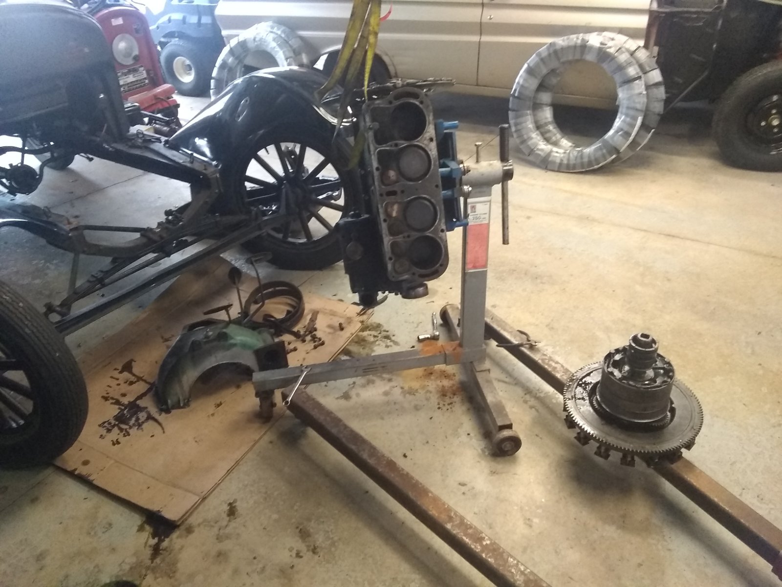

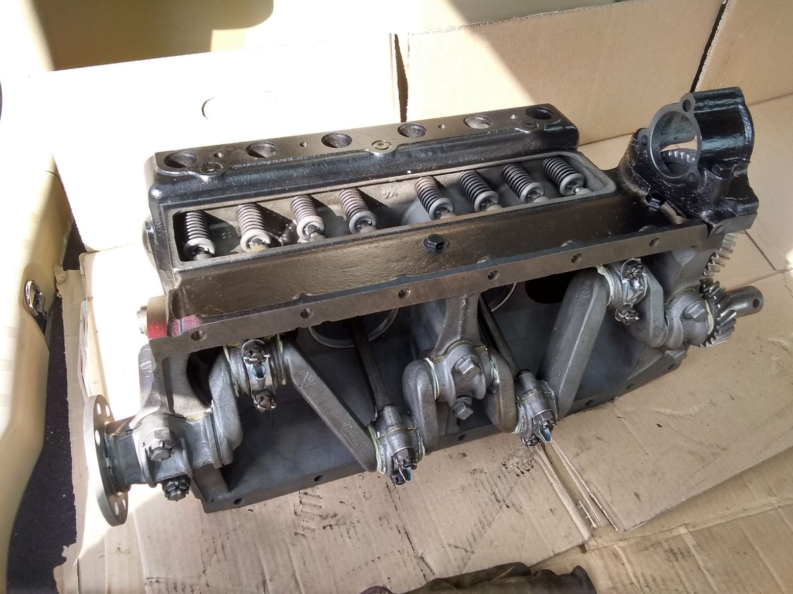

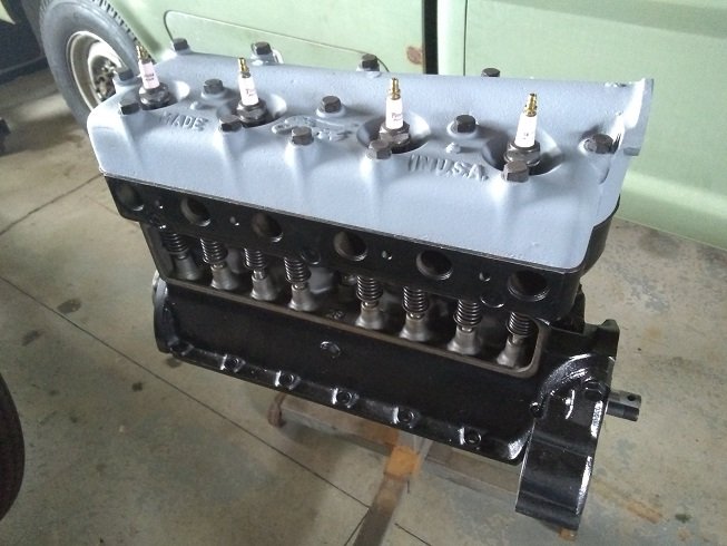

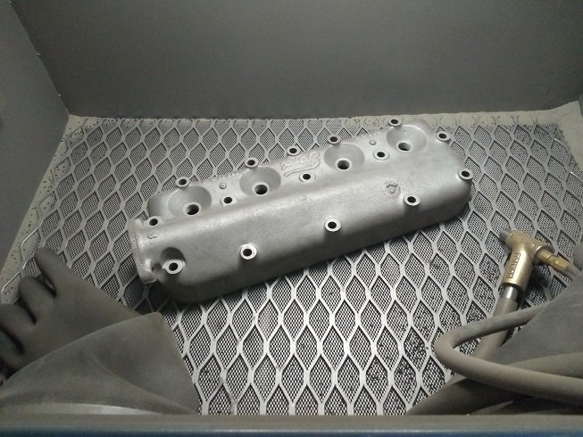

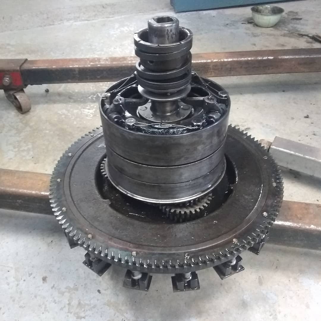

Post by Barth_Tool_Co » Sun Feb 03, 2019 9:08 pm

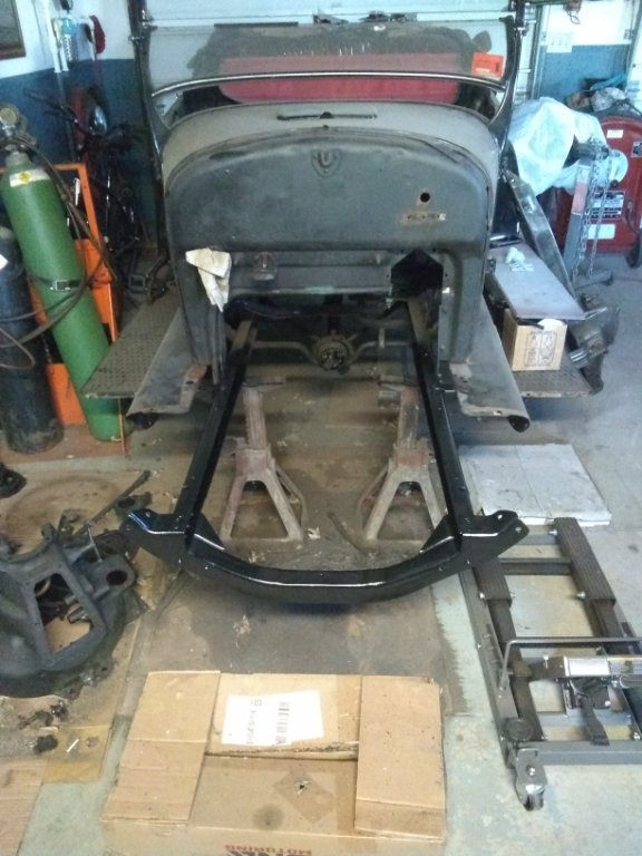

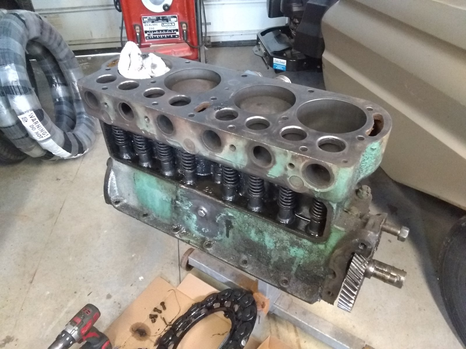

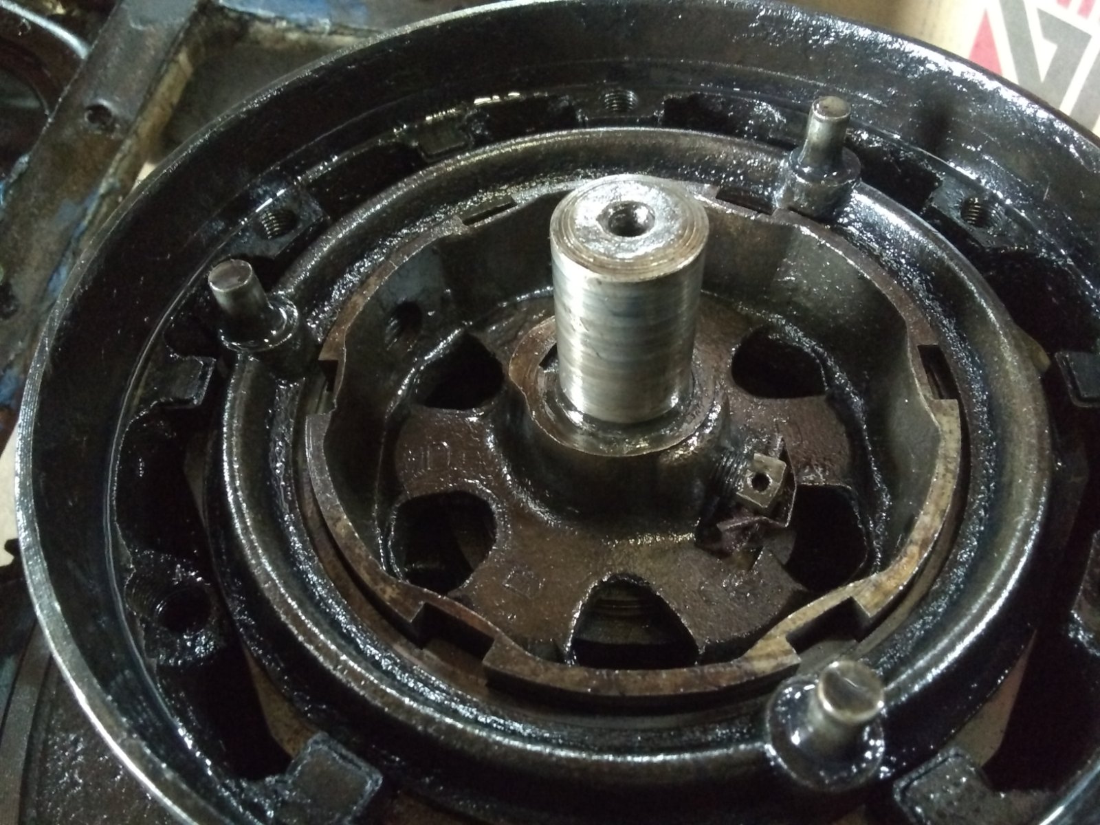

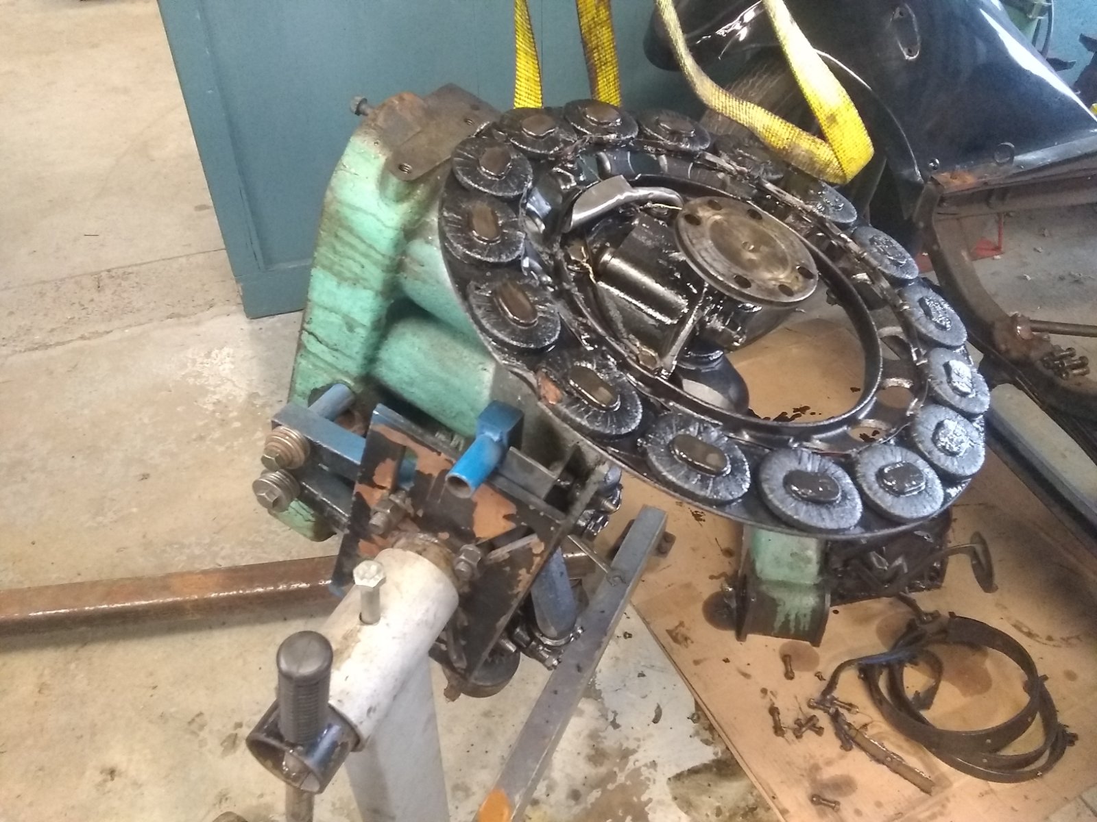

The weather finally got into the 30's, up from below zero so I got a chance to pull the engine and tear it down into major components this afternoon... The whole thing needs a rebuild so that's where it's headed...
Post by RustyFords » Mon Feb 04, 2019 6:49 am
You're making some real progress...keep at it.

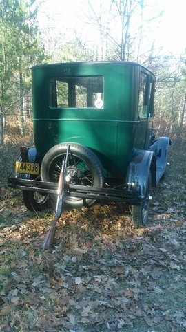

Post by Ed Baudoux » Mon Feb 04, 2019 8:01 am
Jason, small world. I recognize your place. I plumbed the farmhouse years ago. Mark and I have done a lot of work on our projects in that little shop. My in-laws live 3 doors west of you. Here's our Fordor. -Ed

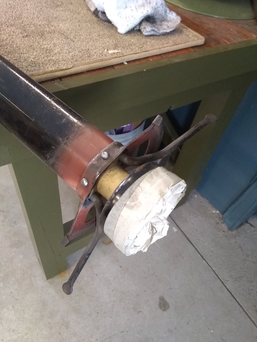

Post by Barth_Tool_Co » Sun Feb 17, 2019 1:48 pm

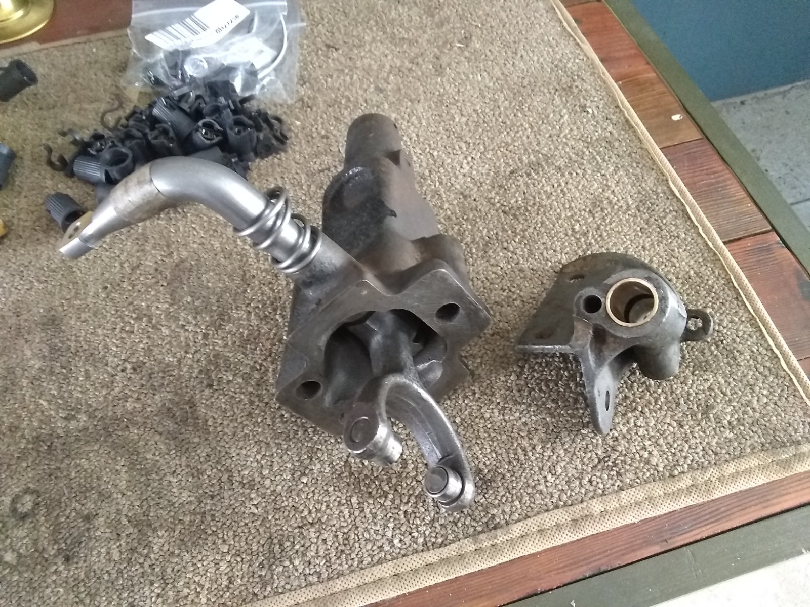

I got the steering shaft mount and ruckstell shifter back from the machinist today and they are great, nice and tight, gone is the major slop.

I also got the engine stripped down to the block and wire brushed the top, plus all the spot prone to cracking and couldn't find any looking at it from inches away. The block had all two piece valves... They won't be going back in.

Post by Barth_Tool_Co » Sun Feb 17, 2019 6:36 pm

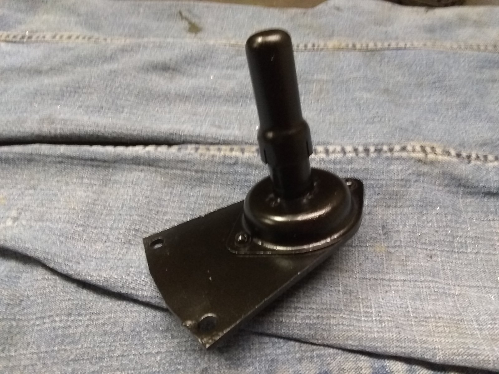

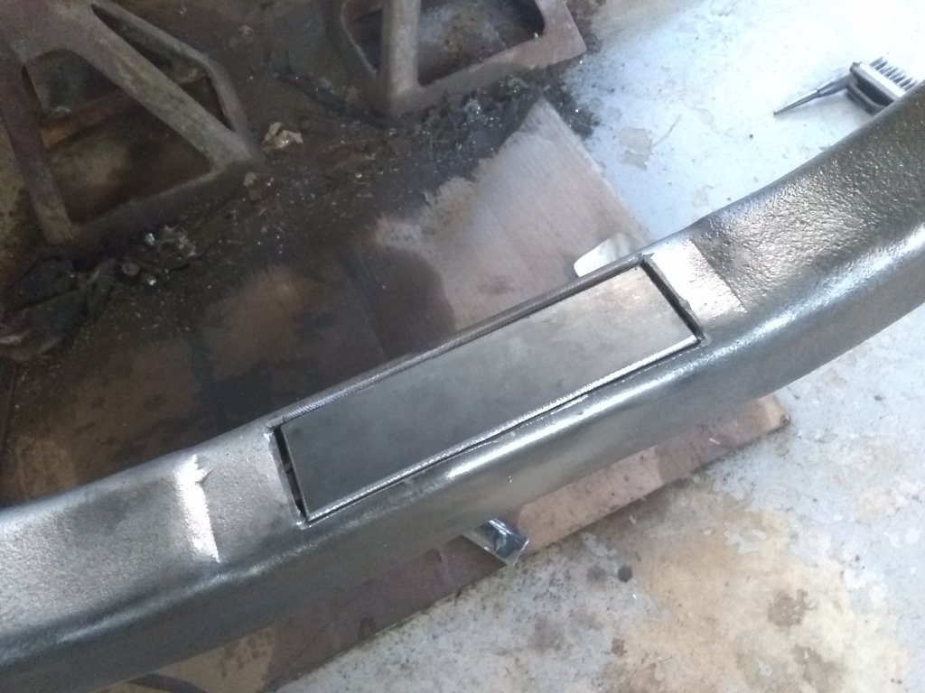

I got the NOS quadrant installed today. Earlier I had welded up the bottoms of the levers and reshaped them as they were severely worn. What a difference, positive clicks and no slop in the head of the steering column. Steering should be much improved.

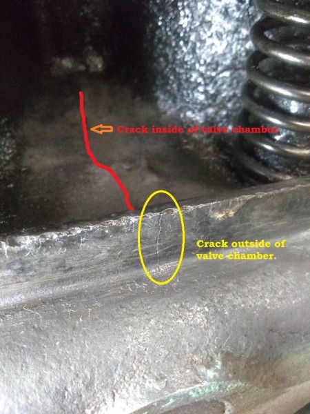

Post by Barth_Tool_Co » Tue Feb 19, 2019 9:13 pm

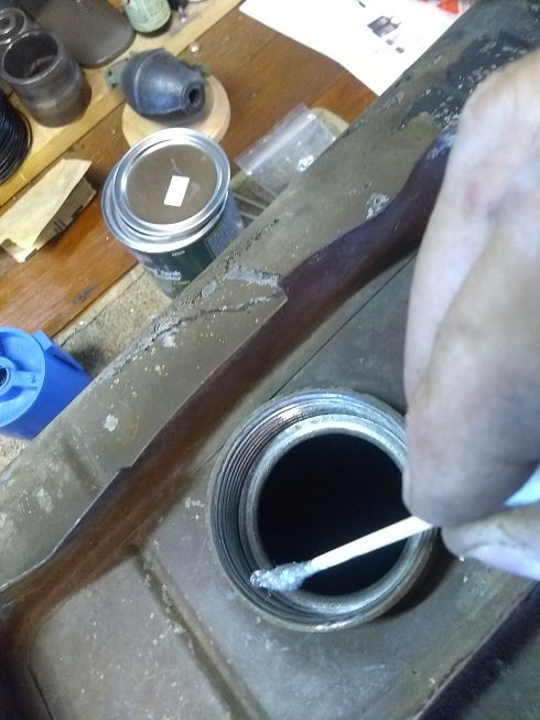

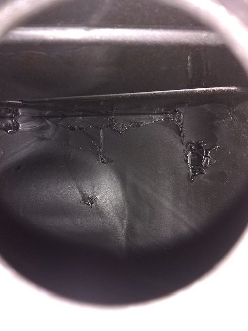

Uh oh.... we got a crack. Not unexpected but not welcome either.
I'm inquiring about metal stitching in MA and may have a lead on a machined block another hobbyist did not complete... working the options!
Post by Original Smith » Wed Feb 20, 2019 9:30 am
The reason your rear view mirror doesn't look right, is because it isn't right! The one you show is for a closed car. The factory brackets for the tourings and roadsters wrap over the top of the windshield frame, and were originally held on with two horn button bracket screws.
Post by Barth_Tool_Co » Thu Feb 21, 2019 8:34 am
I figured that, good to hear confirmation. I like the accessory one I put on much better anyway... has kind of a purple tint to it :D

Jason, There are two type of stitching that I am aware of. One being the bow tie type and the drill and tap type. If you elect to use the drill and tap type, I would just drill and tap both ends of the crack, basically drill stopping the crack. It is not into water and all model t's leak oil. You could grind the crack out some between the drill stops and use JB weld to seal. Most improved blocks crack through the valve seats into the water jackets. Your transmission drums look good, hope the rivets are tight. What you are doing looks great. Thanks for taking us along.

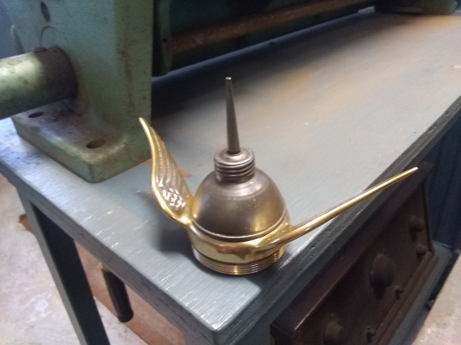

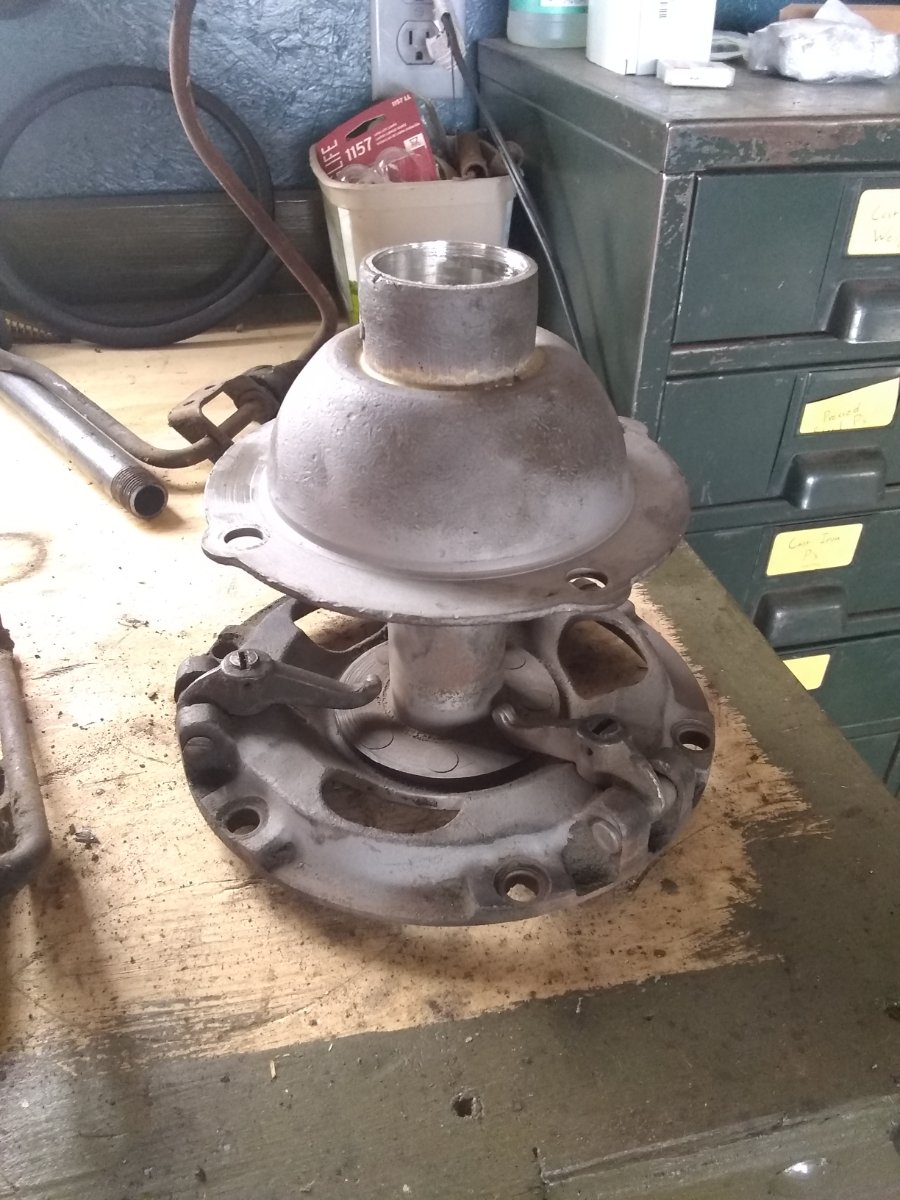

Not a very good afternoon on the T... Lots of problems in the transmission that need attention, it's a fixable though and this is a great time of year up north to work on stuff!

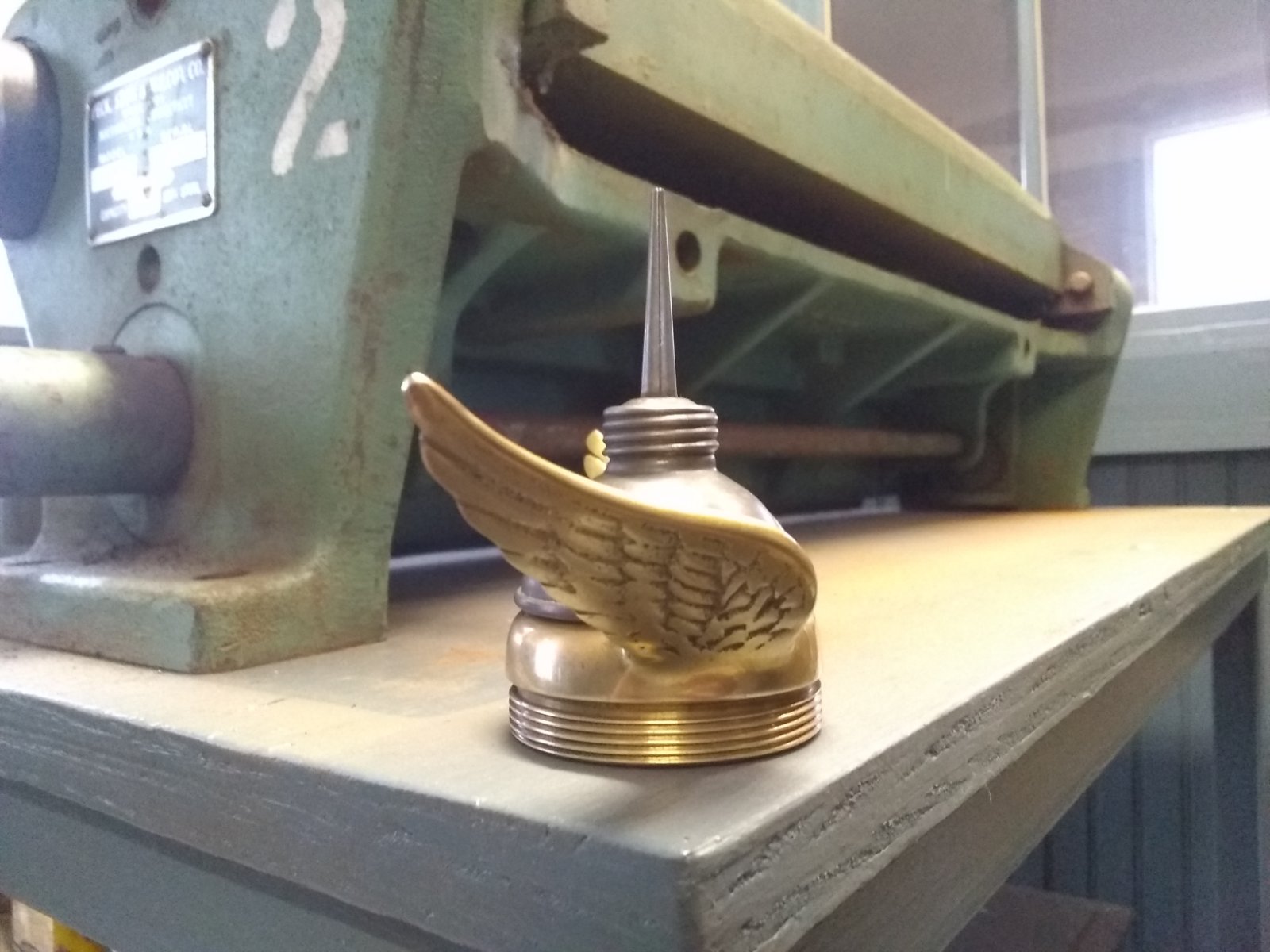

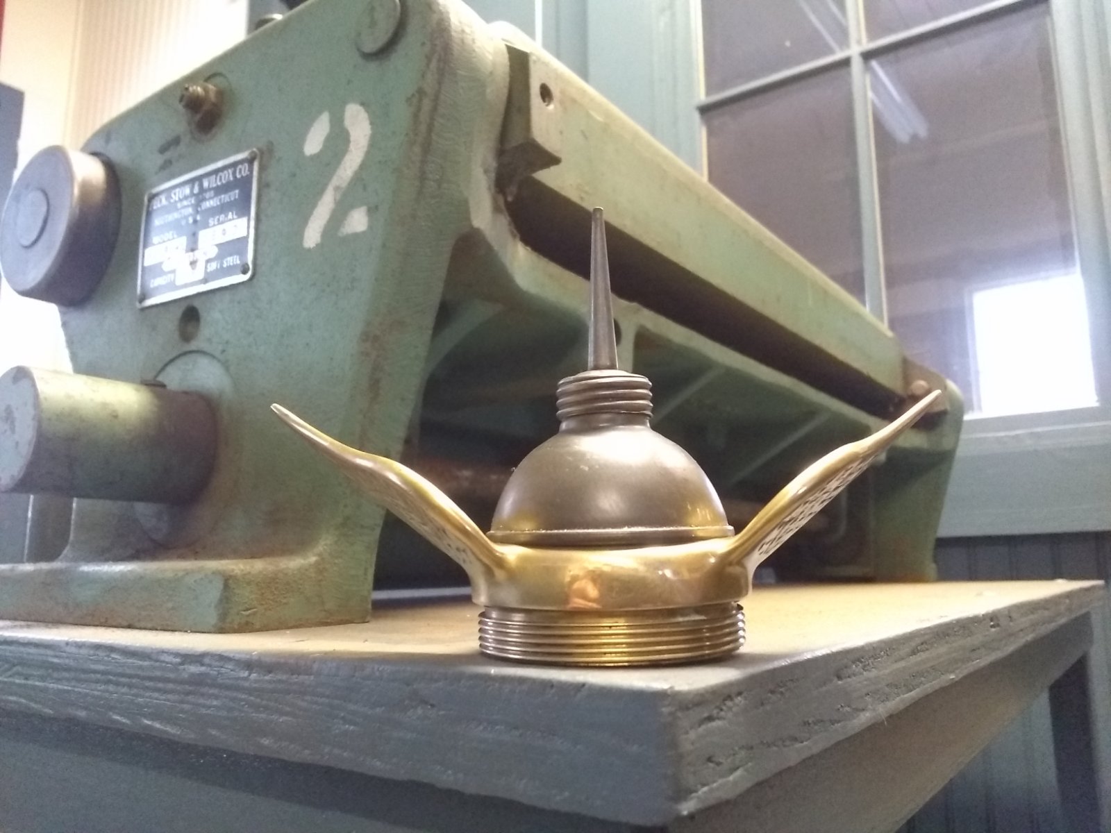

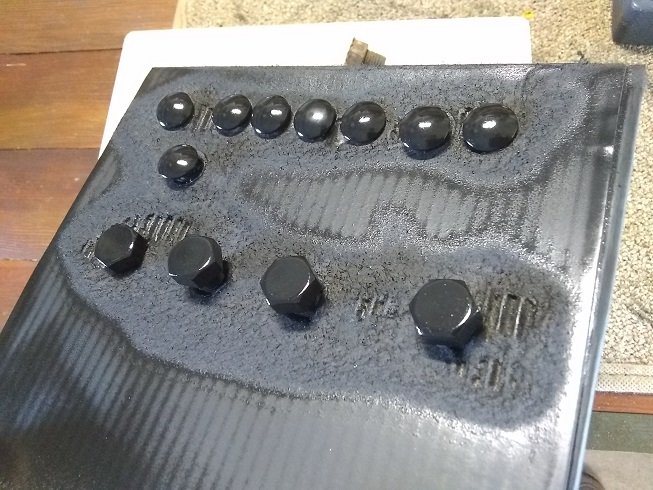

I like to end the week on a high note so I put together this radiator cap, I will eventually plate the brass but that's down the road.

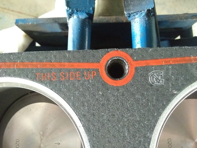

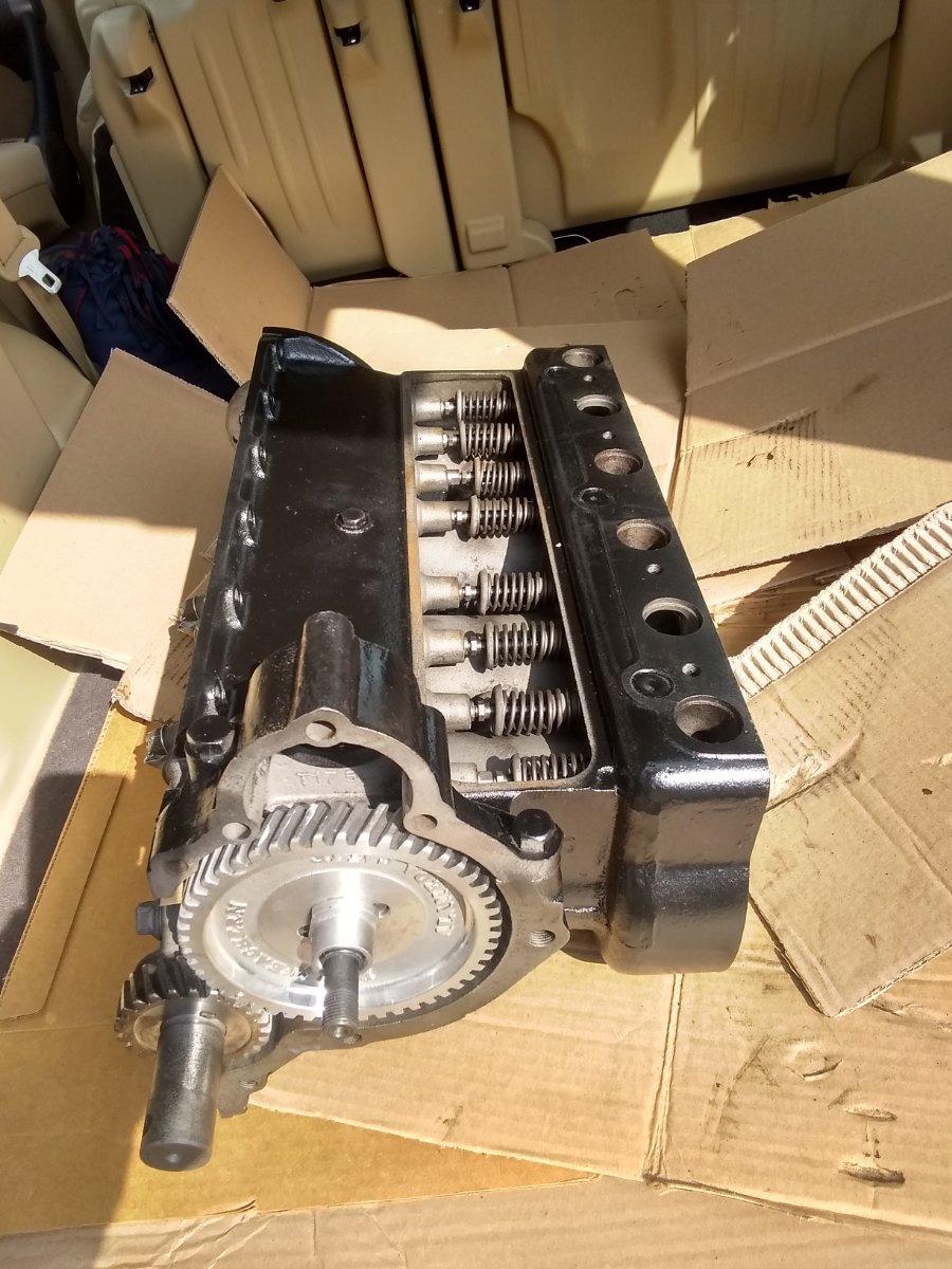

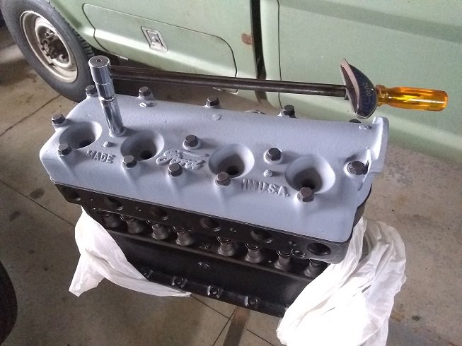

Post by Barth_Tool_Co » Sat Apr 06, 2019 8:16 pm
Big day today... paid a visit to Joe B to pick up a rebuilt short block and check out my transmission issues. I can't speak highly enough of Joe, first class fella. He was able to get me a good brake drum and output shaft as well as put new bushings in and allowed me to ream them on his KW tool.
He checked my pan and it was nice and straight, He may have found the one part on this T that isn't shot! I also ended up with some other needed parts and a rewound coil ring... Kid in a candy store!
Definitely worth the trip just to meet Joe, solving several major issues on the T was like a bonus.

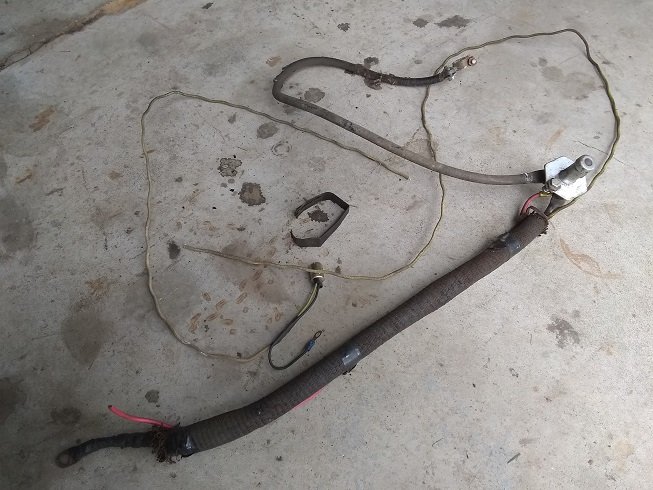

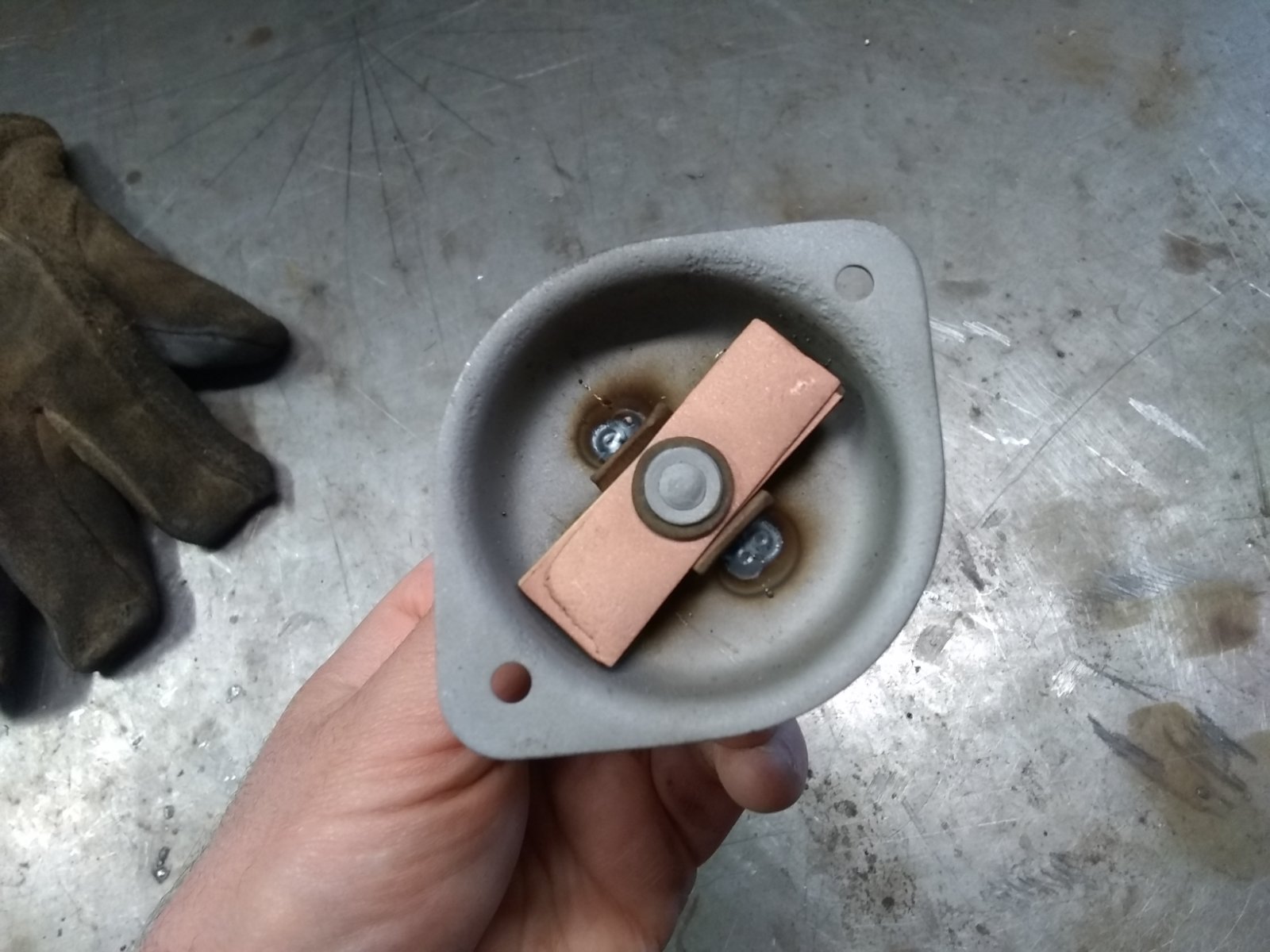

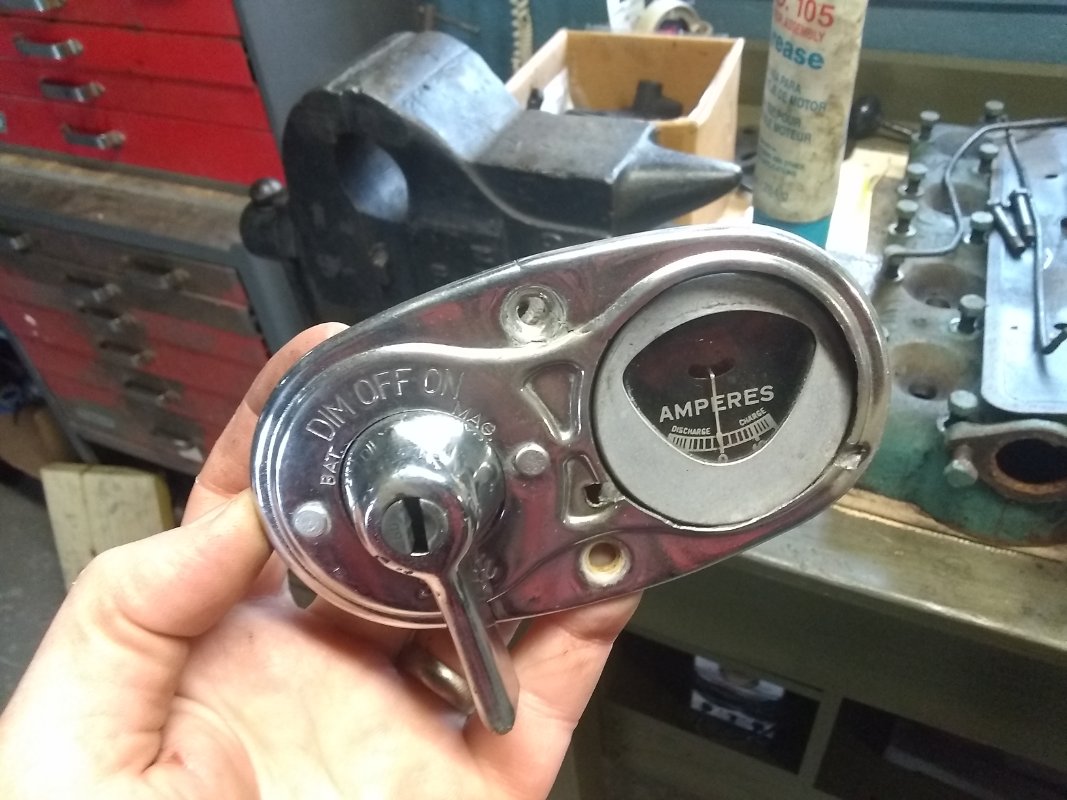

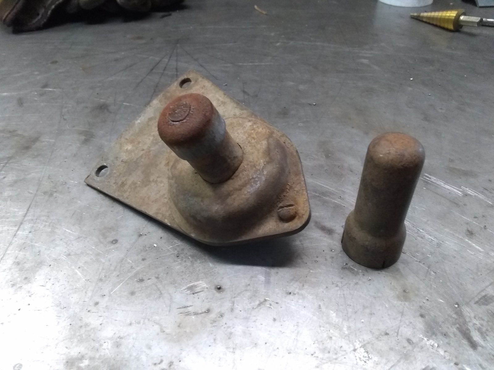

Post by Barth_Tool_Co » Sun Apr 14, 2019 11:28 pm

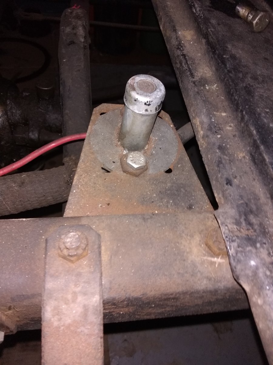

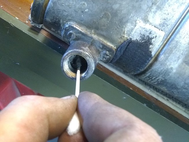

Had some time today to work on the T so I tackled the starter switch. The one in the car was modified to make a new switch fit the old base. I picked up an original to replace it. After disassembly I discovered the tabs on the sheet metal shaft were missing or bent so I bumped them back down and tack welded them for extra strength. Inside contacts were masked off, painted, and dabbed with some electric grease. The unit was then assembled and painted, ready for use.

RustyFords
Posts: 1559
First Name: Don
Last Name: Allen
Location: Houston, TX
Post by RustyFords » Mon Apr 15, 2019 6:41 am
Nice work.
It is satisfying when you can undo a cobbled together repair that didn't really work and replace it with a solid original part.

Barth_Tool_Co
Posts: 132
Joined: Sun Jan 06, 2019 8:10 pm
First Name: Jason
Last Name: Alvord
* REQUIRED* Type and Year of Model Ts owned: '26 Touring
Location: Saginaw, MI.
Post by Barth_Tool_Co » Mon Apr 15, 2019 11:56 am
Nice work.
Thanks! My favorite part of restoration is putting things right : Now I'm not sure if that's the correct switch for a '26 but I figured being able to take it apart with screws was safer than bending tabs.

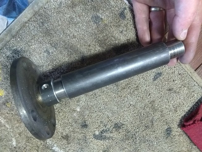

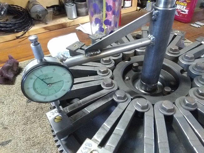

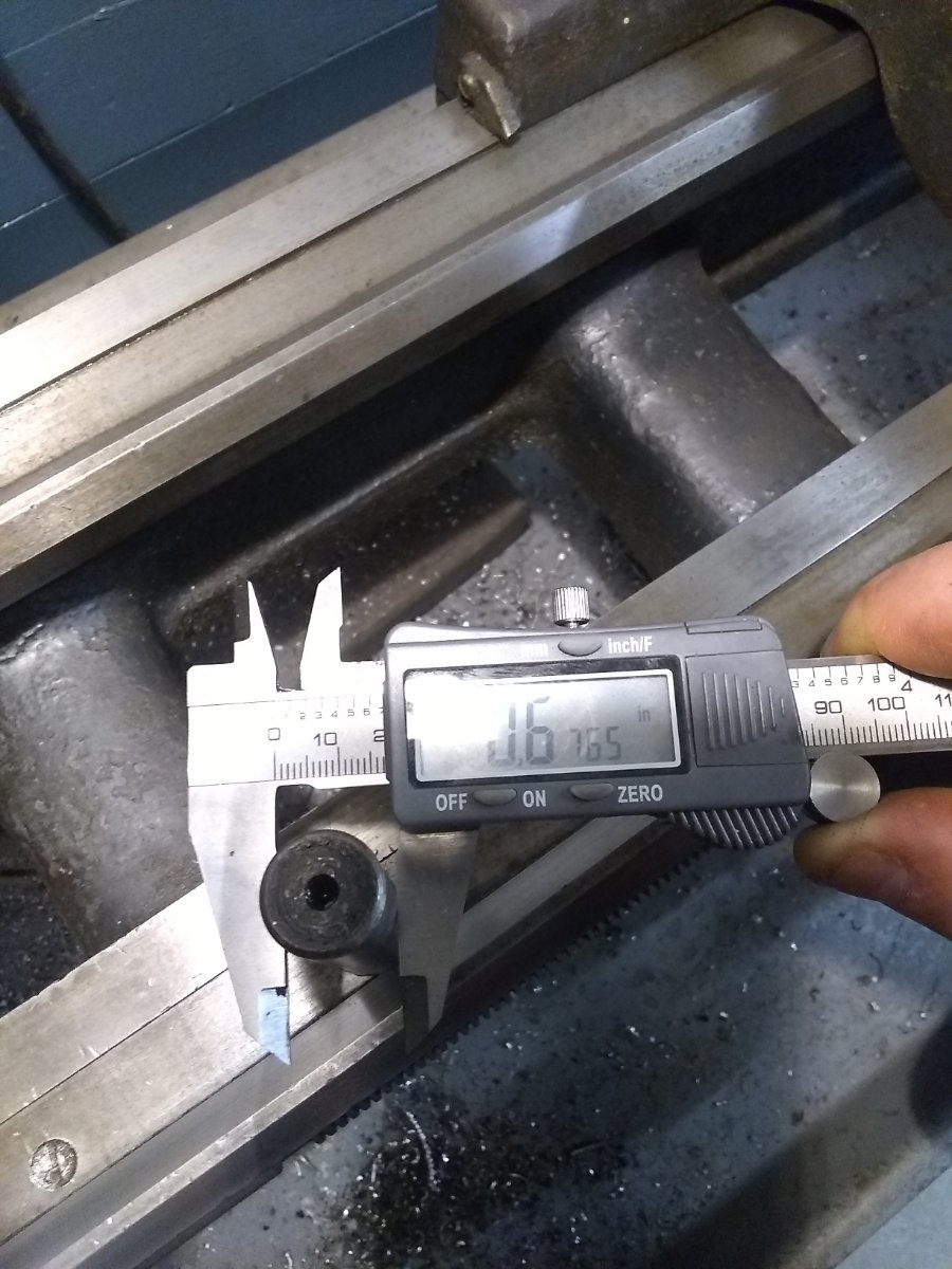

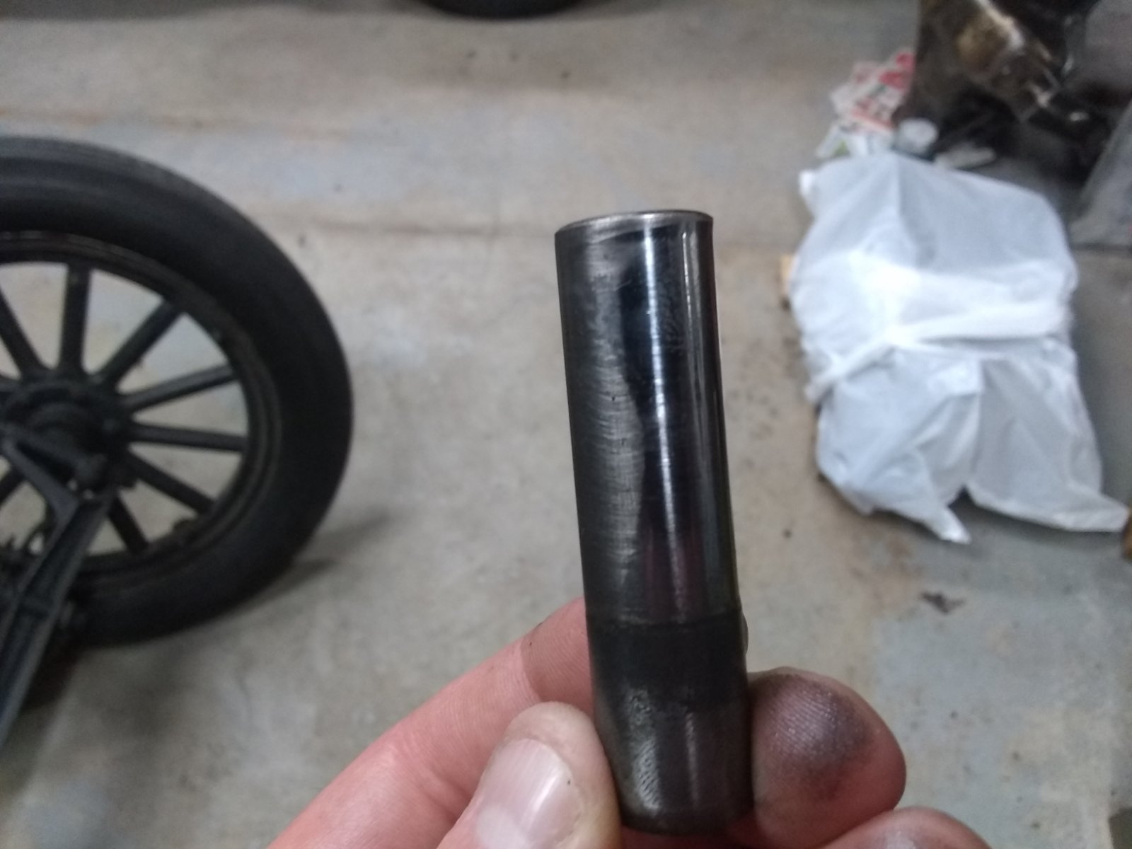

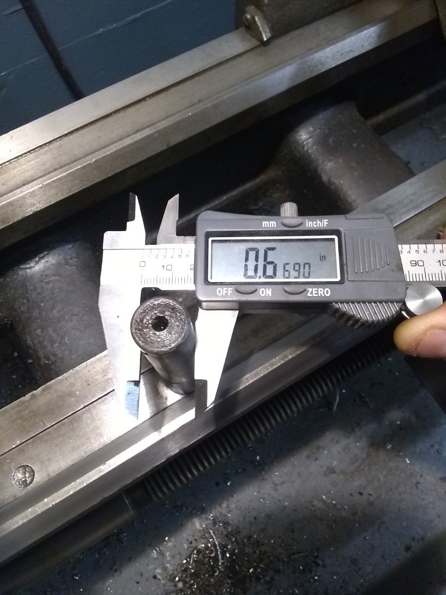

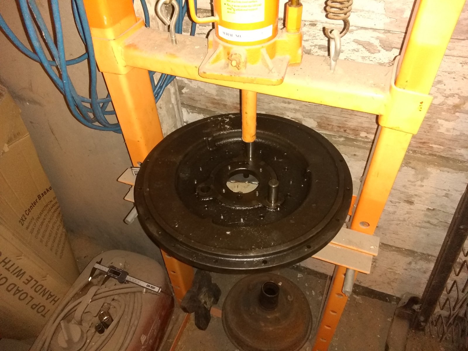

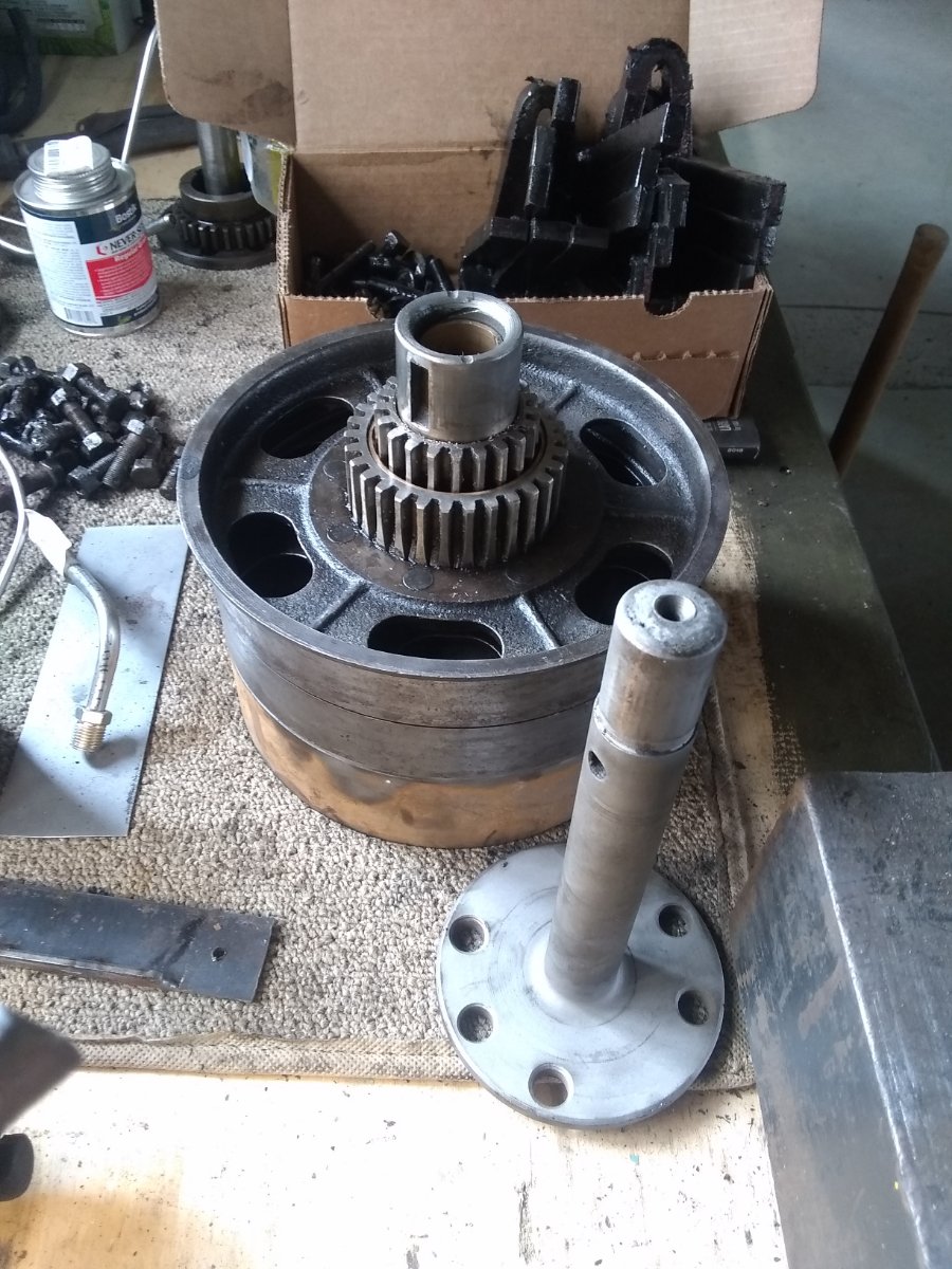

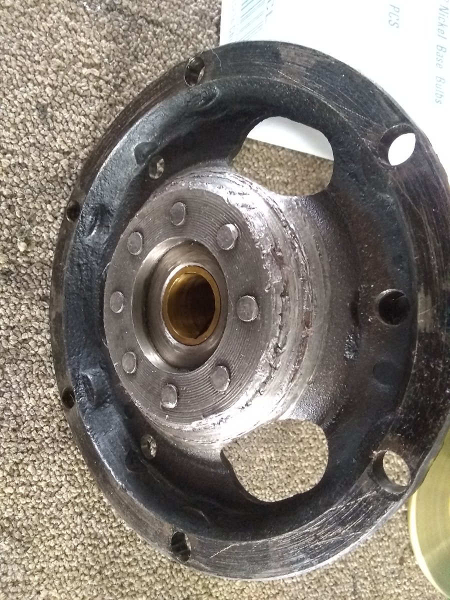

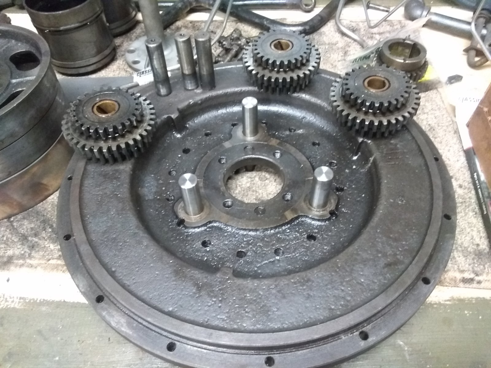

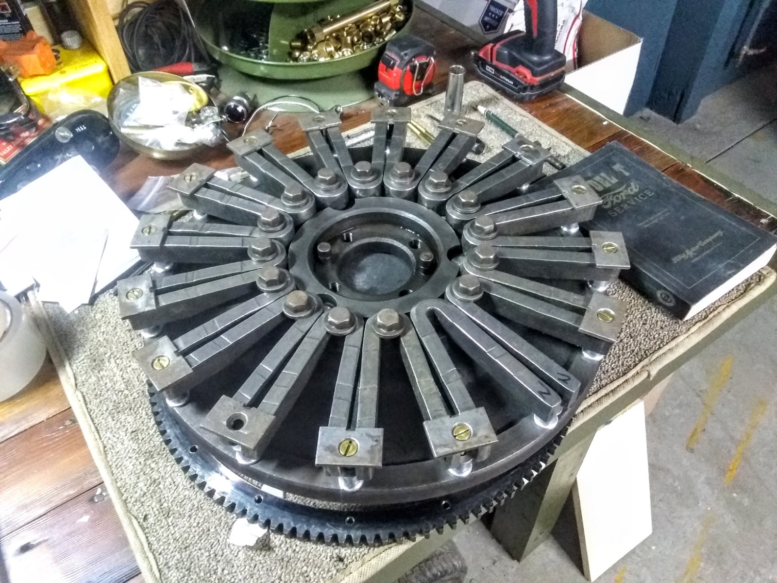

Post by Barth_Tool_Co » Fri Apr 19, 2019 12:12 am
Whoever said "nothing good happens after midnight" is wrong... Just finished putting new gear pins in my flywheel and it couldn't have gone better!
They had some wear on them and we're pretty out of round so after consideration I decided to replace them and leave the bushings in the triple gears alone.
Toughest part was putting together a support for the flywheel around the pin when driving them out. A light coat of grease and the new ones drove home well.
The gears have a much better fit on the new pins than the old.
1926 Touring - "Corrina"
Post by RustyFords » Fri Apr 19, 2019 8:09 am
Nice. You're going to have a tight little engine when it's all said and done. Sweating the details makes all the difference.

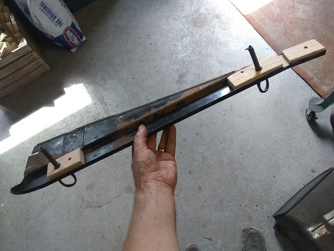

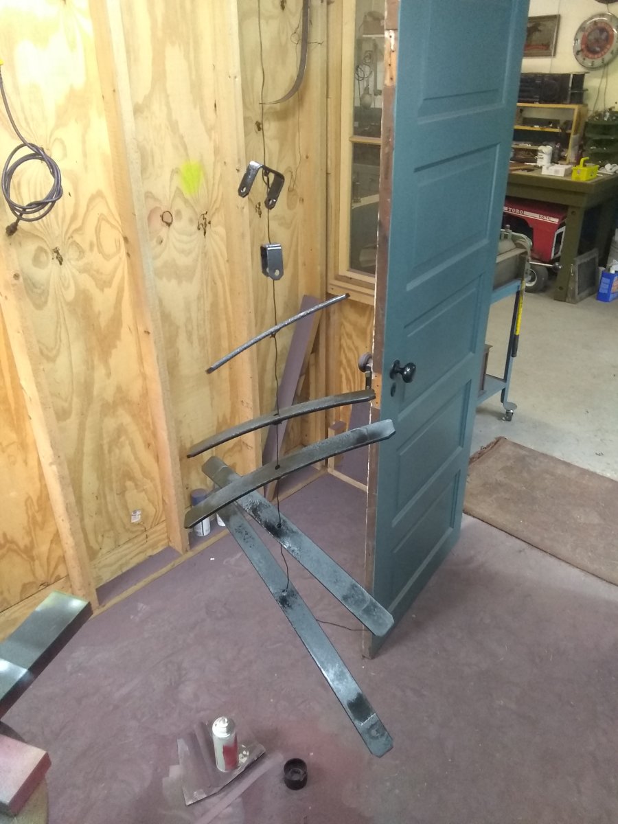

Post by Barth_Tool_Co » Sun Jun 16, 2019 5:44 pm

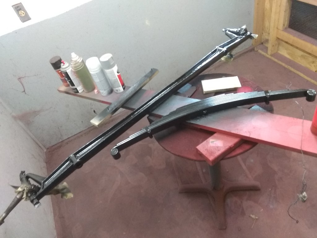

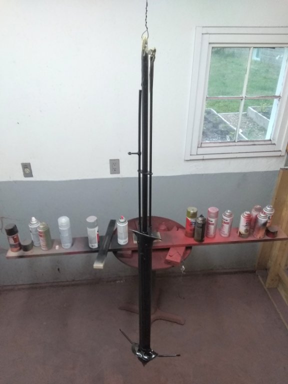

Slow going but I am working on the front springs... House remodel and the falcon getting in the way, looking forward to getting lots done on the 4th holiday in a few weeks! I did get the front end pulled apart for a total rebuild, it needs it!

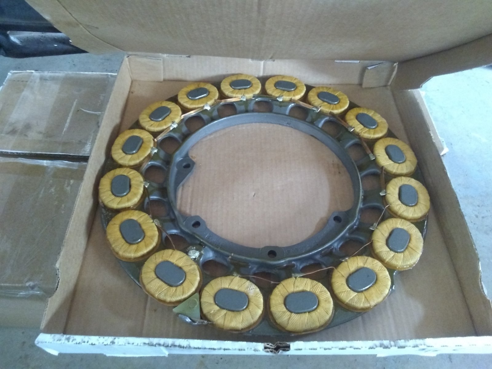

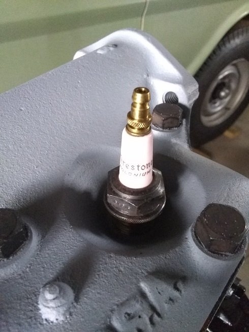

Post by Barth_Tool_Co » Sat Feb 22, 2020 8:08 pm
I had some time today and cleaned and painted the spindles as well as pressed in the new bushings. I'll take them to the machine shop soon for reaming to the spindles along with the head for a shave and the flywheel when its complete for balancing.
I spent the afternoon cleaning the old magnets for to send back and laying out the new charged ones. I ran into an issue with some of the original magnet hardware being damaged or pitted badly so I need to find some original replacements. I also ran into an issue with the starter ring gear, a few of the threaded holes had a bur or something and caused the brass screws to go in harder then I like so i'll have to pick up a #14-24 tap to clean them up.
Sunny and 40 in Michigan... feels like spring after the last week of near zero temp at night.
Post by Norman Kling » Sat Feb 22, 2020 9:06 pm
You started with more than I did! You have a beautiful car and it will also run very well too after you get it done. I hope you will have a good time driving it in the future. Here is a picture of mine the day I bought it and 10 years later when it was finished. you are doing a good job. Interestingly, you are fixing a lot of things which could have been replaced with aftermarket parts being sold by the vendors.
26 touring as purchased.jpg (61.04 KiB) Viewed 34411 times

Post by Barth_Tool_Co » Sat Feb 22, 2020 11:05 pm
Norm26
Great looking touring! Lots of work to turn a pile of parts into a car, I admire your dedication!
Thank you for the kind words!
Over the years restoring different cars I sometimes find restoration parts can be not so good or have the wrong finish. I prefer to rebuild original parts when I can, just my personal preference.

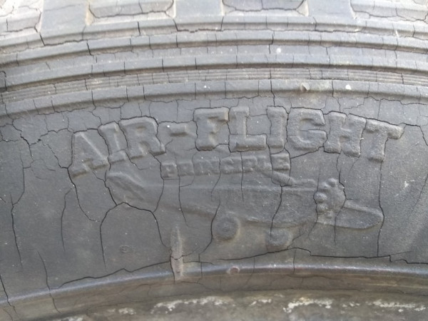

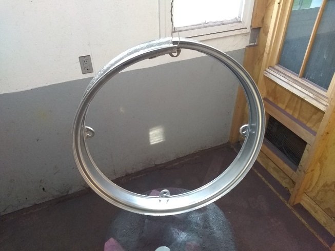

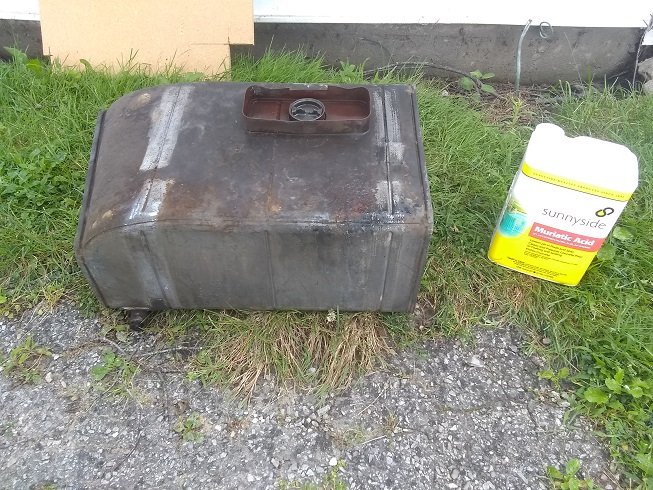

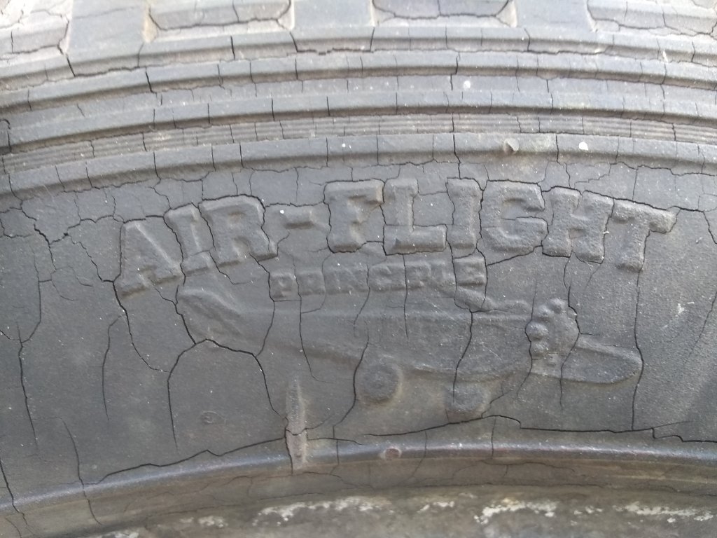

Post by Barth_Tool_Co » Fri Jun 04, 2021 10:42 pm

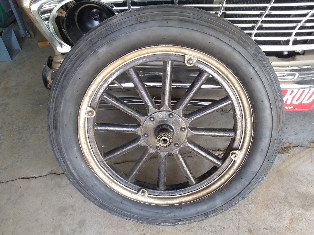

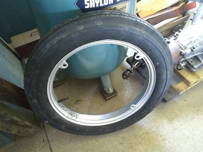

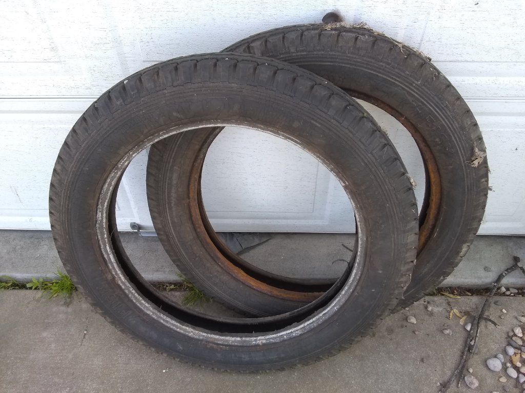

Swapped out the old Fisk tires on the rear rims for some new rubber and moved them to the front wheels. The front rims are pretty bad so I'll need to replace them eventually...
The old Fisk tires are pretty neat, they have this cool logo...
Amazingly, the insides of the Fisk tires look new and the tubes were in good shape, I doubt they would have lasted any length of time though.

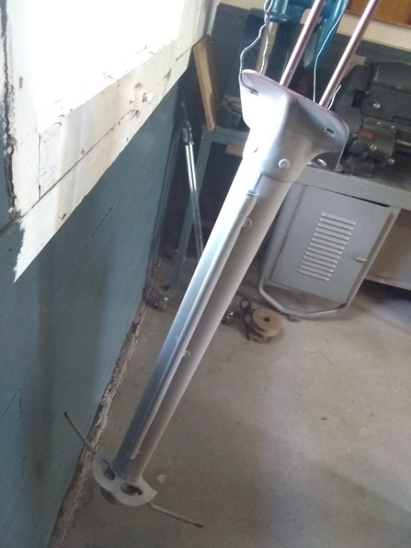

Post by Barth_Tool_Co » Fri Jun 04, 2021 10:44 pm

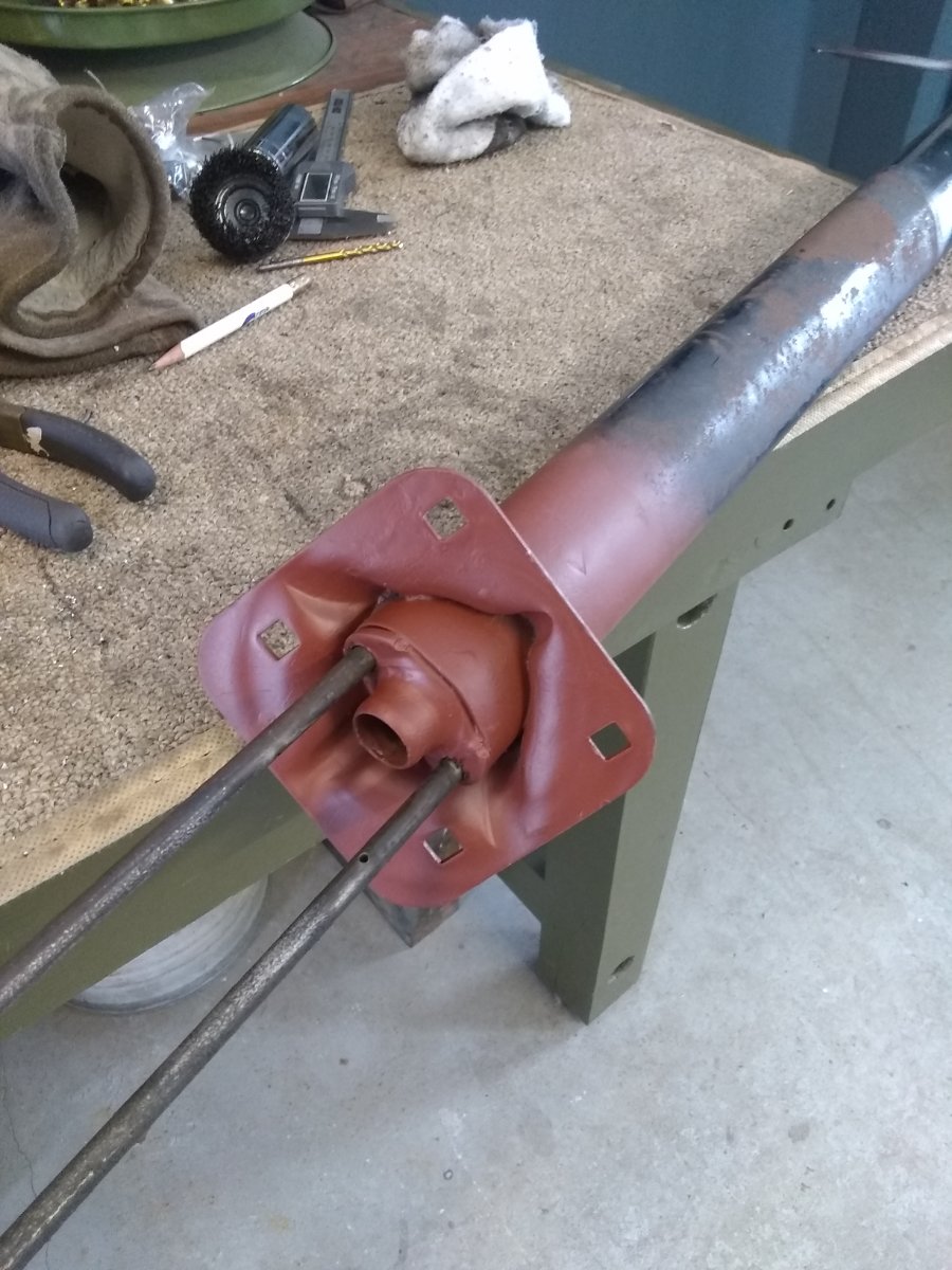

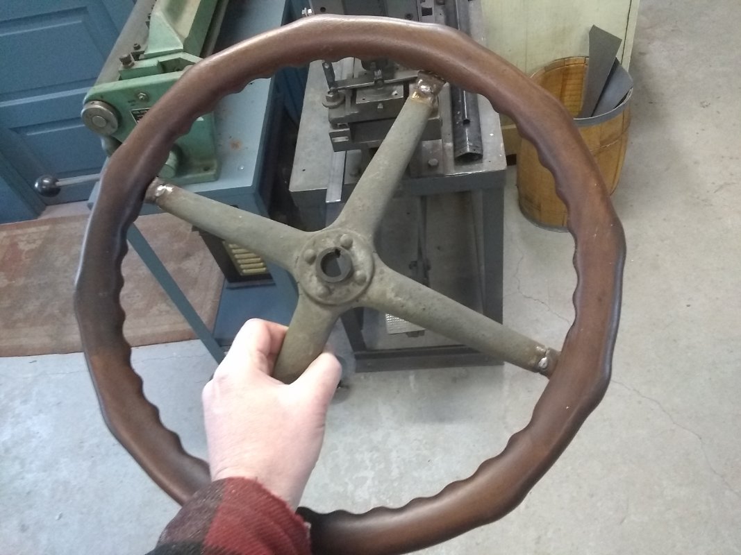

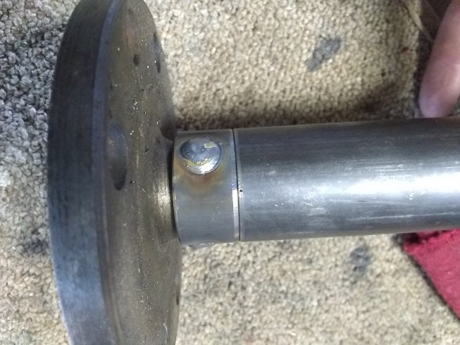

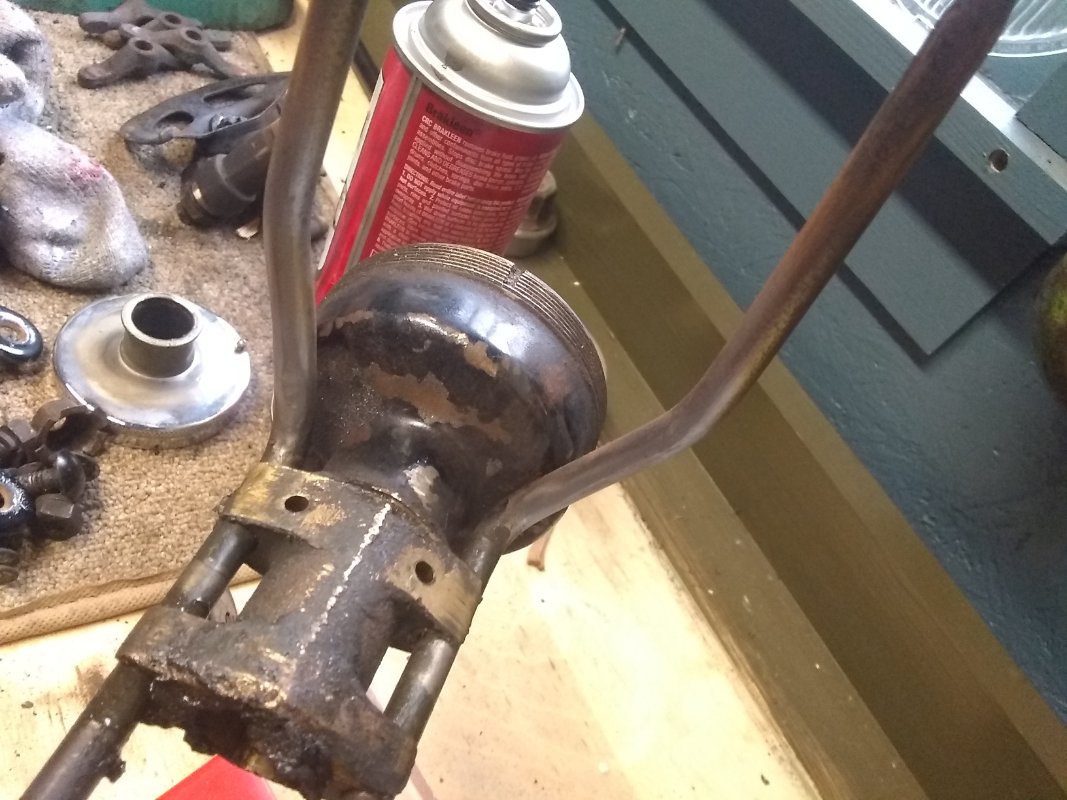

Work on the steering column has continued at a slow pace, I finally finished filling in the pitting and got it in the paint booth tonight...

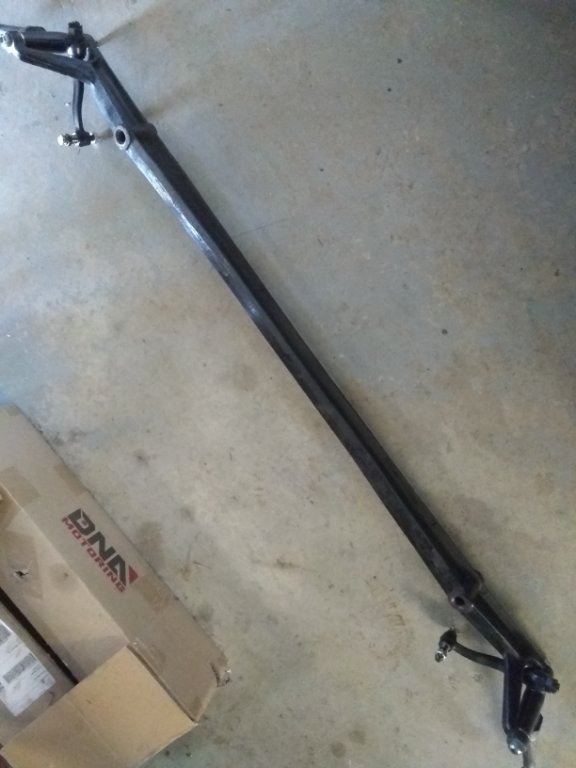

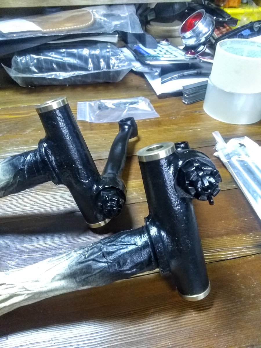

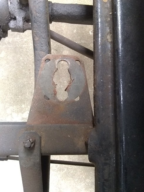

Post by Barth_Tool_Co » Fri Jun 04, 2021 10:53 pm

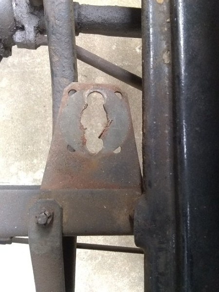

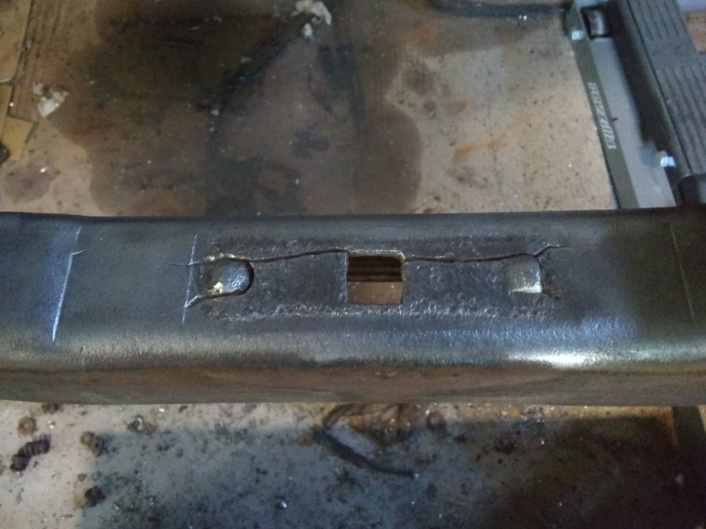

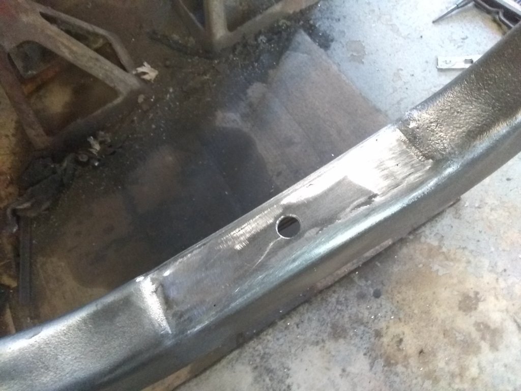

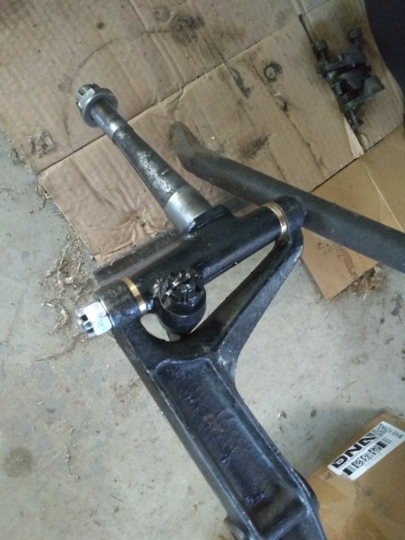

I was able to get my axle kingpins fixed by a local T guy recently also. The front axle was also bent so he straightened it and it's back in business.
I stripped the front of the frame today in preparation for cleaning and painting. Front cross member has a crack where the spring clamp/motor mount sits so that will have to be welded. I did decide against using the original spring I sand blasted. It was pretty crusty so I got a new one from Lang's, looks good. If all goes well the T will be back on all 4 wheels Sunday night.

Post by varmint » Sat Jun 05, 2021 8:50 am
I likes what I see.
Our T has a slime green engine also and we went back to the slime green using green rebar corrosion prevention paint. Paint yours any color you like.

Post by TXGOAT2 » Sat Jun 05, 2021 9:19 am
Re: Fisk Air Flight Principle tires: The airplane in the logo looks a lot like the one flown by Charles Lindbergh in his historic 1927 transatlantic flight . From the New York Times, 1929: COMPANY PRODUCES NEW AUTO TIRE; Head of Fisk Company Describes It as "Air-Flight Principle."
Barth_Tool_Co
Posts: 132
First Name: Jason
Last Name: Alvord
Post by Barth_Tool_Co » Sat Jun 05, 2021 9:41 am
It does at that, I'm going to keep them and use them as a display outside my garage...
Post by Barth_Tool_Co » Sat Jun 05, 2021 11:14 pm
Busy day today... Repaired the cracked front cross member. Initially I just welded the cracks but this didn't work very well so I cut the bad part out and welded a new section in.
I removed the old paint from the front axle and repainted it along with a bunch of front end parts...
Also cleaned and painted the front of the frame...
Post by Barth_Tool_Co » Sun Jun 06, 2021 6:51 pm
It's on 4 wheels again!
Now I need to clean the garage!

Post by Barth_Tool_Co » Sun Jun 06, 2021 6:54 pm
Corrina hasn't been dusted or seen the sun since she was pushed into the garage a few years ago. Looking much better after a wipe down.

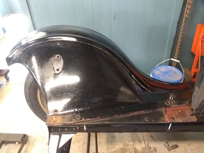

Post by Barth_Tool_Co » Sat Aug 28, 2021 6:01 pm
Got some more time to monkey with the T this AM so I went at it with gusto...
I got the hood shelves cleaned up (amazing how much dried grease and dirt is coagulated on the underside of the tins). I ordered a few things that showed up this week, including some new wood for the hood shelves to replace the rotten originals.
I sanded off the markings on the bolt heads, gave them a quick sand blast for some teeth and painted them in krylon lacquer.
The fenders and shelves went back on today once the bolts were dry...

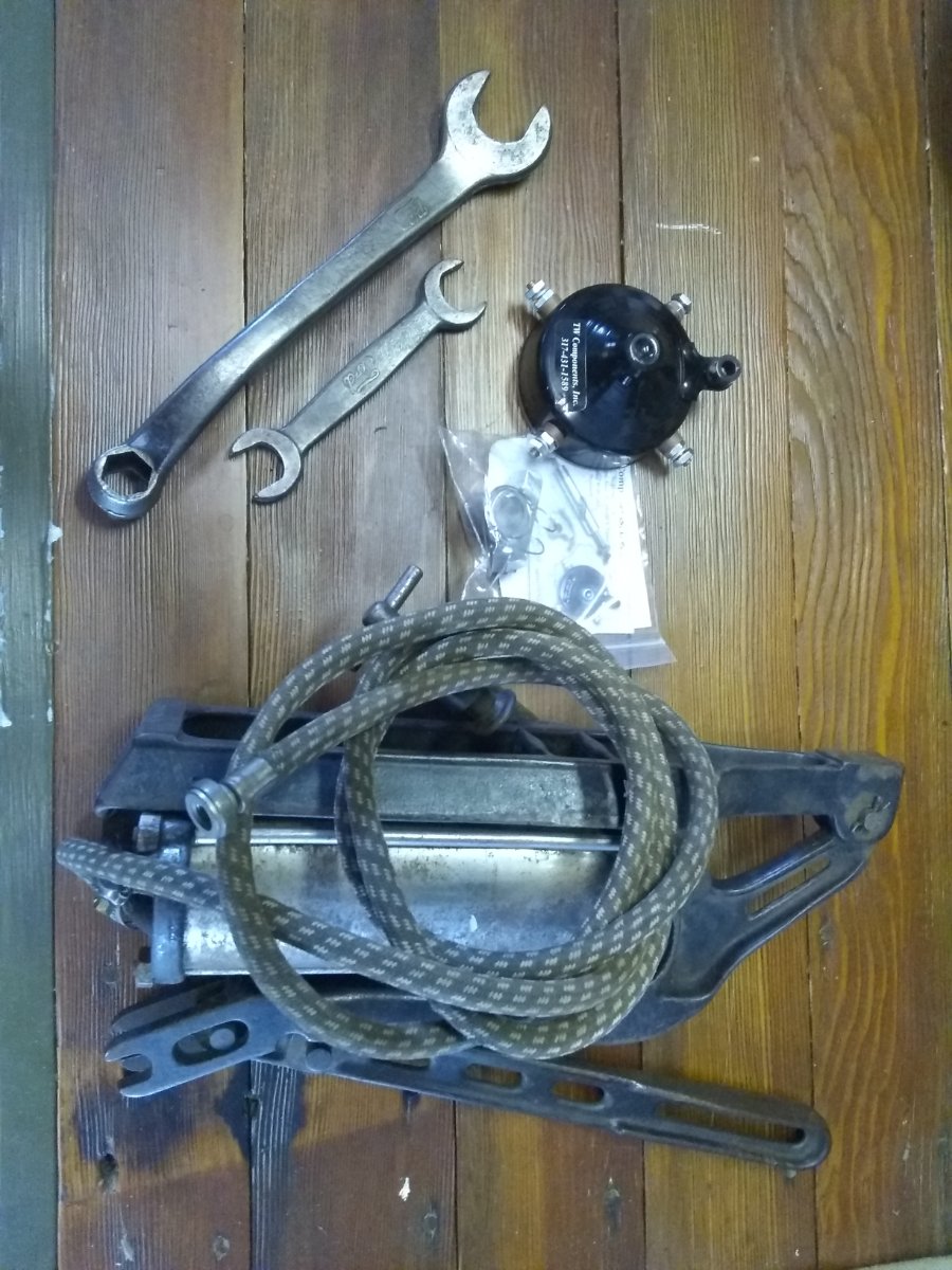

Post by Barth_Tool_Co » Sat Aug 28, 2021 6:13 pm
All through the refurb I've been snagging good NOS repro parts, I've found quite a few goodies that I need. I installed the terminal block without any fuss.
I also got the lacing on the radiator shell in.
I popped the shell on the frame to take a look, been a while since Corina has had a snout... you take things apart and forget how cool they look!
I pulled the fuel tank in preparation for cleaning and sealing. It was a fight to get it out but I won. I didn't have to pull the dash or steering column so that was nice! The tank looks to be in very good condition, I'm sealing another tank early this week and figured I might as well do this one at the same time.
Lots of projects going on right now so the garage is a disaster, I'm going to be hitting things hard in the coming weeks to get the madness under control and clear up some space!

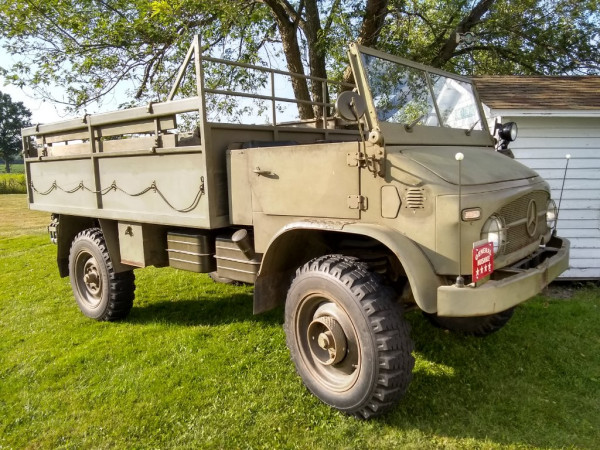

I like your 404! Is it a Swiss model? It's hard to tell without the top.
Barth_Tool_Co
Posts: 132
First Name: Jason
Last Name: Alvord
Post by Barth_Tool_Co » Sun Aug 29, 2021 8:08 am
Scott C. wrote:
Sun Aug 29, 2021 1:30 am
Yup, Swiss army. I picked it up during the height of the pandemic and have been sorting it since. Lots of issues just like my T, I'm a sucker for the hard luck cases I guess!

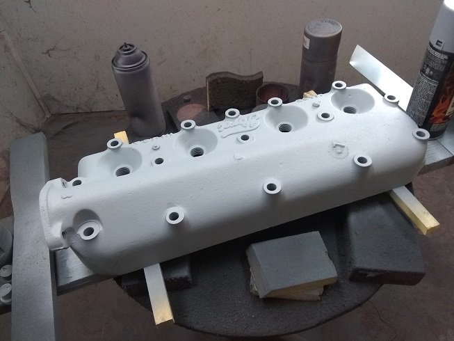

Post by Barth_Tool_Co » Sun Sep 05, 2021 11:46 pm
I sneaked the head into my blasting cabinet a few days ago when doing some other blasting...
Followed by a cleaning and some high temp primer...
Followed by lightly oiling the combustion chambers to keep rust at bay until I get the rest of it together, then I installed the head gasket. This is where things got a bit confusing... The instructions said to put the side that said "This Side Up" facing up and that the gasket GN logo would be on the backside facing the block. The only problem is they are both on the same side...
After some test fitting I was reassured by the front and rear water passage sizes that despite the logo on the same side as the "This Side Up" mark that side did indeed go up. I double checked the length of the new head bolts and installed them loosely by hand.
I torqued to 45ftlb in stages and then a few more times after the gasket compressed until it stayed at 45ftlb.
Last edited by Barth_Tool_Co on Sun Sep 05, 2021 11:50 pm, edited 1 time in total.

I installed some "Radioactive" spark plugs to keep the mice out of the cylinders and poison/mutate them slowly while they make a hasty retreat from the power of the atom. The block will be scuffed and painted green when the rest of the engine is assembled and ready to install.

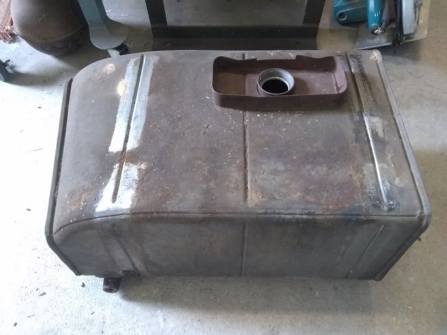

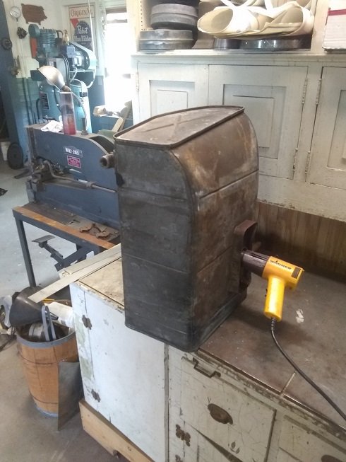

Post by Barth_Tool_Co » Wed Sep 08, 2021 10:24 pm
I got the fuel tank sealed tonight with POR15 tank sealer, interesting process as I've used the stuff before. I cleaned out the tank and gave it a Muriatic acid wash followed by a bunch of rinsing.
After the initial clean and rinse I went to the POR-15 metal prep step where the tank is kept wet with the prep solution for 20 minutes then drained, rinsed and dried. The POR stuff needs the tank insides to be bone dry so I set up my heat gun on low and got it ready to go.
Application was easy, I plugged the filler and outlet after emptying the POR15 into the tank and commenced rolling the tank 'round for 10 minutes.
After letting the tank drain for the required time I set the tank at an angle and used q-tips to clean the threads on the filler and outlet just in case, I didn't want any of this stuff gumming up the threads when cured.
Now we wait for it to cure in 4 days... I used about 1/3 of a pint to do the tank, most of it came back out, I was surprised at how much I didn't use. I'm waiting on an order from Lang's for the parts to reinstall the tank but they should be here early next week.
Post by Barth_Tool_Co » Mon Oct 25, 2021 9:23 pm
I spent Sunday moving things around in the garage prepping for winter, got the T engine into the heated part and ready for more work. While I had the T pushed out of the garage I climbed into the engine bay and pulled out the last of the worn out wiring harness. They really did a number on the starter button mounting plate, good thing it's getting replaced! This wiring is done for.

Post by Barth_Tool_Co » Sun May 15, 2022 9:31 pm
Got myself a new rim to replace the horribly bent one currently on the rear driver's side... I blasted and painted this one so at some point I'll have to pull the tires off the front rims and blast/paint those so they match! Installing the tire was no problem with the rim spreader handy.

Post by Barth_Tool_Co » Sun May 15, 2022 9:37 pm
I built up a magnet height tool to help me get all the heights right. I started with a piece of steel tubing and parted off a bit to act as a stop.
I then drilled 3 holes in it to weld it to the shaft.
I made the arm out of some scrap steel I had lying around and welded it up.
Once fabrication was done I was able to test it out. The micrometer easily installs with a set screw.

Mopar_man
Posts: 1192
Last Name: Govoni
Location: Fredericksburg, VA
Post by Mopar_man » Mon May 16, 2022 1:36 pm
That's a cool tool you built. I think I lifted the flywheel on and off the engine 50 times before I got the shims right. But when you get them right you get lot's of power.
