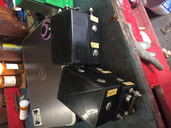

Plastic coils
Is there any use for these before I part them out? I figure I can at least get the hardware and tar.

I checked them with an ECCT, all caps are bad. I’ll give replacement a shot.
