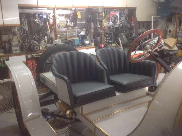

Hello Mack,
I can attest to Hank's remarks re: upholstery. I have attached a few photos of the seats he did for my speedster earlier this year. My seat was a bit different than yours as it is built out of wood and the back is sheathed in steel. The finish material will be installed within the next couple of months.
Good luck with your project.....looks like it has good "bones".
Best
Dave

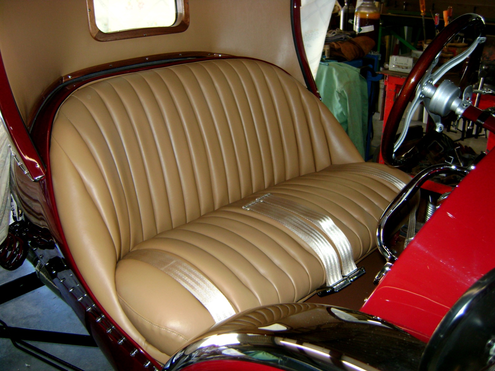

by Henry K. Lee
Mack your love seat design of course would require extra support and the likes of. They are more comfortable in a speedster in my opinion since in todays times people are of a larger frame so to say. Here are you some ideas. I do like making or installing adjustable seat tracks as your never know when it comes time to sell. Not fitting the next person can be a real deal breaker. Just things to consider.
Hope this Helps,
